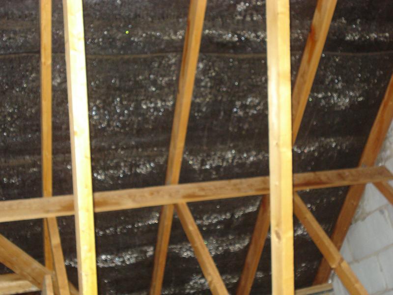

okay I moved into my first house about 2 years ago now, and the house is a small 2 bedroom semi detached 11 years old, last winter when I went into the loft I noticed water droplets all over the loft roof and didn't really think anything off it and I'm sure I went up in the summer there was no issue, when going back up for winter again there are a lot of water droplets covering the whole loft roof lining and obvious thats it's dripping off onto the stuff in the loft, why is this?? I'm guessing it shouldn't be this way,

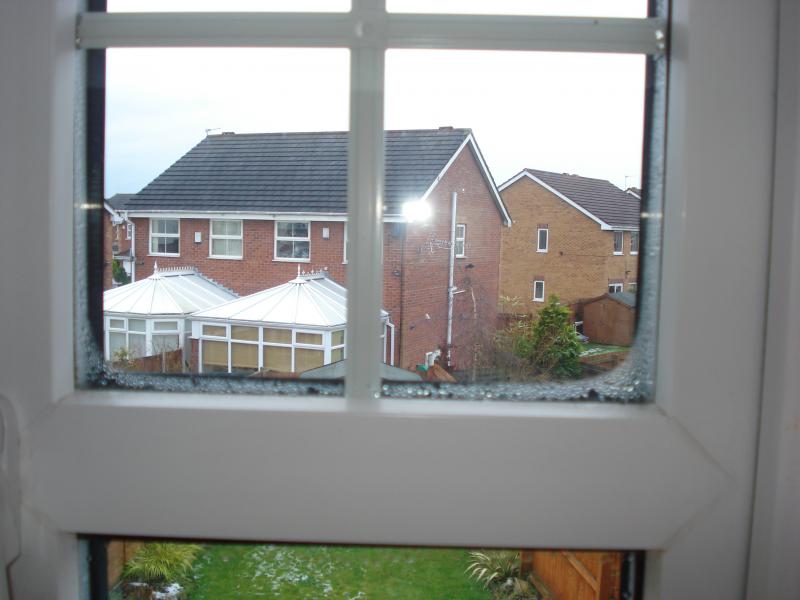

The windows in the house around winter time again get few droplets of water around the bottom of the window pane nothing major but obvious

window condensation is pretty common.i either put up with it or leave the window on night vent.
your roof timbers look wet? you should have air flow in your loft, you need to make sure your insulation is not blocking this flow at the eaves. open all your window vents and make sure you get the extractor fan going to help reduce condensation, if you must dry washing indoors open the windows a little.
Mrs is home in a few hours so she can look after the daughter then im gonna go into the loft and take a look and check ventilation, i thought the same about the roof timbers when i looked at the picture again so ill check.
okay ive been into the loft the roof timbers do look wet in the pics but it doesnt seem that bad when i had a look they are slightly wet were there touching the roof felt as i would expect with all the condensation on the felt.

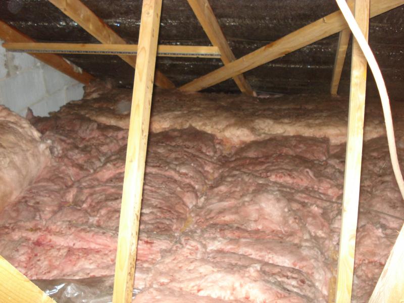

also into there corners the insulation is paked in, i dont know if this is ment to be here or is just restricting all the air flow, pics are below.

now in the very corners there is small peices of insulation stuffed in. is it mean to be like this, in this pic you can see the middle one i have removed.

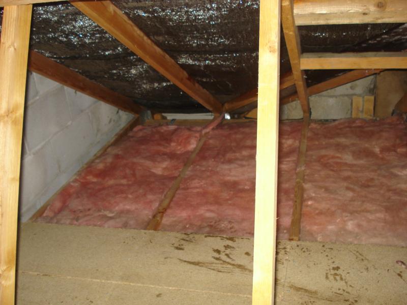

So on one side of the loft i have removed the double layer and removed the insulation in the very corners, is this how it is meant to be? i could feel a diffrence in the air circulation, or have i made things worse? pic below
those black plastic things at bottom of the roof are there to let the air move freely into the roof.looks like they may have been blocked before you removed some of the insulation.you can insulate up to them but make sure the holes are free.
try that for a few days and check what happens,if it doesnt clear the droplets completely you can try fitting a few vent tiles near the top of the roof.

2 layers of insulation is fine but when the trays were fitted the norm was a single thickness and this covering of the vents is very common when the 2nd layer is fitted,especially if done by a home owner that wouldnt know/think of the consequences.
I went up before, some of the insulation was covering the crossflow ventilator (Plastic things :p ) at the top and even some were blocked at the bottom as some had been rammed that far down it went into the eaves touching the soffit vent. not all though, some were okay, one had that much forced down it it had split one of the crossflow ventilators, im hopeing now this will inprove things or ill think about the vent tiles. thanks for your input! hope my terminology has improved :p
