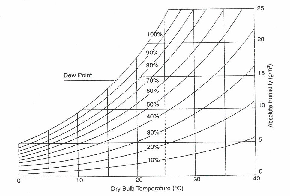

So can you explain why warm air hitting cold air seems to release water if in actual fact its removing the water...and then where does the water go..I'm confused now
So my Amazon sensors that show temp and humidity don't actually provide any benefit in helping me tackle condensation because they don't measure the right kind of humidity? What is the right kind of humidity to measure and how do I do that?
Right now, an outdoor sensor is showing 6.7 degrees and 96% humidity...what does that actually mean then or does it not mean anything?
Help appreciated on this, I've been getting this wrong for years..I feel so stupid now
You could see water condensing from the warm air when it hits the cold air - same way a cold window fogs up when you breathe on it.
See attached chart.
99% relative humidity at 5 degrees would be barely 40% relative humidity at 20 degrees.
It's the same amount of water in the air by volume, but warm air can hold more of it before it condenses.
This is why it's hard to prevent condensation forming on a very cold surface - such as a single-glazed window. If the window pane is (say) a 5 degree surface, you'd need to reduce the interior humidity below 40% if the interior air temperature were 20 degrees - which is quite difficult.
Here's a dew point calculator:
