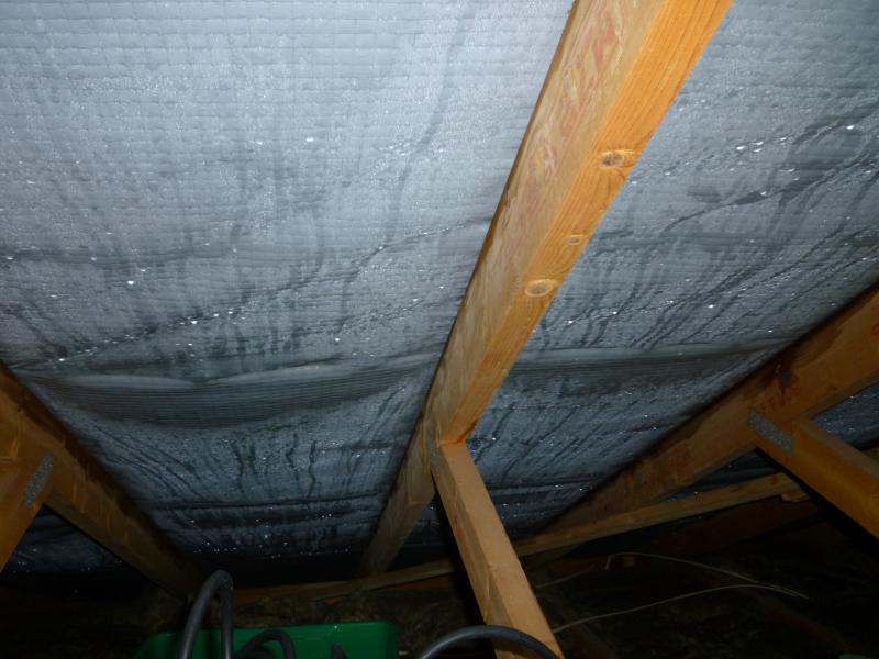

Hi
I have read other posts but just wanted to double check.
As you can see there is alot of condensation and it leaves the ceiling above the windows mouldy.
There is no moisture rising up from the rooms below, there are two vents on the roof, water tank is covered etc.

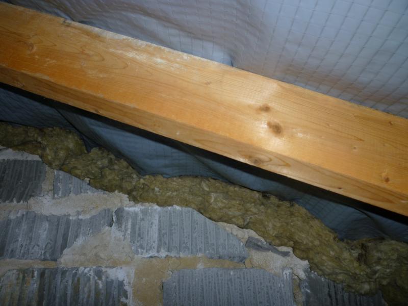

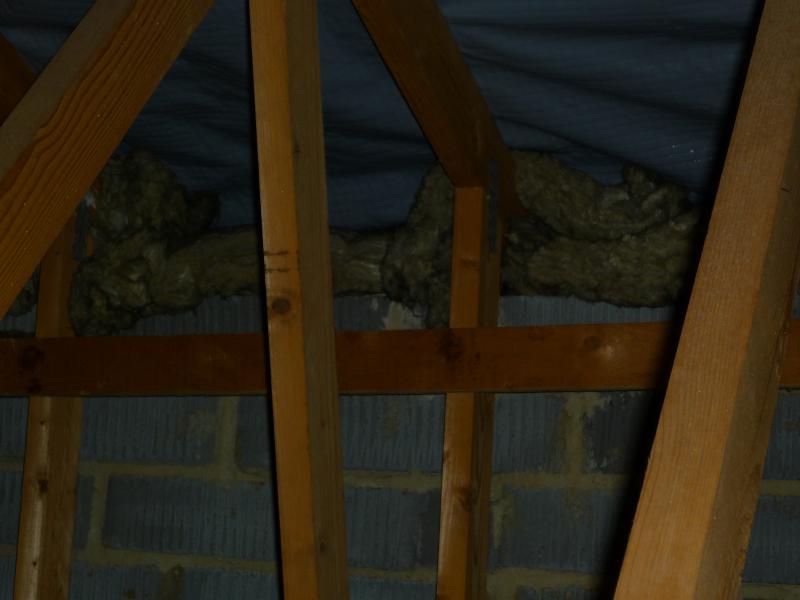

The only reason I can think that is causing the moisture is too much insulation.
Is there supposed to be insulation between the wall and roof?
(insulation is always damp and it is not an external wall)
many thanks
we dont dry clothes in flat
there is an extracter fan in the bathroom ( although the bathroom has no windows and the duct is about 6 metres )
there are no leaks in roof or holes in ceiling etc
But is there a vapour barrier on the loft side of the ceiling and underneath any existing insulation ?
start by pulling out that insulation in pics 2 and 3
With luck you will get a nice draught of fresh air blowing through the loft. This remove the damp air and let the loft dry out.
It is OK for lofts to be cold and draughty above the ceiling insulation. Lofts are not heated spaces.
Also pull away some of the insulation at the edges, it is usual to have ventilation at the eaves, but this depends on the design and build of your roof.
As long as the loft insulation covers the plaster of the ceilings below, and overlaps slightly onto the tops of the walls, it is OK. it should not be stuffed into the eaves.
BTW yes, moisture will be rising from the house below. Ceilings and hatches are not airtight. If there is no ventilation of the loft, then the water vapour cannot escape so it forms condensation on the cold surfaces.
