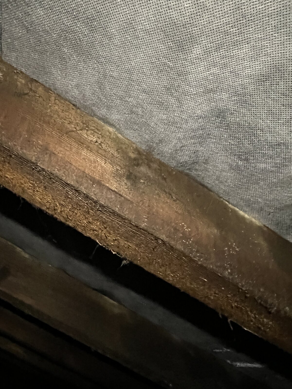

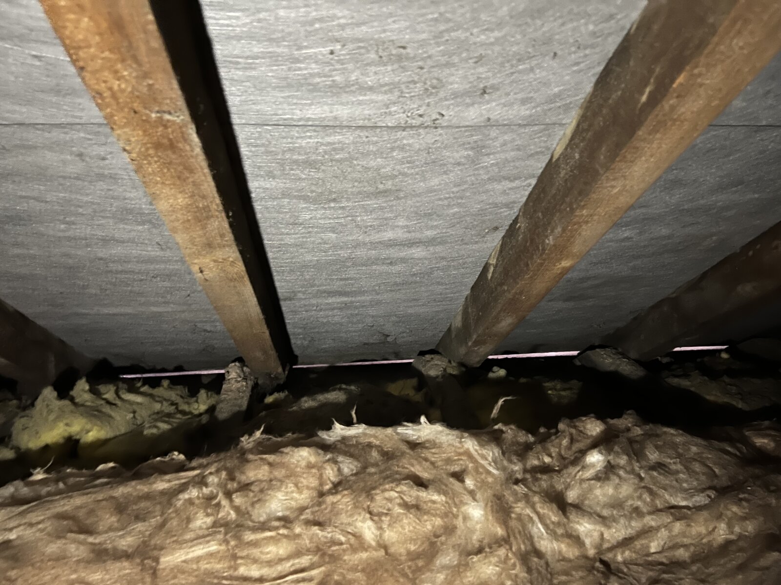

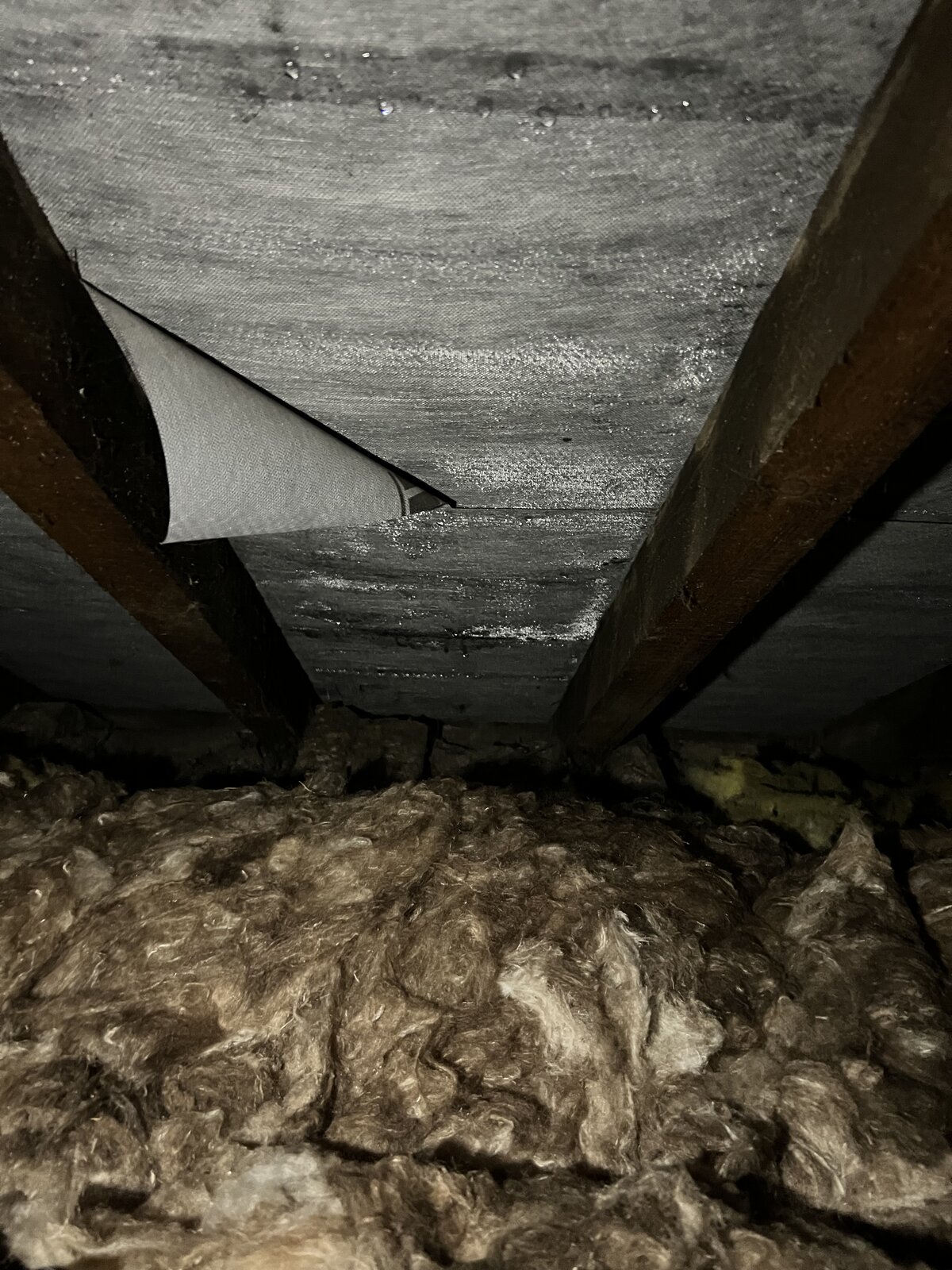

The first two are from the side where there is no gap at the eaves you can see the moisture on the membrane. Hopefully you can tell if that’s breathable or not? Then the last picture is from the other end where there is a gap at the eaves and the membrane is dry, rafters look like they’ve been wet at some point but are dry to touch.
Yes it looks like modern breathable.

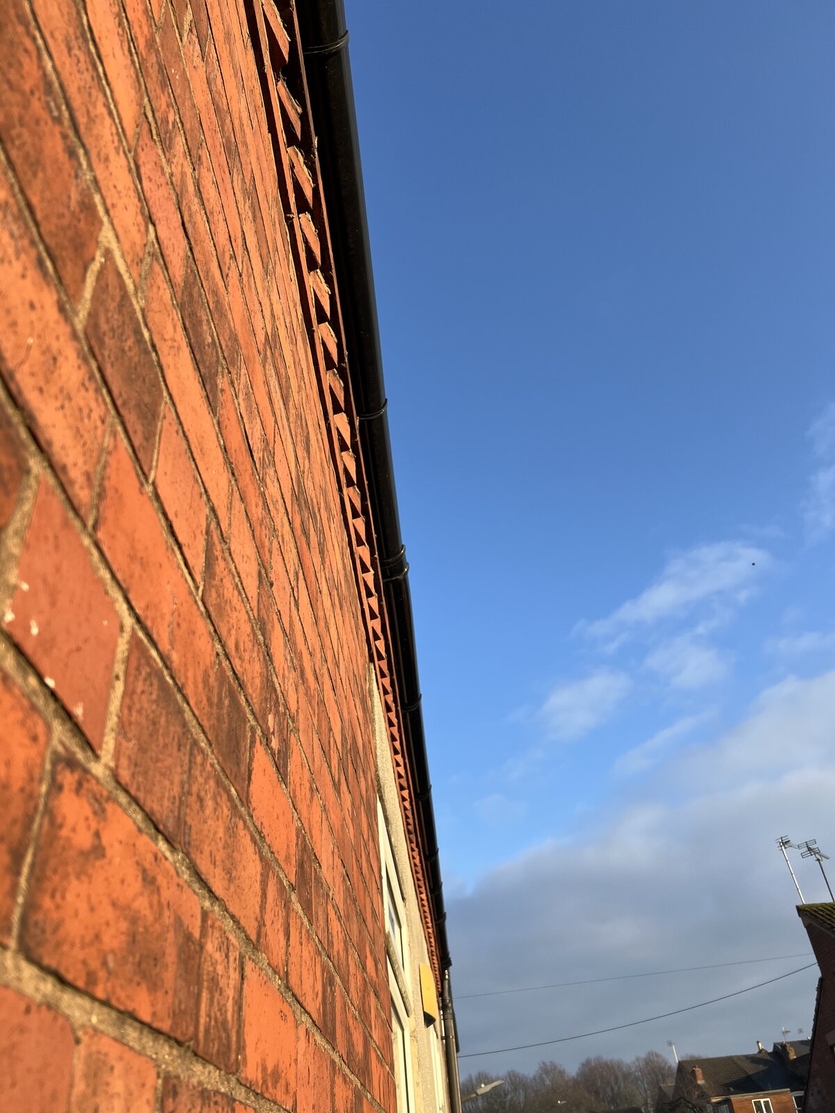

The other eaves pic is very dark. Can you make out why there seems to be no gap?
If there is a soffit board it can be drilled.
I’ve been up on a ladder and there’s no gap at all on the rear of the house the brick meets roof? There are no soffits front or back?
