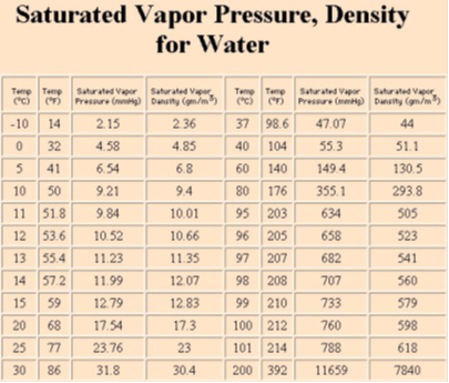

So your house is at 55% humidity at let's say 20 degrees. (ignoring the fact that RH is really a ratio of vapour pressure and not density - the figures are very similar at lower temps) your air is carrying 17.3 x 0.55 g/m3 water vapour = 9.5g. You will see that a saturated vapour density of 9.4 equates to 10 degrees, so this is the dew point below which condensation will occur.
I bet the underside of your roof is a bit colder than that yesterday with all that extra insulation stopping the heat from the house getting to it!!
Assuming you don't have a breathable membrane under the slates/tiles that allow the water vapour out but stops condensation getting back in (that's how a breathable membrane works - it doesn't prevent condensation under the tiles/slates, but it does mitigate against it raining back down), you can try and keep that loft hatch shut and as far as possible prevent warm house air getting in the loft. A dehumidifier will help reduce the relative humidity, but when the roof is close to freezing or below it, you will get condensation.
As soon as the ventilation air is below 100% relative humidity it will start to evaporate the condensation, which is why ventilation is important - the air in contact with the moisture needs to be able to replenish and move away once it has "collected" the surface water. If it can't move, evaporation stops because the local air becomes saturated.

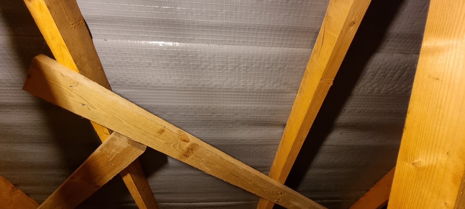

Here is a picture of the membrane that sits in my roof space behind the rafters. I'm not sure what type this is, other than it's not felt, would lap vents be a good way forward here initially rather than venting the soffit?

It doesn't _look_ breathable to me.
Lap vents are quick and easy to fit yourself, so definitely worth trying.
