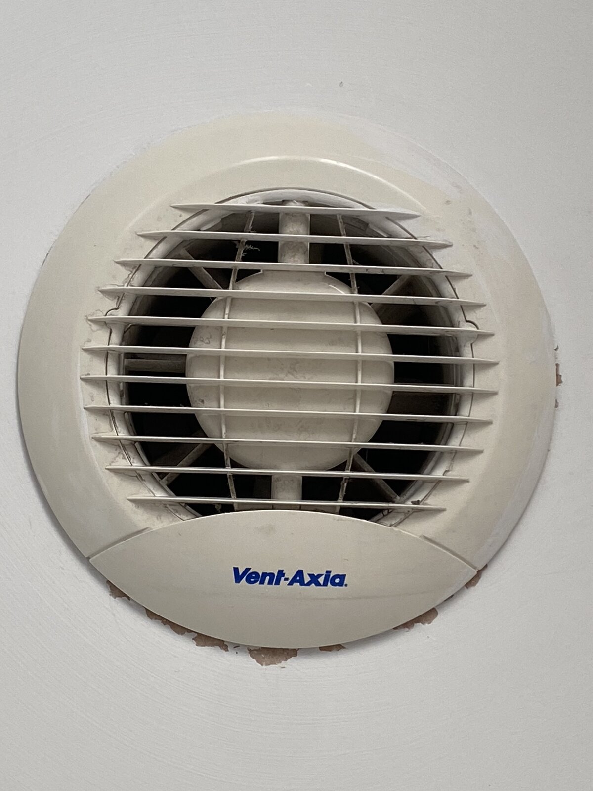

Is this abnormal? It’s a vent-axia unit and it seems to turn on fine.

I’m trying to see if I can get the fan grill off to check if it’s blocked with dust etc will Google it so I don’t break something

While you're up there, please photograph the fan and its markings, and the duct.
A more powerful fan will be available, and the duct might be loose or obstructed.
His long does the fan run on after you turn the light out?
Is it noisy?

Thanks for the reply, yes its fairly noisy. I do think it's highly possible the duct is dusty at least. A clear-out may be a positive step. Likewise if it is possible to easily and not-too-expensively upgrade the fan that is also a possibility. I'll take a better photo and report back. I'm struggling to find a way to remove the grill at the moment!

It sounds like we are on the same page that improving the ventilation may be the best solution alongside the remedial works. Obviously I don't want the issue to recur in a few months if a dust-filled duct is allowing too much moisture to collect in the room. Perhaps either a good duct clear-out, a fan upgrade, or both. I'll try and get a better photo uploaded in the next 24 hours so we can look at that.

If you photograph the grill/vent from all angles, someone may recognise it. Some have push-in tab that projects through a small slot in what would be the bottom if it was on a wall, you push it in with your thumbnail or a medium screwdriver.
Some of the modern extractors with ball-bearing motors and rubber mountings are amazingly quiet, and often more powerful.
Here is a better view of the fan.
