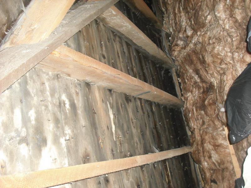

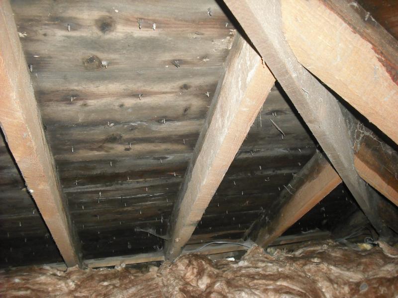

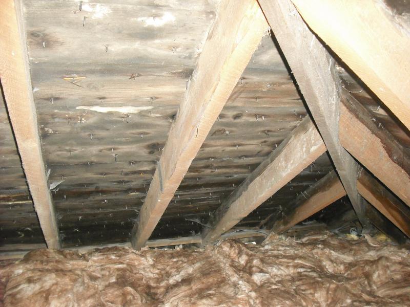

OK I have read all the post on leak v condensation, I have a few roofers out and keep getting different opinions. I have damp sarking boards in one area in my eves, not dripping but moist to the touch, the moist boards even frosted up in the cold weather a week or so back. Question is leak or condensation. Its a slate roof, pretty old about 90 years but been well maintained. Sofits are clear and ventilated with holes every 18 inches or so. The area has very good insulation as you can see from picture so not sure how much if any of house heat is getting in there. I pushed a screwdriver in to a damp sarking board and it seems pretty dry inside. The dilemma I have is its kind of a uniform dampness unlike previous leaks which tended to track down the pitch of the sarking boards north to south or down the joist, this looks more horizontal pattern. No ridge vents buts its cold up there and has a draft.

thanks for the feedback, what i dont get is its such a big area, looking at the 1st picture you can see its about 6 boards up and its across the 3 areas of joists.....Its ok for the boards to be damp then?
It is condensation! I would consider installing vents at high level both front and rear.
And no it's not a good idea to allow the sarkin boards to remain damp for prolonged periods.
Even though it feels cold and airy there still needs to be air circulation to vent properly, you wont get this with vents to eaves with nothing higher up.

thanks, I think I will give that a go, just need to find a roofer to install a couple of vents, my gut feeling is condensation but to say I know nothing about building/roofs is putting it mildly
How many slate vents and how high? I haws thinking 2 slate vents on each side about 1/2 to 3/4 ways up the roof pitch? What do you think, I have a roofer to do it but he wasn't 100% sure...seems to be a bit of a black art
The vents go in as high to the ridge as possible!
Normally 2 or 3 courses down from the ridge.
I would get a roofer who knows how to install them properly as well.
