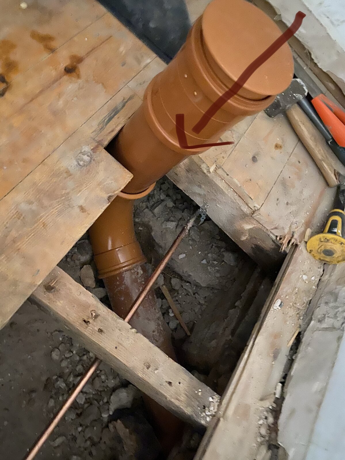

Condense pipe into soil pipe.
8 Sep 2012
825
10
West Midlands
I am doing a refurb and heating engineer is fitting a new boiler in new location. We are thinking where condense pipe should go and route it should take. There is a soil pipe we have fitted under the stairs which is next to the Boiler room. Is it possible to attach onto this? What’s the best way
Your heating guy aught to know ... also what is that copper pipe feeding in your picture ? That strap band is rough
