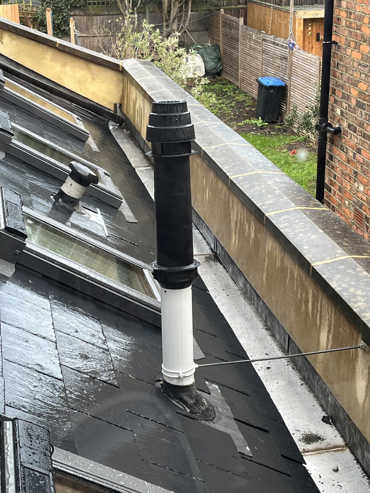

Also the roof flashing, is it proper vaillant product or generic roof flashing.
Is the terminal dedicated item? Should not be white

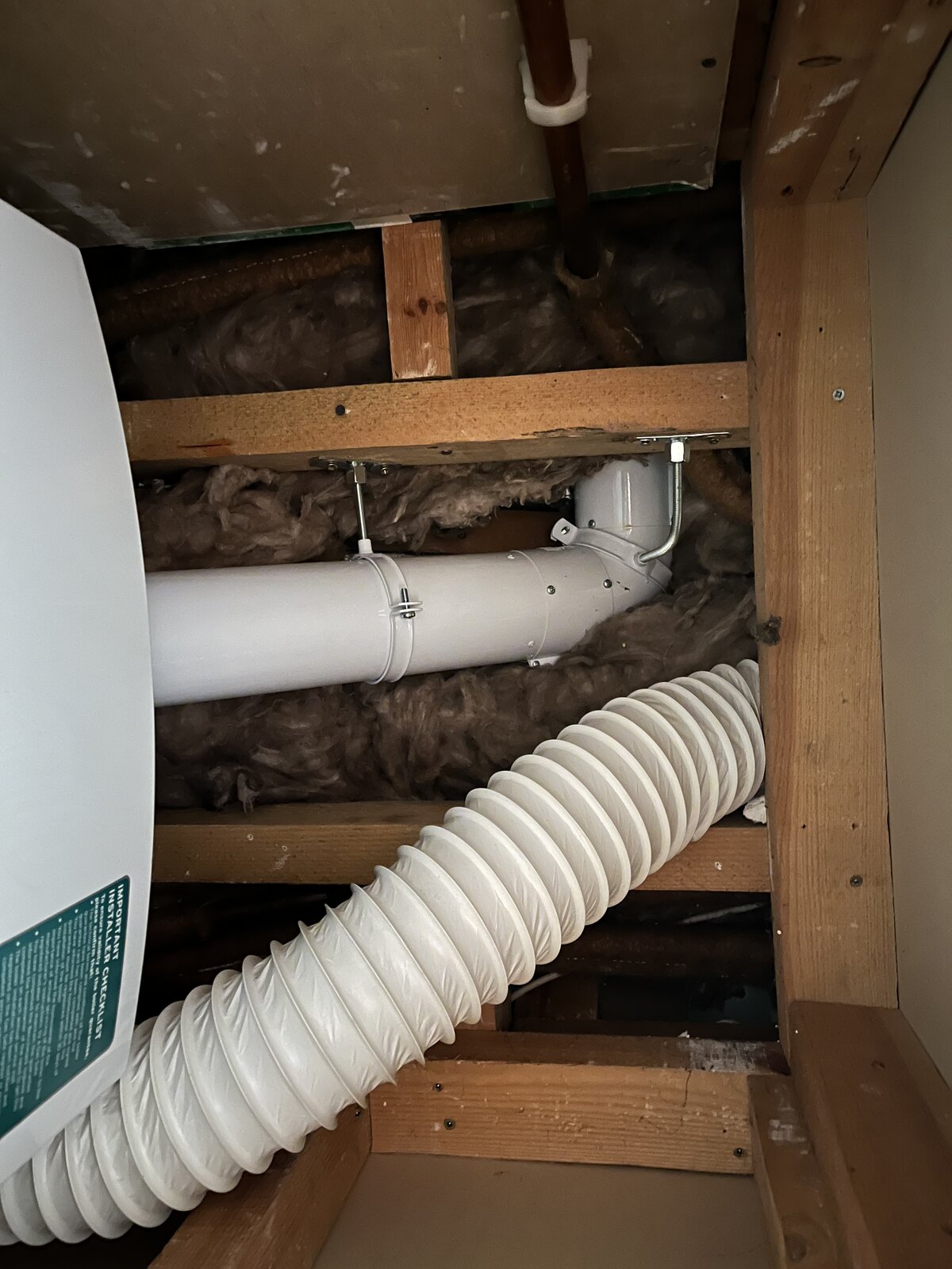

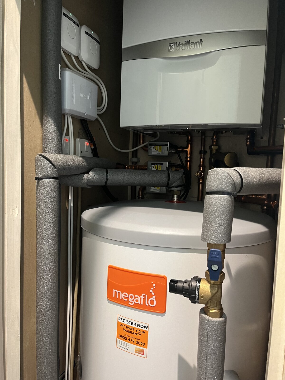

The megaflo sits under the boiler, and it’s just dripping on the cap of it, presumably from the flue above. See some pics here, and thanks for the replies.

I should add that we had the roof over the side extension re-slated and new Veluxes installed, but the problem occurred before and after, so don’t think these works caused the issue. They also put insulation around the flue at that time, so that makes access more difficult unfortunately.

The reason for asking is the boiler's internal spaces should be sealed so no liquid should really be dripping from it at all.
So it's just dripping on to the curved top of the cylinder? If so I'd be placing sheets of blue roll onto the top of it and watching it regularly to see where it's actually dripping from, that would provide a starting point as to where to look first, as water always drips vertically downwards.
Thanks, that I’ve been doing. My suspicion is it runs along the flue and then drips from the joint. There’s no dripping from the boiler itself to be clear, it’s right above the flue joint.

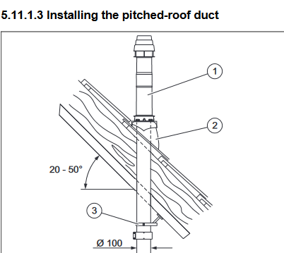

1 No white should be showing outside. Vertical flue needs shortening. RGI job.
2 Generic flashing used.
Would have been better to have used the Vaillant pitched roof "pantile" flashing - the bottom of the black section of the flue overlaps an upward lip on the pantile to make a weatherproof seal.
3 Clearances of the terminal of the shortened flue to the Velux openings and masonry wall would need to be checked.
all depends whether vailllant now allow white showing some manufacturers do
Yes, but I think the issue here is the way the terminal is designed to slot over the flashing.
The adjacent vent with the same flashing is 110mm soil, OD white is 100mm, perhaps a slightly loose fit?
And no "collar" to shed water off the joint.
All assuming, of course, that the OP confirms that this is where the water is tracking in.

those lead slates with rubber collars are not the best but providing the hole has been cut properly they will provide a perfect seal .
The OP has said drip is there regardless of weather so personally i would be taking the flue apart and looking for a faulty inner flue seal which doesnt always show up when using just a FGA to check the flue .
That would be after making sure drip is coming from flue and not the boiler
Happened to me where water ingress was through the rubber
Looks like the terminal has been butchered
