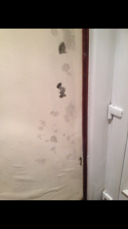

we own an upstairs four in a block flat that was built in the 1950's. the entrance door is on the ground floor with stairs leading up to the accommodation. there is central heating with double glazing and a uPVC front door. the area where you come in the front door has always been troublesome in terms of condensation / damp. is there a way of determining whether this is condensation or damp? what is the best way to ensure air circulation? air brick? ventilation grill in door? thanks for any advice.

perhaps better to explain that these 4 in a block are like 2 semis split between the ground and first floor to provide 2 self contained flats. each flat has a ground floor door with the upstairs flat having stairs immediately as you come in through the front uPVC door. it is this area just behind the uPVC door on the wall that suffers from damp / condensation. the area is the width and depth of the uPVC door. the area we are talking about is not heated or ventilated. the area I would like to ventilate is the area where the damp problem is.

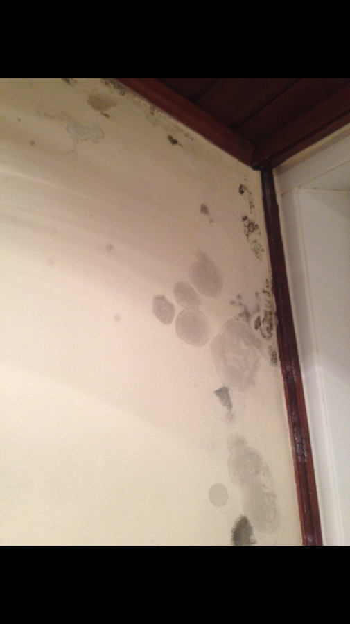

the damp is over the whole wall and is black in colour. It is on the inside of an exterior cavity wall. There is a letter box but little ventilation and the door is a snug fit. There is an internal door at the top of the stairs.

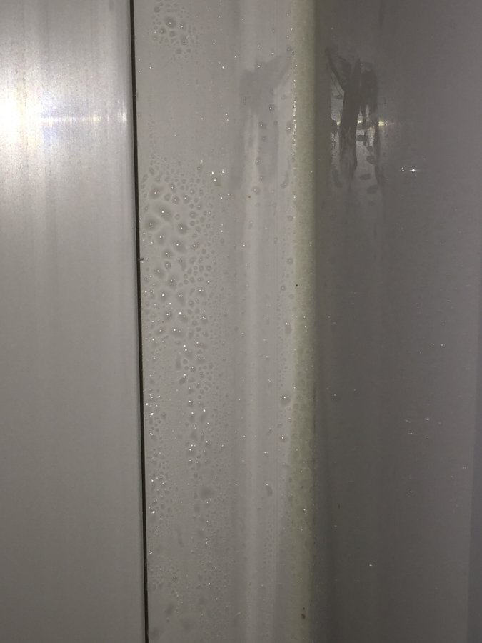

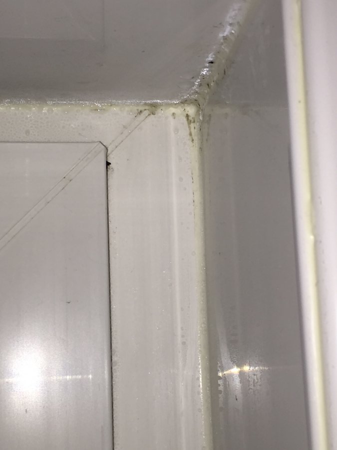

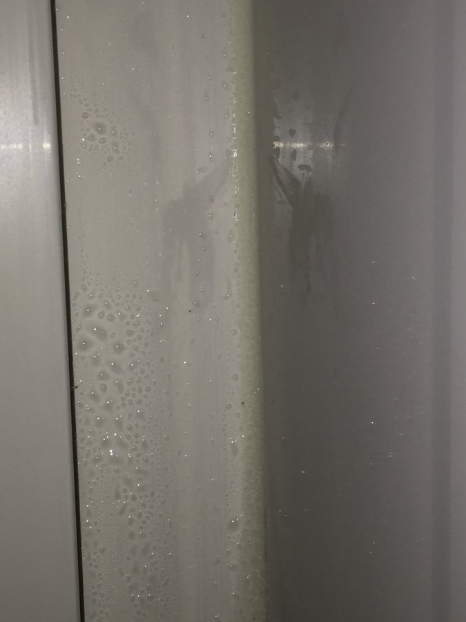

The property was built in the 1950's and would have had drafty doors and windows and no central heating. The main door to the flat is a 2 year old uPVC door with perfect sealing all the way round. There are droplets of water on the door all the way up.

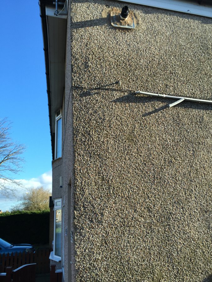

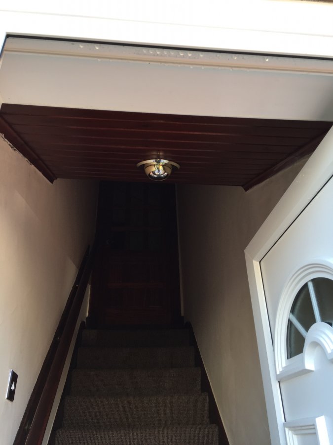

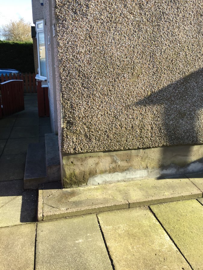

I've taken some photos today. These first 2 are the damp patches
There certainly does appear to be a lot of condensation.
First, I'd identify the pipework outside and reassure myself that there are no leaks. That means outside and where it passes through the cavity, although that would be difficult to identify and perhaps beyond a DIYer. It looks like there is a pipe pointing downwards. What is this?
There's also an overflow. Is this flowing/dripping water?
It looks also as though the dpm has been breached.
Does your neighbour suffer any damp/condensation on this wall upstairs?
Once you've assured yourself that the moisture/damps is not being caused by water from above or damp from below, I'd definitely install at least 2 vents through the external wall, one low, and one high. Perhaps low behind the front door, and one at high level by the upper door.
