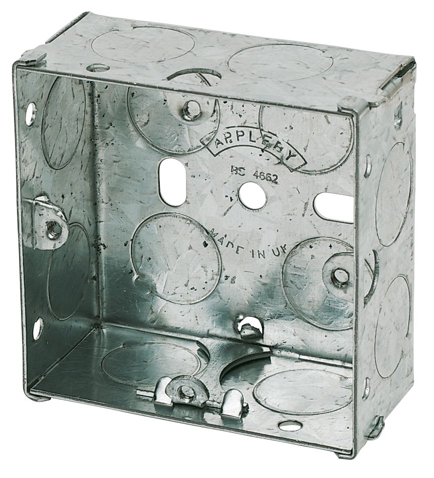

Get knockout boxes with the holes next to the wall.
As always, thanks for the very quick reply.
When you say next to the wall, do you mean the rear knockouts that you get in a box like this? Are you advising that I should fix the conduit to the wall, bring the boxes forward and then feed the cable from the rear?
Am I correct in thinking that the distance from the outer surface of the plasterboard to the nearest surface of the conduit is supposed to be at least 50mm? (or is that only if it is outside of a zone)
ae235
Yes like that picture but it will be more noticable with 47mm. Boxes.
