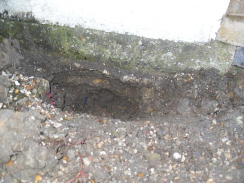

Yes you're right, I've managed to dig down the side of the garage footing as they're away and it's on a 200mm concrete base.
