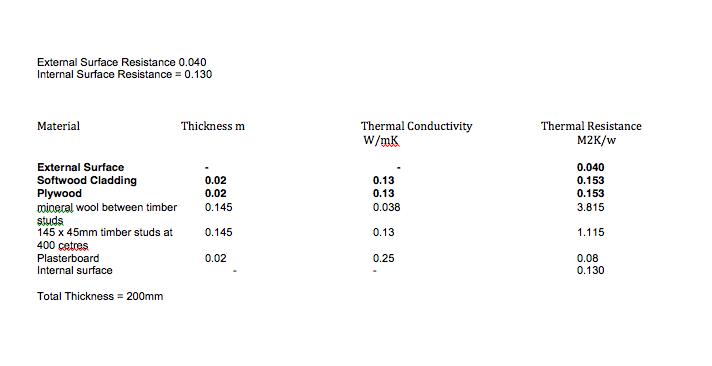

Hello, I'm new to this forum and I appreciate your help !
I have a timber frame building, and below is what I've calculated so far for the u-value. I understand that by UK regulations you need the value to be 0.3 (?)

Thats the total of 0.872, which is way to high, where have I gone wrong with my calculations ? What you see is exactly what I have done, I didn't take into account the inside and outside thermal resistance.

I've looked at that website and here's what I've got s far ( see attached ) I understand that the U value needs to be 0.3, but how is this possible when the insulation alone is 3.8? I haven't divided or taken away the internal or external surface resistance because I don't know how to. By looking at the screenshot, can I achieve a U value of 0.3 ?

Don't confuse the U and R values
U = 1/Rt = 1/R1+1/R2+1/R3...
where R1,R2 R3 are the Resistance of the different materials and Rt is the Total The above is oversimplified but should start you thinking correctly
Thermal Conductivity = U value
Thermal Resistance = R value
R x U = 1
100 mm mineral wool = R2.5 = U 0.40
The better something is insulated, the smaller the U value ( as it is a measure of how many Watts you are losing ).
For this reason you cannot add U values as you have tried to do and get an answer .
What you have to do is add up the R values and then convert to a final U value

So when I add up all the R values ( which is about 3.9 ) what do I do ? By looking at my screenshot, what would be the next steps ?

Hi
Just to confirm a couple of points
Thermal conductivity = k
Thickness of material (metre's)/k = R1 ; R2 etc.
Sum of R's = Total Resistance and 1/SoR = U
Example:-
R
Cladding - 0.020m / 0.13 = 0.154
Sheathing - 0.020m/0.14 = 0.143
Insulation - 0.145m/0.042 = 3.452
Plasterboard - 0.015/0.16 = 0.938
Rsi + Rso = 0.18
Sum of Rs = 4.867
U = 1/SoR = 1/4.867 = 0.21W/m2K
As a note, you would only need around 80mm thickness of PIR insulation to provide an equivalent R value of 3.45
Regards
Try U = 1/(0.04 + (T1/C1) + (T2/C2) + (T3/C3) + 0.13)
where C1 is the conductivity of the first material and T1 is its thickness etc. As you add more layers and/or thickness, the overall U value must drop, not go up.
Simply take its reciprocal: U = 1/R = 0.26

There were 2 questions here:
1. Is the U value low enough?
2. How the f*** do you calculate it?
I was only trying to help with number 2.
As far as the U value is concerned, start with the insulation. That alone has a low enough U value for the whole wall. Then ask yourself, are you wasting money with that insulation thickness? Could you use cheaper materials or construction?
Only if the building inspector is unhappy and thinks your windows and doors are too big, say, would you need to scrape the barrel for every last contributor to the insulation calculation (including those tiny surface effects). That is not common sense, it is bureaucracy, but a game that must be played. If you need to drop a couple of digits in the 2nd significant figure, then you should use 3 significant figures in your calculation.
