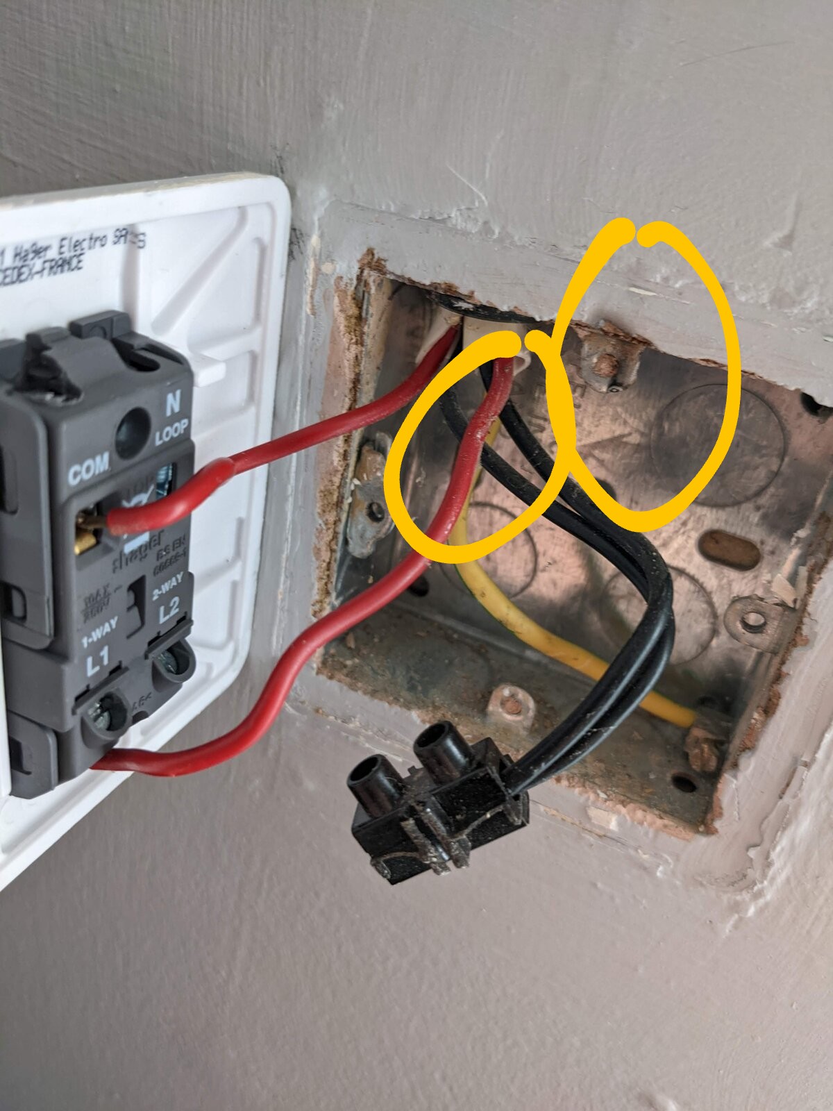

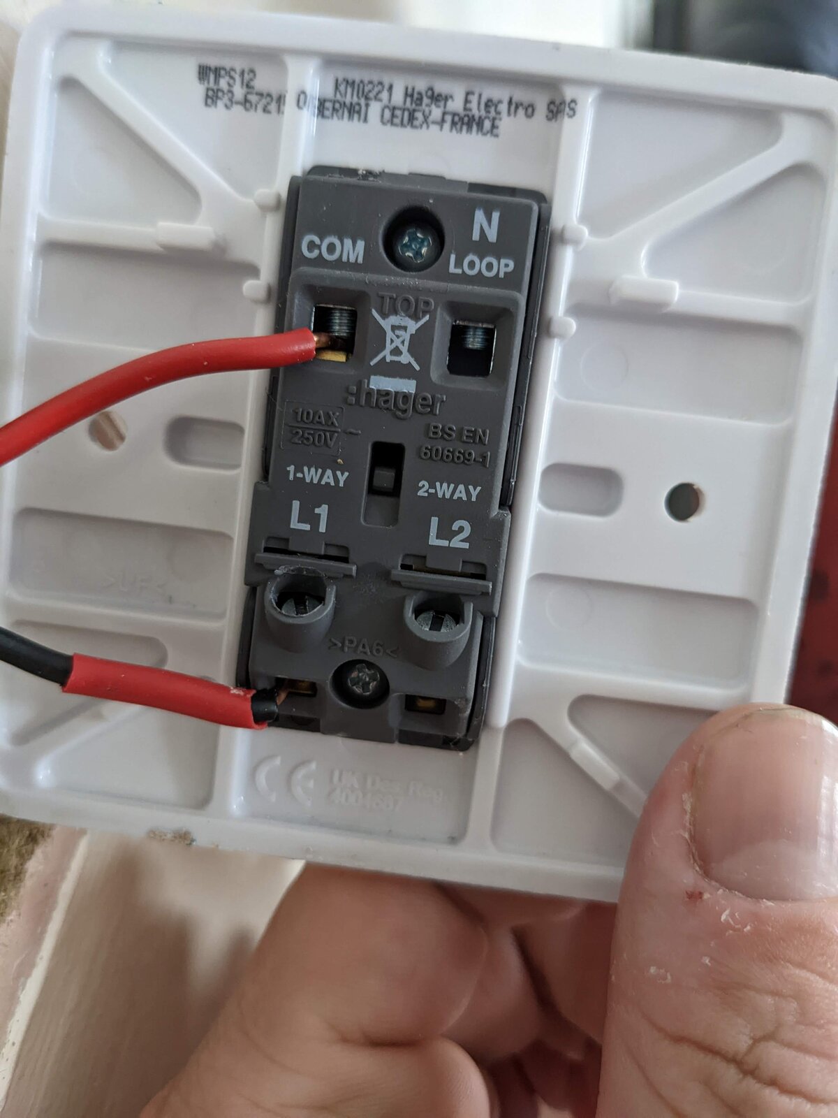

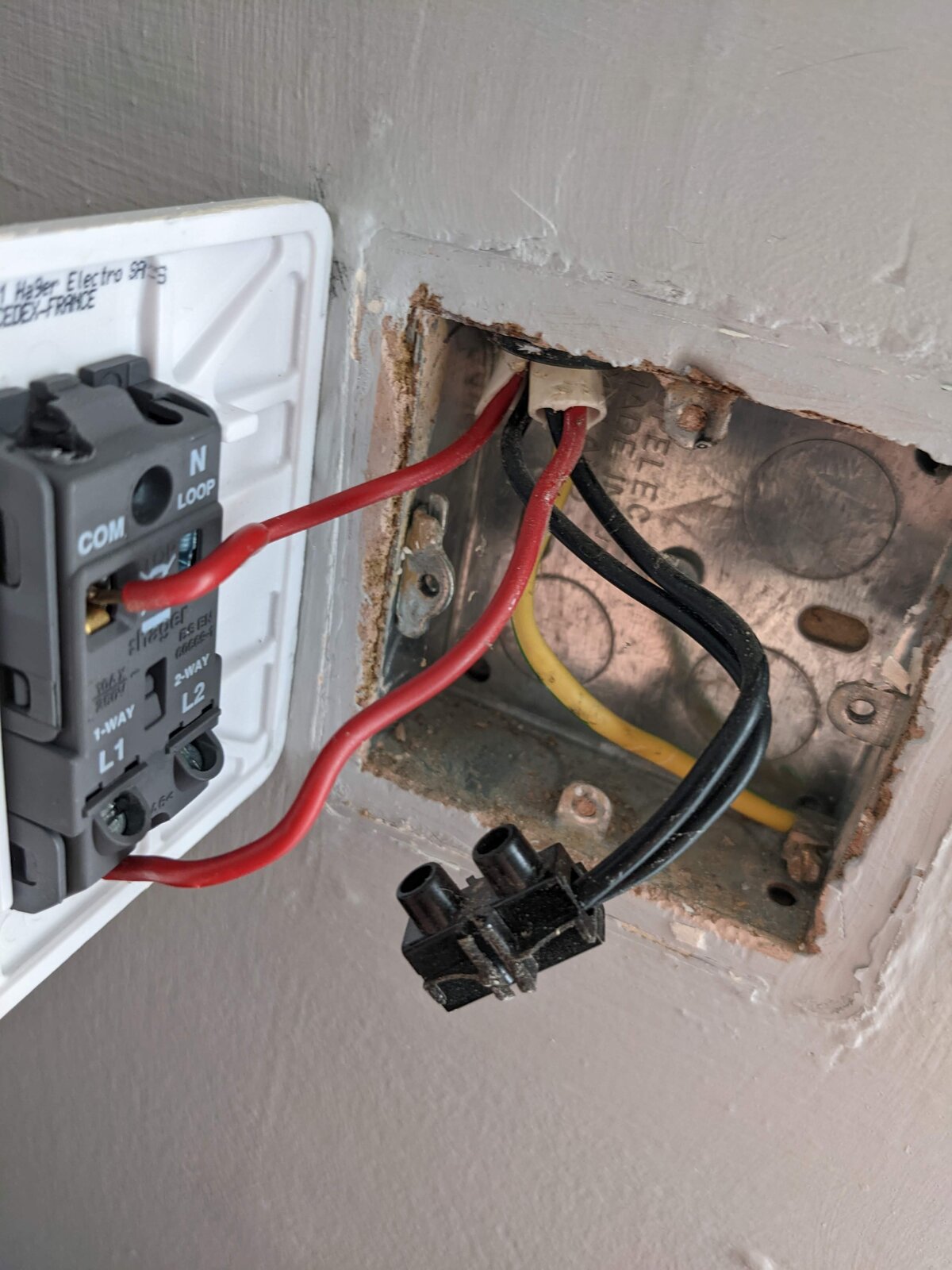

Ok here is some pictures. The garden light has the original switch back on there with everything as it was. I just used the 2 red wires and it blew. I didn't rewire it because I thought it was already correct and I couldn't understand why it tripped.

All looks as it should be.

Johnmdc has enlarged your photo and circled what the problem is. When you screwed the switch back on you trapped one of the red leads against the screw lug at the top.
This caused a short circuit to earth which tripped your RCD. You need to put some heat shrink sleeving over the damaged part of the wire and make sure you don't trap it again when fitting the switch back in place. The switch will not have been damaged when the RCD tripped.
