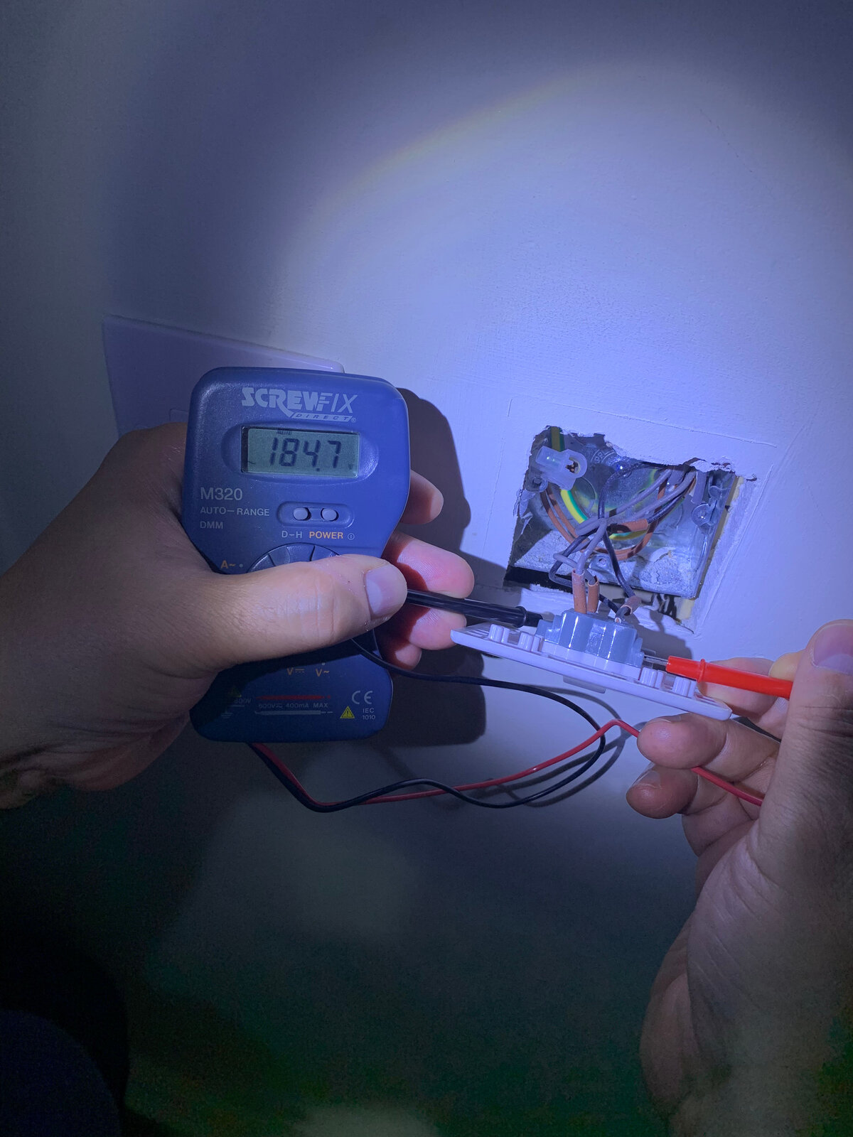

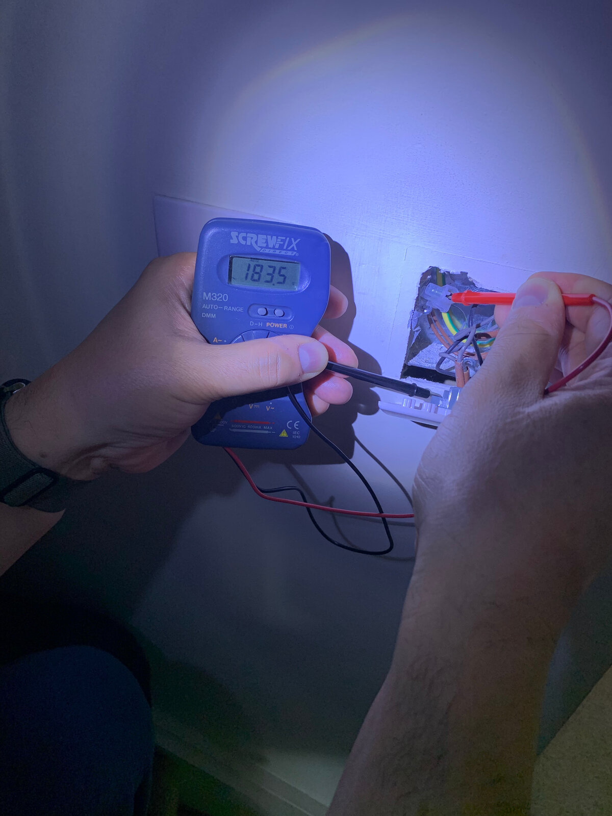

One pic looks like you are measuring across 2 line conductors at the switch terminals.
The other pic, one probe is touching a connector block and it's not clear what conductors are in it ,are they earth conductors ?

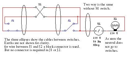

1 way is on/off, 2 way is either or, 3 way have a centre position, 4 way likely rotary switch so has 4 positions, I am sure this is not what you are talking about, likely two 2 way switches and 1 intermediate switch, which is same as reversing switch.
In the main
this is the way we wire two way and intermediate switches, but not the only way it can be done.

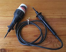

Running two wires in close proximity to each other will result in some capacitive and inductive linking, so one will likely measure some odd voltages with a valve volt meter, or similar, likely a tester like this
will work better.

- correct. Pic showing 184.7 I'm measuring between the black and dark grey cables, both on the block
- Oh no, not earth conductors, I'm touching the brown wires and the dark greys (block). It looks like for those brown ones one is coming in and one out. These do not connect to any of the block terminals. Looks like the latter are just using the box to create an extension?

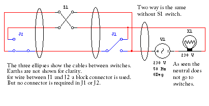

In the main View attachment 279687 this is the way we wire two way and intermediate switches, but not the only way it can be done.

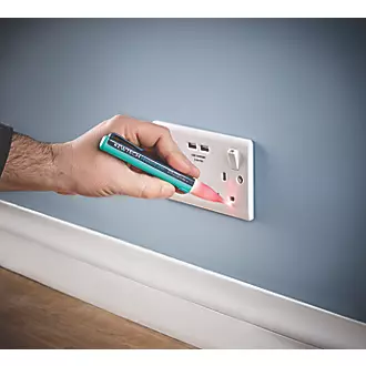

Running two wires in close proximity to each other will result in some capacitive and inductive linking, so one will likely measure some odd voltages with a valve volt meter, or similar, likely a tester like this View attachment 279688 will work better.

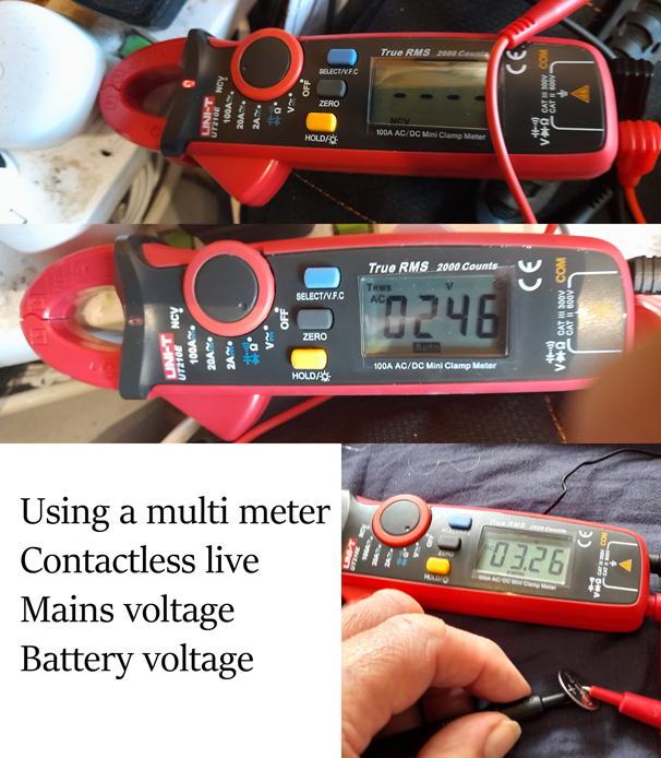

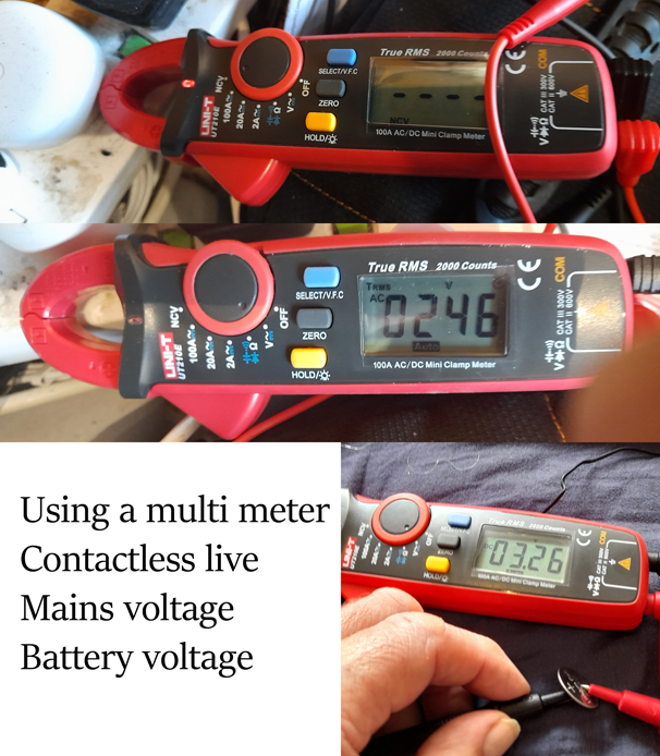

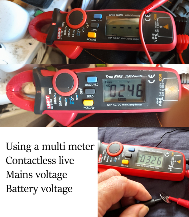

In school we are taught DC, and 50 Hz AC works in the main like DC, but not completely like DC. We get capacitive and inductive linking which gives what seems strange results. So unlike DC can detect AC with no contact testers. Multi-meter-small.jpg The three pictures show top NCV, the 4 bars means close or high voltage, as I move the meter jaws away from the source, the number of bars drops, but the Non contact voltage (NCV) is only looking at the line, there may be no neutral.
Next I am using leads, this shows voltage between the two probes, so is also measuring neutral.
The last is measuring DC across a battery.

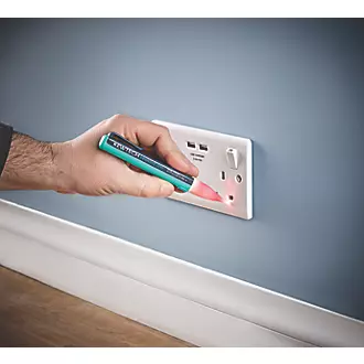

The meter you show does not have a non contact function, neither for volts or amps, and many electricians think that is good, they hate the non contact tester, in the main some thing like this, 1669829445114.png and they clearly have their limitations, but so does the contact meter, you need a reference point. Before the non contact meter I often used the earth, but the supply voltage 207 to 253 can be displayed with a high ohms per volt meter in error.
In the old days using the AVO Mk 8 I would change range, if the voltages did not match, I knew it was capacitor or inductive linking, but today the AVO Mk 8 is a museum exhibit, at the price no wonder, so we need to learn how to use the new generation of meters.
Not only meters but all testers, including the non contact and the neon screwdriver, they all have a place.

In school we are taught DC, and 50 Hz AC works in the main like DC, but not completely like DC. We get capacitive and inductive linking which gives what seems strange results. So unlike DC can detect AC with no contact testers. View attachment 287339 The three pictures show top NCV, the 4 bars means close or high voltage, as I move the meter jaws away from the source, the number of bars drops, but the Non contact voltage (NCV) is only looking at the line, there may be no neutral.

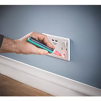

The meter you show does not have a non contact function, neither for volts or amps, and many electricians think that is good, they hate the non contact tester, in the main some thing like this, View attachment 287351 and they clearly have their limitations, but so does the contact meter, you need a reference point. Before the non contact meter I often used the earth, but the supply voltage 207 to 253 can be displayed with a high ohms per volt meter in error.
