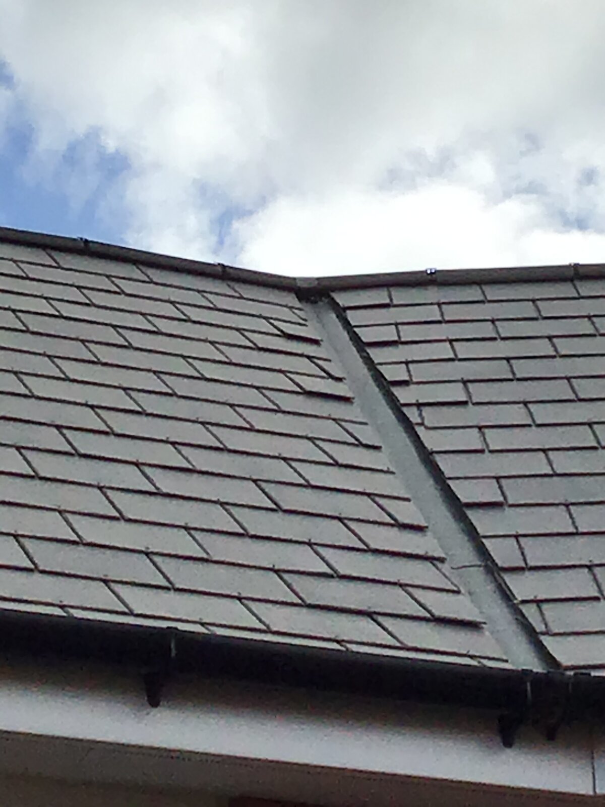

Hi all.This is my first post and I hope that I can get a greater understanding of my problems.I live in a new build of 4 years old.Earlier this year I noticed raised tiles especially along the valley.I was fortunate enough to get a RICS to make an inspection and report and was amazed at the number of things he picked up.This has gone to warranty who have refused 25 and agreed to have 2 lots of repairs carried out.One is to rebuild the valley because they have infilled with small pieces and not cut to BS and manufacturers requirements.This I understand although as yet do not understand the process.

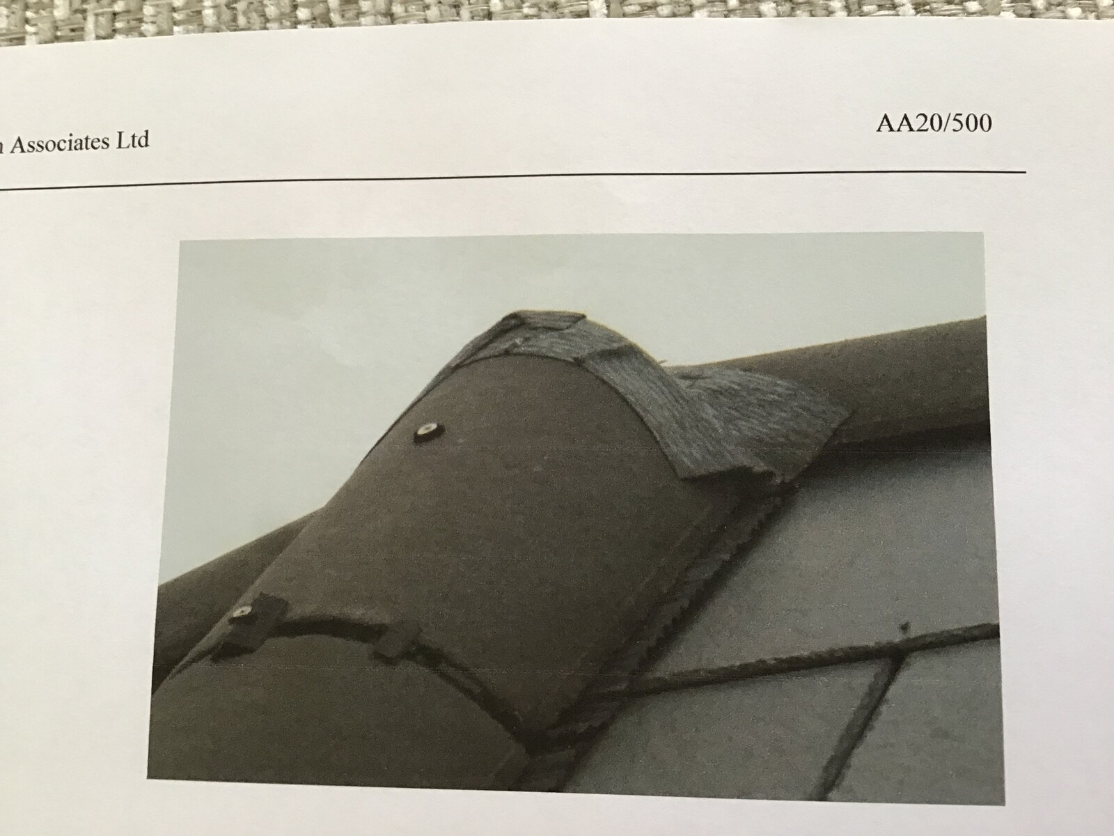

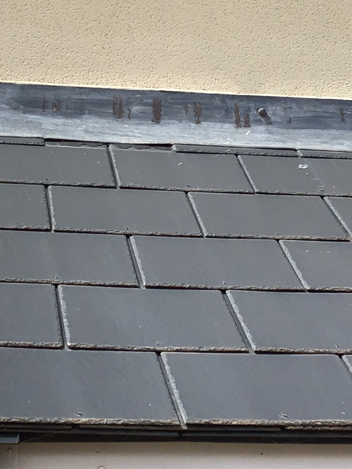

Sure.This was only from ground level,so what has been refused I will need to get investigated.Hip and ridge tiles not mitred together.It appears to be a piece of ‘fabric’ ore the top of the hip tile.Slipped tiles.Tiles not spaced correctly.It has been confirmed by Marley that there should be no more than 5mm gap.Some were measured at 9mm.Tail rivets have been hammered sideways and not downward.Valley finishes short of the gutter.Could not find evidence of soakers on wall abutment.Mono roof above kitchen has vents in at eaves but no cross ventilation.Proprietry trims missing.External porch to front door is an absolute mess and was one of the initial reasons for getting a check carried out.We lost a tile from the top of the porch against the wall and overlapped by the lead.The investigation has shown that the top row has been stuck on.Presumably the rain has got to them as the lead is screwed into the render.Just a start but just shows that trusting a developer to have followed regulations British standards and manufacturers requirements was a figment of my imagination.

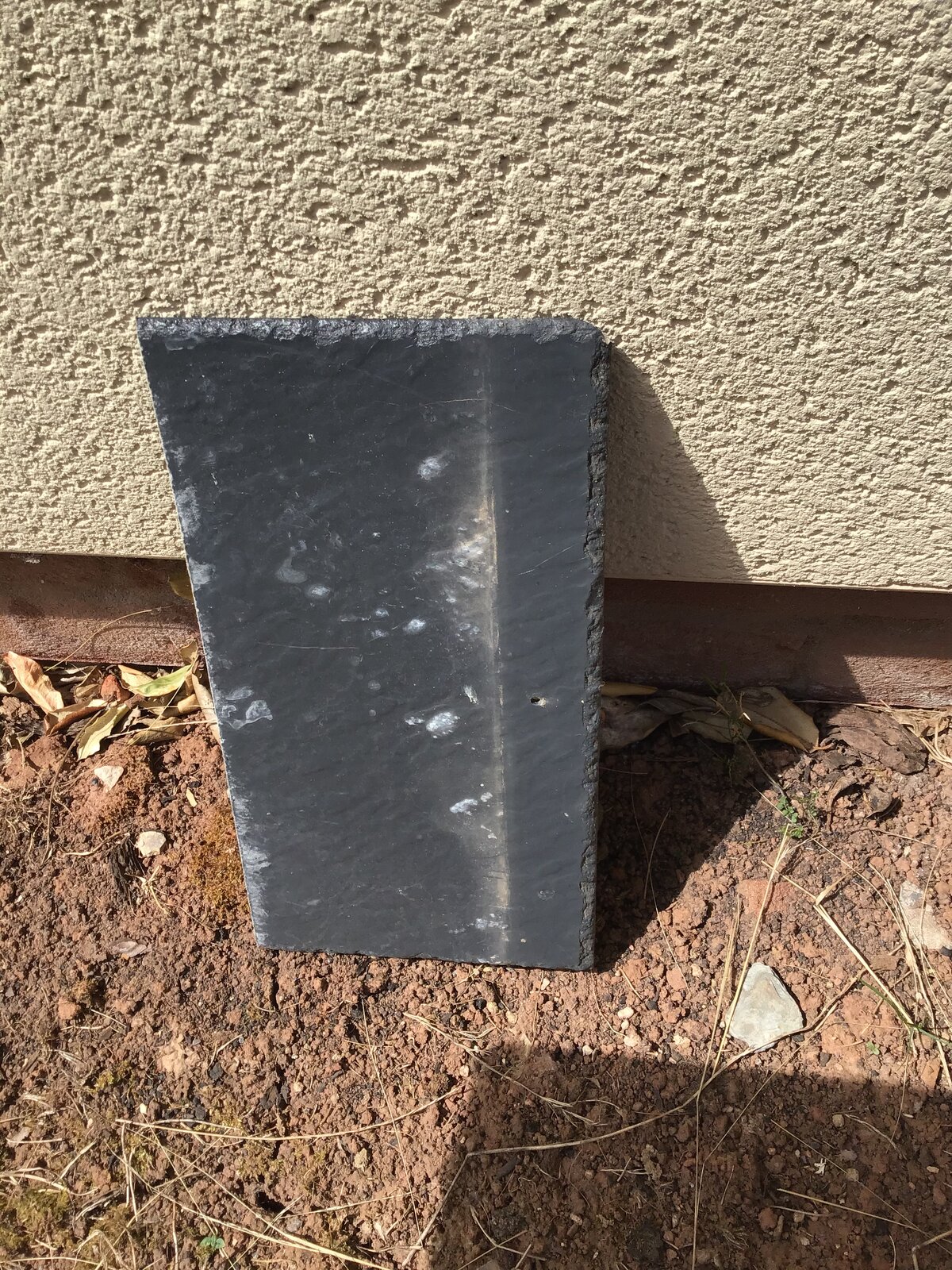

Well at least they've admitted that slithers at the valley are wrong- they're also wrong anywhere else on the roof (minimum slate width should be 300mm, you use doubles where the roof meets parapets or whatever).
That hip to ridge is a crappy bodge.
Lead screwed into the render? Really? Should be chased into the masonry.
Soakers- carefully lift the cover flashing up and have a look if you can without it falling off the screws
