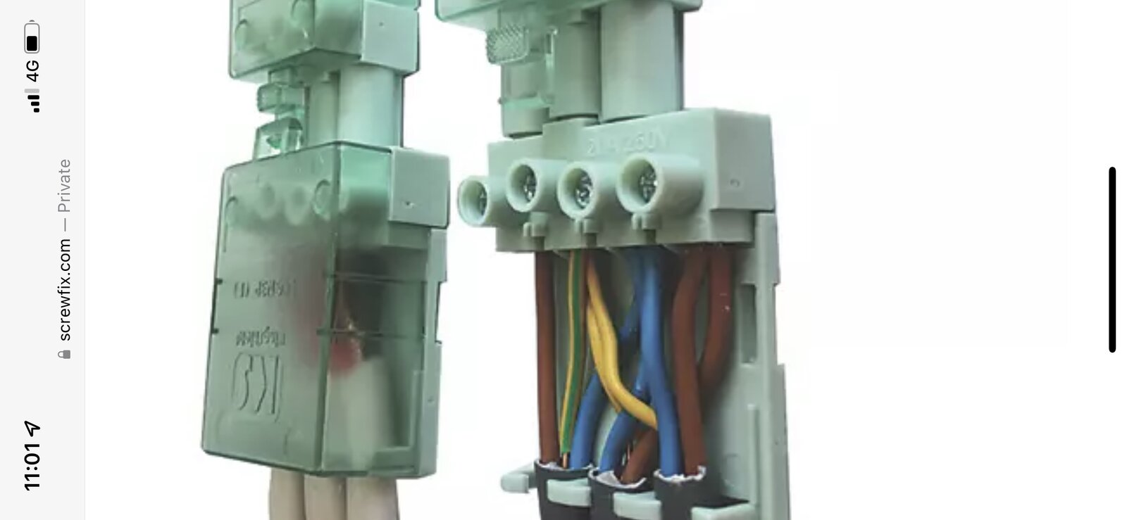

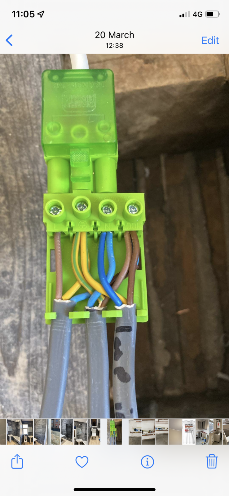

Evening everyone. Need some advice re something which doesn’t make sense. I have a greenbrook lighting connector which is wired as you would do a standard ceiling rose. I’ve now got issues with one set of lights. The wiring I’ve done (I know the looped live and switched live are the ‘wrong way’) is attached as the photo in bright green but the image I have from a well know screw shop shows something odd on their photo in safe green. It shows a neutral as a switched neutral. Not sure if that is the right term. Any help would be appreciated.

You are correct. The screw shop picture is wrong.
As for your wires being 'the wrong way round', some people like to do it that way so you can tell which cable goes to the switch (when not as obvious as those connectors).
Thank you for helping me here. It’s as I thought so basically the shop that you can buy screws and fixings at has an incorrect image?
They also like to do it so the perm live terminal has at least one brown in it, and the switched live terminal has a brown in it as well.
