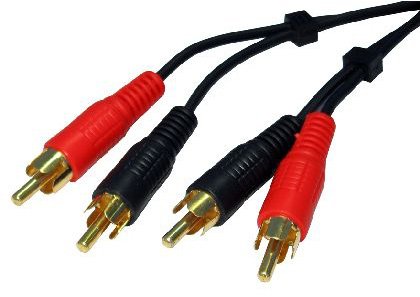

You can get standard phono cable in lots of different preterminated lengths. 20m is readily available. A couple of observations though...
First, all the off-the-shelf product whether sources from a local store or online all share the same design; it's called 'figure of eight' and it describes two cables joined down their length. This makes the cable relatively bulky.
Second, the longer the lead the more likely it is to pick up interference. To stop this happening the cable needs to be shielded. The problem is that the cheap phono cables have shielding that's only just about adequate in short runs (<3m) in environments where there's not much interference to start with, but on longer lengths it just isn't up to the job. This is the kind of cable I mean...
Those cables that make claim to better shielding are often (a) much thicker and so harder to conceal, and (b) the shielding is a foil wrap because it's much much cheaper than providing a proper copper braid shield but then makes the cable stiff and difficult to route around corners; stuff like this...
