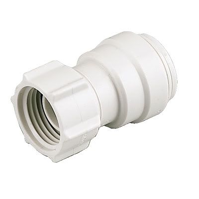

I'm in the process of replacing the toilet in my downstairs w/c.
The cistern has the usual 1/2 inlet but I can't find a simple connector for this to fit a 10mm pipe which I have, the normal seems to be 15mm.
I had thought of using a 10mm/15mm reducer and then a short lenght of 15mm pipe to go into a 15mm to 1/2" cistern connector, but don't want to have to buy a huge amount of 15mm pipe when I only need a few inches of it.
Any ideas would be appreciated!
You need a 15mm to 10mm reducing olive that goes inside your standard 15mm fitting. Lovely neat little things.
Or use one of these.
