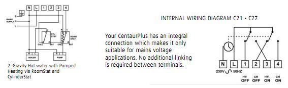

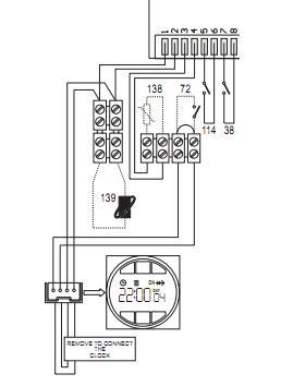

Hi guys, short question here - just wondering if I need to buy a 2 wire thermostat instead of the 3 wire one I bought in haste (haha)?
The boiler terminals are volt free (just one wire loop to break/make), but the 3 wire mechanical thermostat I have requires mains...
Is it possible to wire it to the boiler? I don't want to blow the boiler's PCB lol.
Boiler = Combi Ferroli 26kw
Thermostat = RTS Drayton
Pictures included in album...
Thanks in advance! :)
RTS is an electronic thermostatic. It won't work until you have 240v and a neutral to it. Your second diagram shows how to connect low voltage circuits, but this means you have to take 2 cables to the stat. Better off buying a simple mechanical stat like Siemens RAA.

But which RTS do you have. 1, 2 or 3 won't do.
If you have the 4, 6, 9 or 10, then connect L and N to the boilers L and N on the fused spur. Then your 2 wire volt free connections for the boiler are 1 and 3 on the stat.

Damn, it's the RTS1 lol
Looks like it's going on ebay :rolleyes:
So the programmer is a Centaurplus C27 (horstmann), and is 3 wire also - would I need a different one too? Please say no haha
Wiring below:
Just ignore the cylinder thermostat (I have a combi)
Thanks!
I'm afraid this one is wrong too. The text on your diagram says only for mains voltage. I take it you want a wired room stat and time control. Get yourself a programmable room stat. Job done, all in one.
