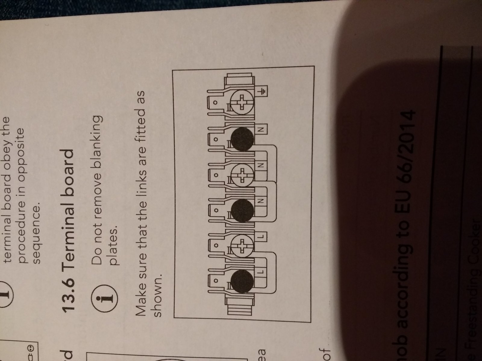

Never thought I would be posting this, but I cannot see how to connect the cable to the cooker. I have done it many times before, albeit several years ago and it was always as simple as wiring a plug, 3 wires into the right box, tighten screws and away you go.
This one has me baffled. I cant see where to put the live/neutral/earth cables. Anyone shed any light - I'm sure its simple. Instructions not helping
The 2 Ls and 3 Ns are joined by the copper links.
Connect the wires to one of the Ls, one of the Ns (the middle one) and the Earth. Not the ones with the black dots.
Thanks, I know what terminals to connect them to....my problem, believe it or not is I cant see anywhere to physically put the wire. usually it's clear - i.e. a hole to push the wire into and the screw tightens into it, but I can see no where to put the wire.....Other fittings I've used have been very clear where to push the wire into.

Best to fit ring crimps on the wires (properly) then attach with the screws.
Thanks. If that's my only options then its time for an Electrician. I don't have the tools to do that properly. Can't believe a cooker is designed to make it this difficult to connect the cable
If caught without crimps, I careful cut insulation about an inch from end and gently slide it part off not whole way the tease a screwdriver into the cores to part them so making a ring. But crimp is the best way. Reason for way terminals are set out some parts of France have split phase and this allows it to be used if required on split phase supply.

I don't think there is a desperate need for ring terminals.
On the top right of each terminal, that little 'nib' MAY well prevent a ring terminal fitting.
I think most people would just push the wire end in on the left side of the terminal, upto that nib. The wire would go under the screw head.
(If using flex, which I doubt as it looks a powerful cooker, double the wire end over.)
Though I can see the advantages of ring terminals, in the real world it seems to me they are seldom used on cookers IMO.
I think most people would just push the wire end in on the left side of the terminal, upto that nib. The wire would go under the screw head. .... (If using flex, which I doubt as it looks a powerful cooker, double the wire end over.) .... Though I can see the advantages of ring terminals, in the real world it seems to me they are seldom used on cookers IMO.
Quite so. I doubt that many cookers are installed by electricians, and I equally doubt that many people other than electricians would use ring terminals. Indeed, if anyone other than an experienced electrician did crimp on ring terminals, I might be more concerned than if they hadn't used ring terminals at all.
