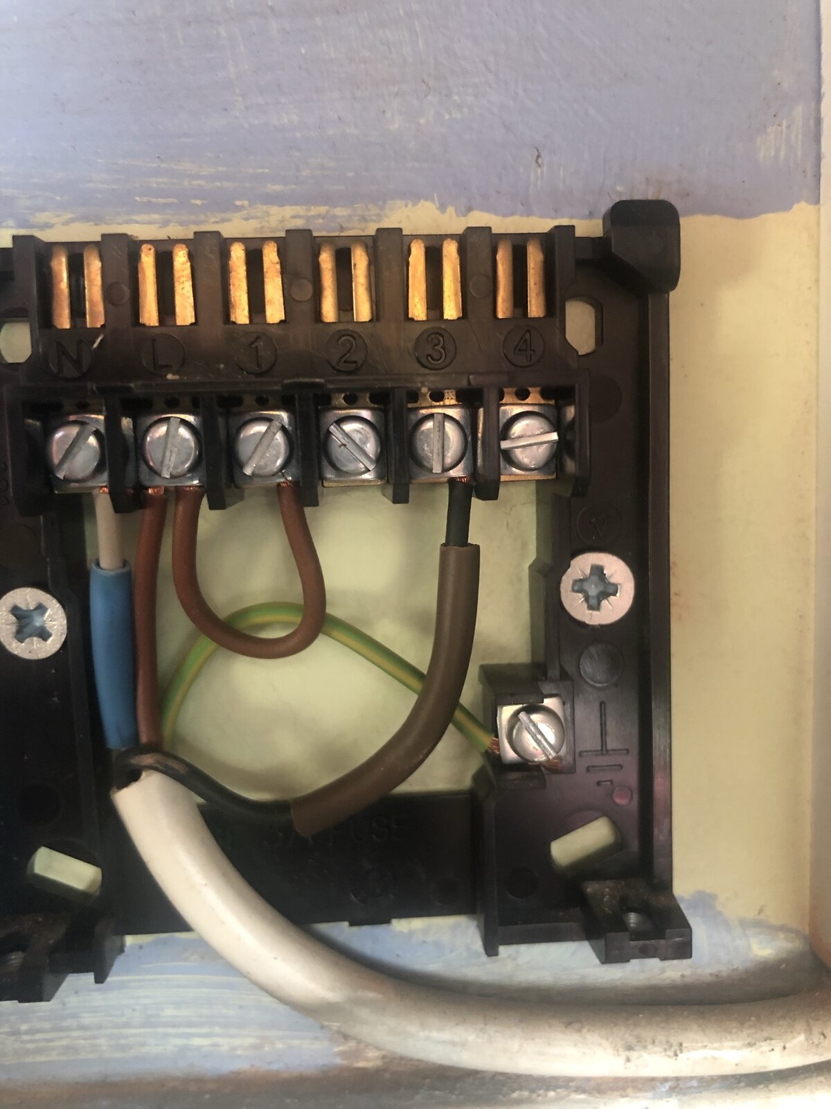

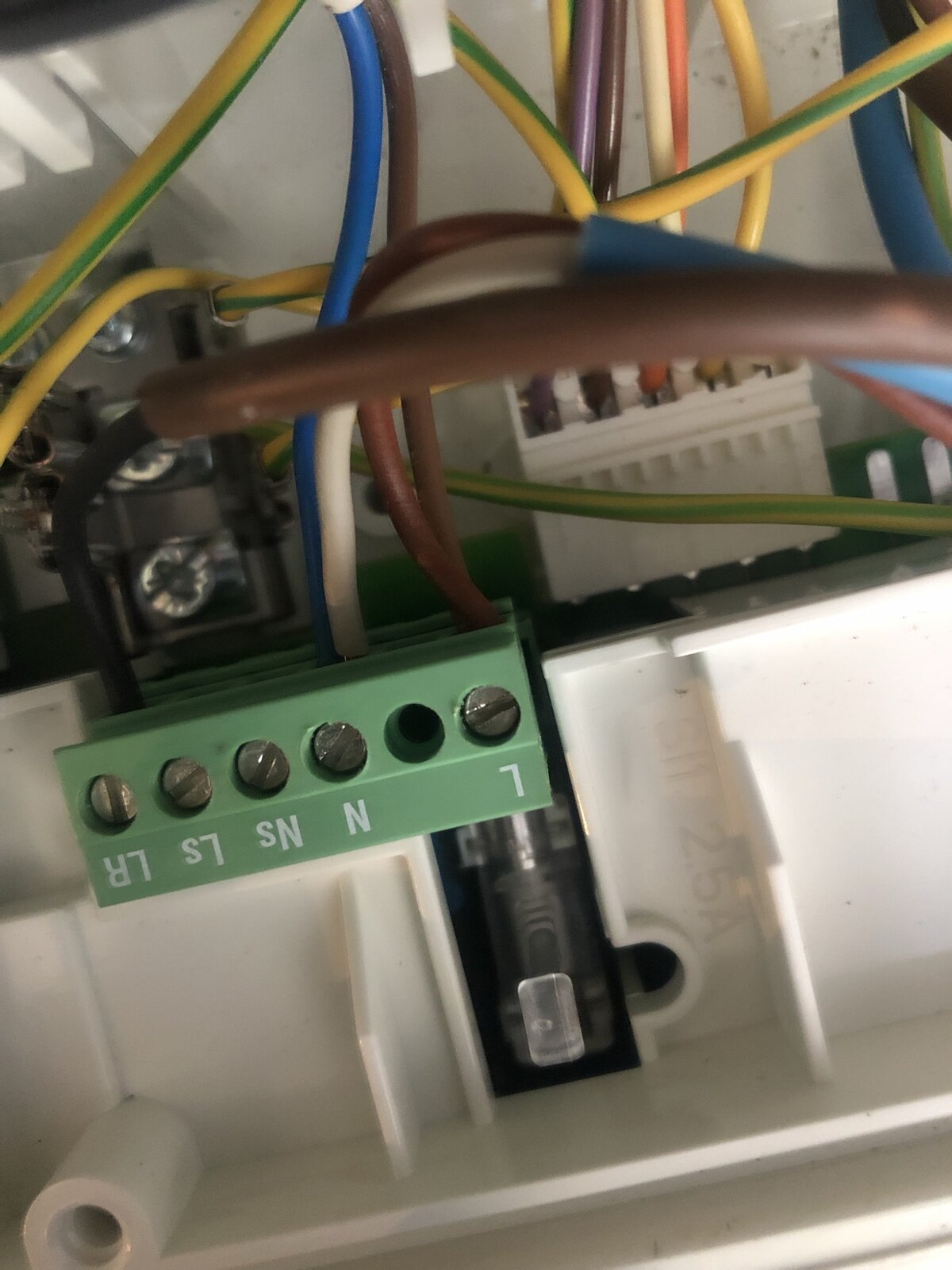

I am trying to connect a hive to my worscester Green star 28i
It has a British Gas receiver fitted currently, I have fitted it with the hub and stat all linking up. Green light comes on if you up temp or push boost but boiler does not ignite, followed bottom image. Top image is British Gas wiring and second pic is connection inside boiler.
Help please.

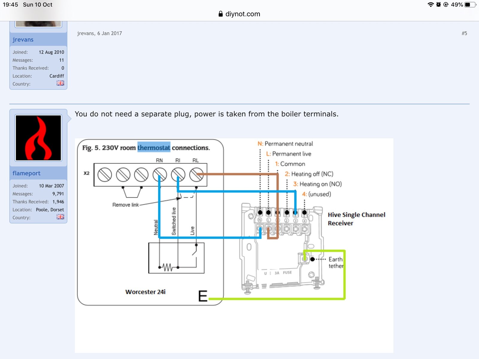

Can you show your Hive wiring? Did you get the Hive dual channel or single channel?
I have replaced the original receiver temporarily, single Chanel for the combi
I placed the live and neutral from L&N wires on the boiler To the L &N on the hive, the wire from LR on the boiler to positive 3 on the hive. I did not use the link wire placed on Original British Gas receiver.
Ah ok, just so I’ve got this right either the previous link back in or live link to the LS connection in the boiler.
No connect LS from the boiler to 1 on the hive, or you can make a link between L&1 on the hive with nothing in LS on the boiler and LR to 3 on the hive either way will work
