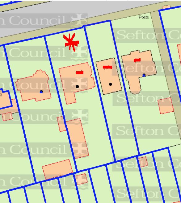

Our site is the one with the * and as you can see its a sizable garage.

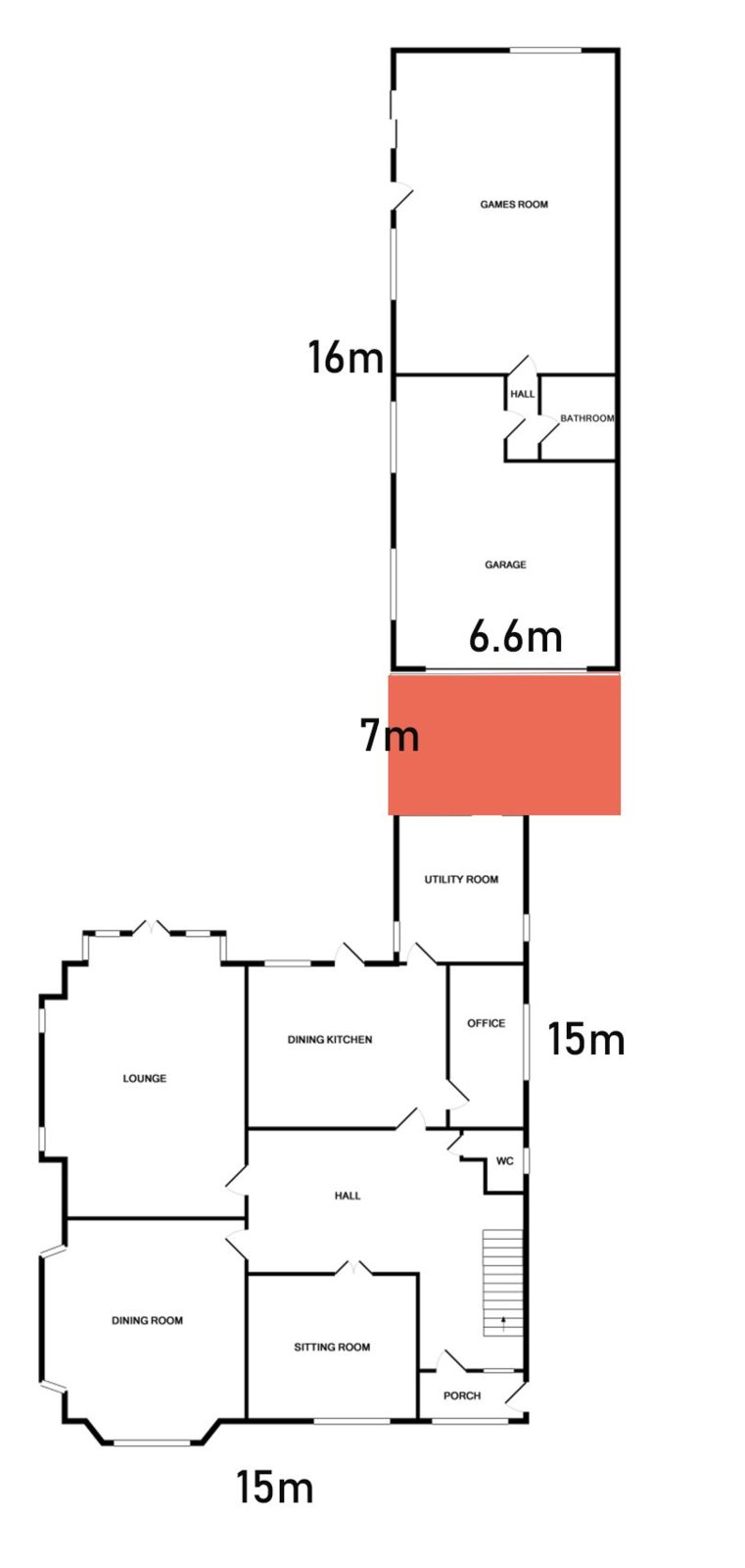

We want to connect to the garage via the outrigger ( current utility room)
My thoughts are a lean to type addition with a garden facing Opening either for Bifolds or big doors
PD or Planning.
Or can we get round Planning by looking at other ways to link?
Cheers

If the Utility was not part of the ‘original’ building, I can’t see how you could infill the gap under PD as it would exceed the PD guidelines, i.e. exceed 8m in depth via the Neighbour Consultation Scheme.
What are your concerns if you did have to submit a formal Planning application? Have the LPA been difficult for extensions/alterations to the property to date? As the extension is located to the rear, I can’t see why the LPA would have as many concerns.
If you were to infill the gap with a traditional extension, would that the remove the access from the front to the rear or is there still sufficient access on the other side? Not that it’s a Planning policy to provide front to rear access but more from a re-sale point of view.

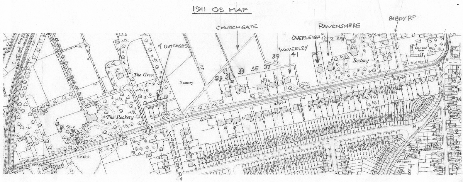

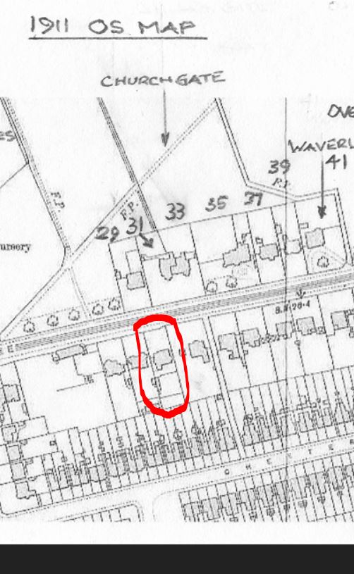

We think the utility was part of the original building. Its shown on this 1911 map. However we believe the Garage may have been extended to the rear around 1982. But can't find planning application anymore.
Ah ok, that would be deemed as original. My personal opinion is that it would require Planning. The only thing I can base that on is I did something similar (to provide an infill extension) and the LPA stated the resulting extensions would exceed the limits as stipulated under PD. Still to this day I was a little confused as both the dwelling and garage were in that situation built at the same time. But because the clients wanted to press on, we just ended up submitting a formal application as a result of the ‘confusing’ Pre-application advice.
If you were looking to go down the PD route, would you have just carried out the works without going down the Certificate of Lawfulness route? If so, then I can understand the added pain about the additional red tape. If however you were going down the CoL route, then the application fee would have only been 50% of the Planning few anyway, still with an up to 8 week determination period.
Planning would still treat that as an extension so the same rules there would still apply irrespective of its construction.
