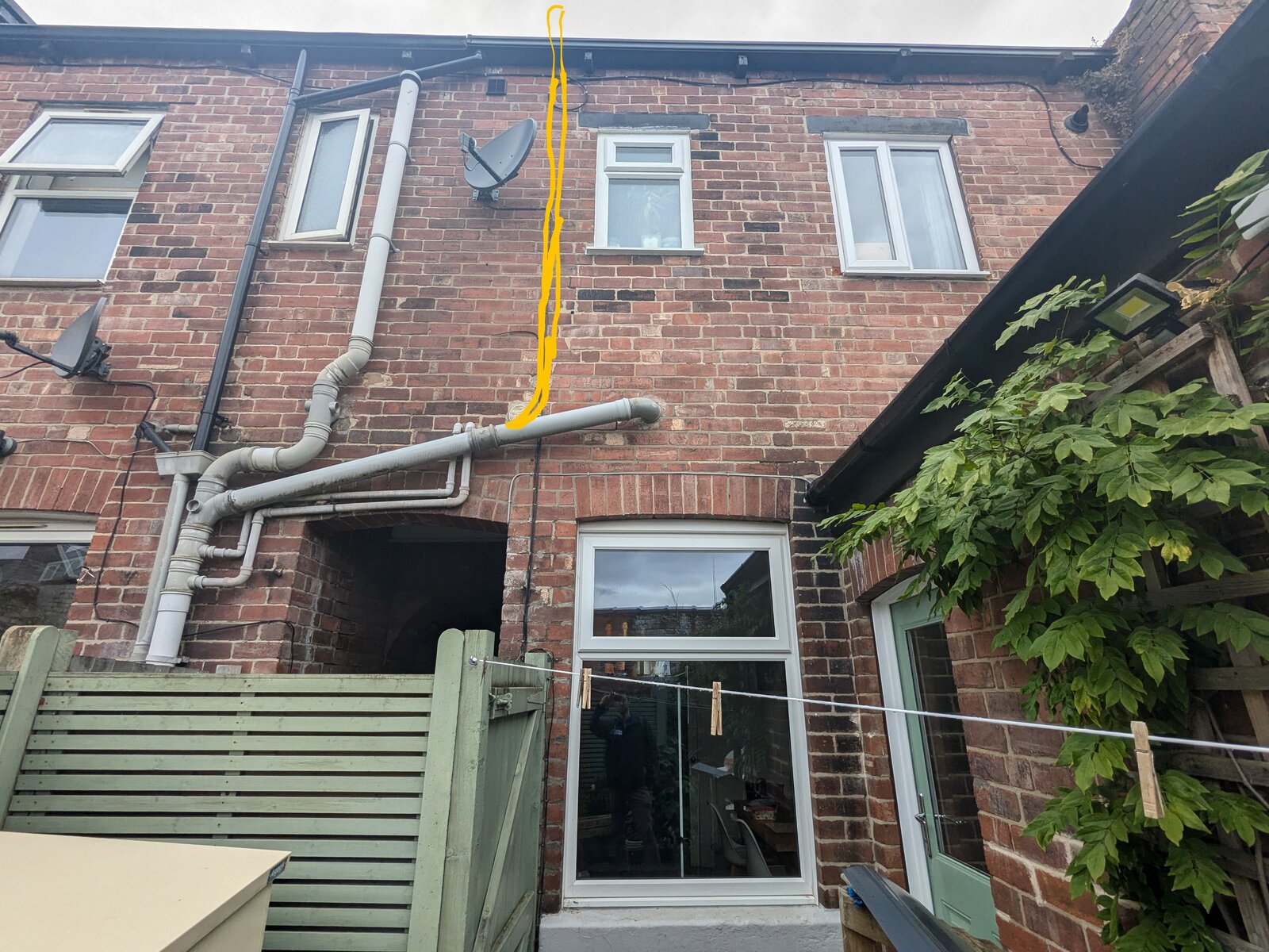

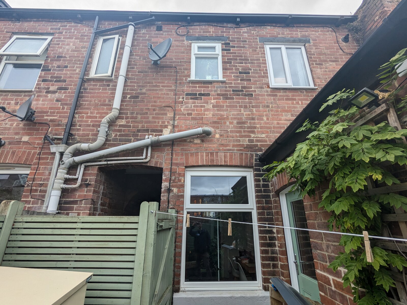

Hi,
I want to install an ensuite within my attic bedroom. The current soil pipe is shared with the neighbour on the left. My property is to the right of the ginnel. I am aware that the existing soil pipe is probably not fully compliant with regs as it has an offset in and the connections into it are less than 750mm from the offset (mine just below coming from the branch pipe and neighbours straight in above the s bend. There have never been any issues in the many years I've lived here.
My question is whether I would be able to connect a higher level soil branch pipe for a WC near to the top of the stack which is currently just serving the AAV. (I would also raise the stack height and AAV to be above the inlet level). This would elbow out of the property just below the gutter level. Would there be any issues with the height of the drop with waste water/solids hitting the 45 degree offset and then the S bend? Do you think BC will accept this as the pipe is already in place?
Without installing a new soil pipe the only other options I can think of are: install a mascerator so only liquids are discharged into the new inlet at high level, or run the new soil waste vertically down the wall and join into the existing branch pipe?

Thanks, do you mean something like this @

Thanks, do you mean something like this @Hugh Jaleak . Is it acceptable to regs to install a section of vertical stack that isn't the soil stack itself?
I've spoken to a plumber who isn't convinced this is to regs - reading the approved doc it isn't mentioned specially, anyone got any thoughts which part of the regs covers this?
I fail to see an issue, whilst it's not conventional, you're adding to an existing installation, and have to work around what's already there. Regs simply state 'Bends are best avoided in the wet section of a stack', but there are occasions when they are unavoidable. Nothing you've suggested in your illustration gives me cause for concern.
