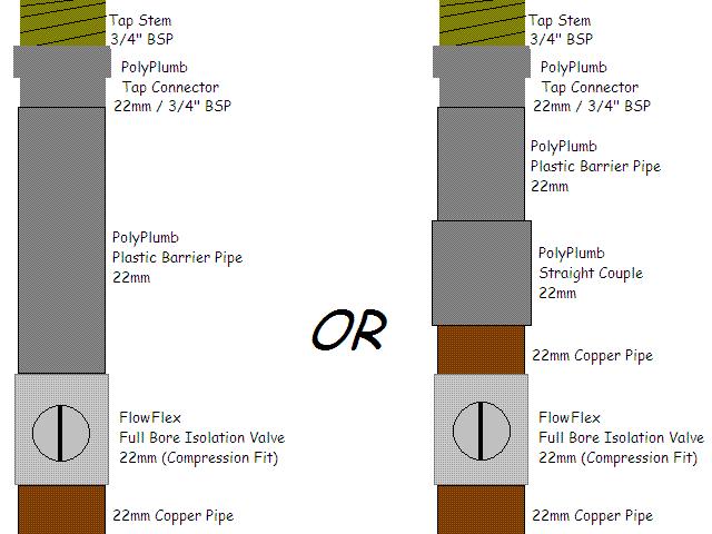

Ok, so I've taken on board the above, and compared what is 'out there' compared with the flexis, and I've come to the conclusion that the flexis really do look too restrictive.
So what I've come up with is this;
One of these connected to the tap:
(http://www.wickes.co.uk/Polyplumb-Straight-Tap-Connector/invt/424976)
Then some of the barrier pipe to create a tail that is 'slightly' flexible, but is full bore;
(http://www.wickes.co.uk/Polyplumb-Barrier-Pipe/invt/424996)
On the end of the 22mm copper that is feeding the bath I am planning to fit one of these FlowFlex full bore isolation valves:
(http://www.screwfix.com/prods/43961/Plumbing/Brassware/22mm-Full-Bore-Isolating-Valve)
What I am not sure on, is whether I can feed the 22mm plastic barrier pipe straight into the compression joint of the isolation valve or not?
I was thinking it might be better to instead have a short section of 22mm COPPER pipe coming out of the top of the isolation valve, and then use an straight 'inline' polyplumb connector to connect that short piece of copper pipe to the section of barrier pipe coming from the bottom of the taps.
Any recommendations?
I've done a dodgy 'paint' drawing below to try and better illustrate what I mean:
I'm not not sure how well a normal 'compression' type connection that you would normally use on copper would grip (and seal) against the polyplumb plastic pipe, hence my thinking that maybe I should have copper on both sides of the valve, and then use a straight polyplumb couple to do the transition from copper to plastic?
I'm also presuming that where ever I have an 'end' of plastic pipe I have to insert one fo the pipe stiffner things before I fit a connector to it?
Something like this:
(http://www.wickes.co.uk/Polyplumb-Pipe-Inserts/invt/425001)
Cheers :)
My DIY experience is limited to 15mm, but here goes:
Metal compression fittings on barrier pipe need COPPER olives (not brass). Inserts should be used and should be plain (no O-rings).
If you change your mind and use flexible connectors, I'd go for separate isolators rather than combined - it's much easier to slip a flexible connector off a copper stub than to unscrew it from the tap.
Cheers, turns out the full-bore 22mm ios valves from Screwfix use copper olives, and I bought some slightly different pipe & fixings from Wickes, but looks like it should work :)
