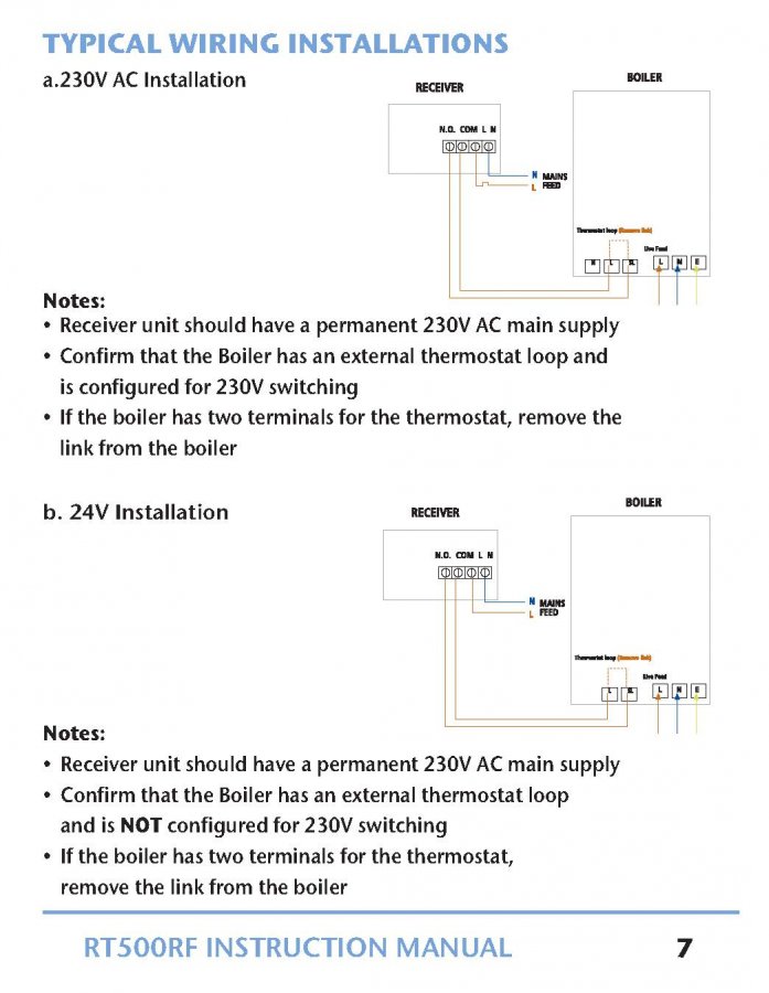

Based on the manuals for the Boiler and Thermostat, and some on-line videos I believe that I will need a 3 core cable (no earth required) and the following connections:
Atag SwL connects to Salus NO
Atag L connects to Salus L & Salus COM
Atag N connects to Salus N
Is this correct?

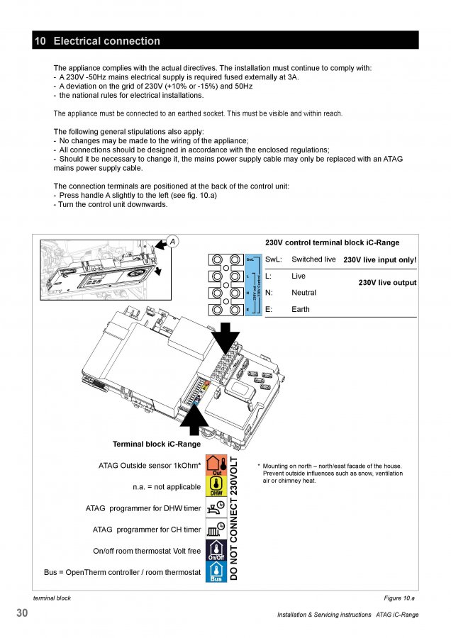

If so the Boiler Manual also notes "230V out" for L/N/E and "230V Control" for SwL/L/N/E - which connections should I be using for L/N/SwL?
