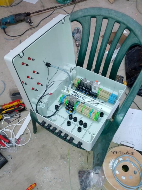

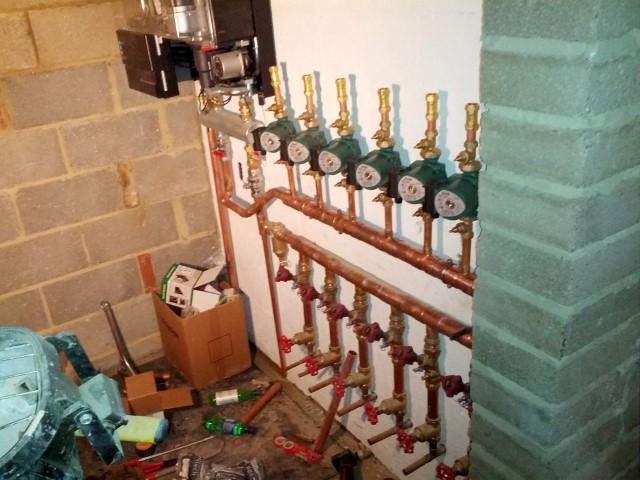

I wire on average a system a week for a local installer. Mainly seems to be s plan plus these days, but occasionally get a nice thermal store and zoned UFH installation to wire up.
Did a nice 4 zone system a little while back.
A relay per zone, so the boiler and pump won't run until the zone valve has opened.
Does that count?
Nice lacing there dude....
Did one recently - 5 zones, hot water and hot water priority (when tank was half depleted) through relays.
Wiring centre didn't look as neat as yours though - wanted half a day extra to tidy it up, but there other things that needed doing in the time allotted.
Squeaky bum moment when I powered it up for the first time I can tell you :LOL:
No - I'm not posting a picture of the finished box :LOL: its a little embarrassing - but it works ;).
