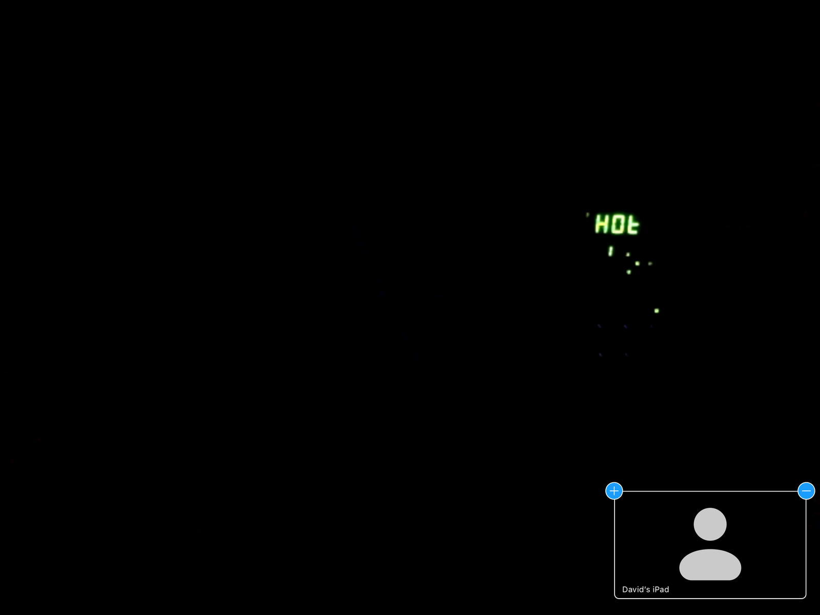

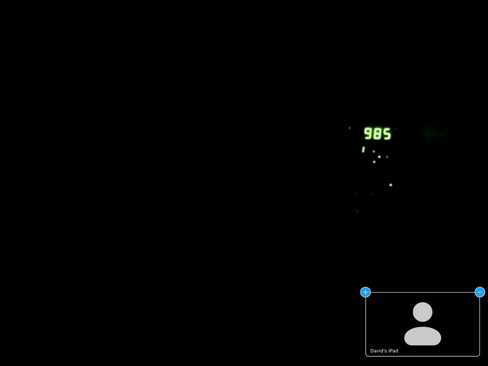

We have a need to monitor a handset with a digital readout.

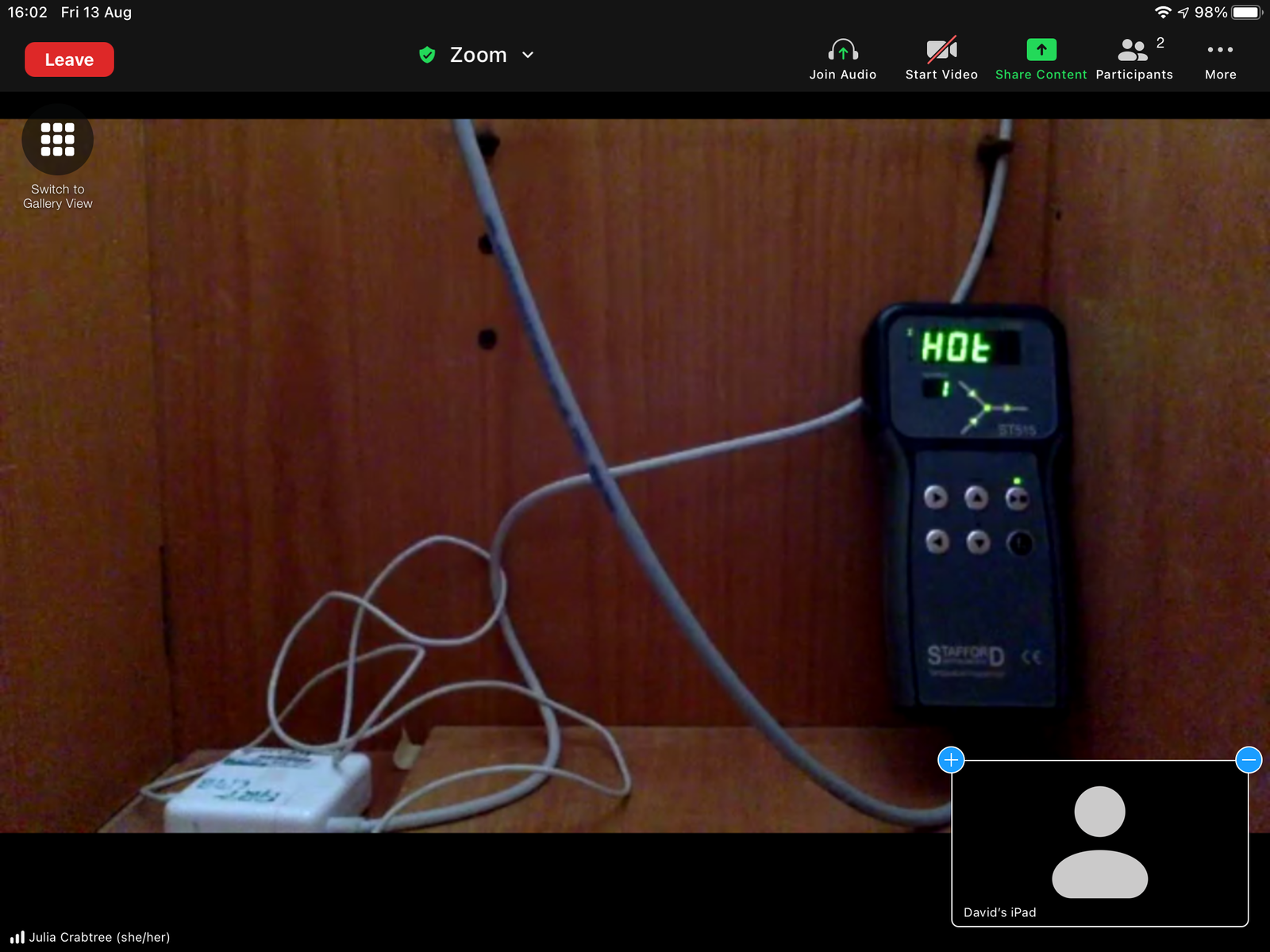

We have so far set up a laptop in a cupboard (for security) pointed at the handset and connected to a zoom call. Anyone can log in and see the readout
The original concept was to buy a cheap wifi cctv camera and connect to our "corporate" wifi but that's heavily policed by the IT department and they are generally not cooperative with this sort of thing.
Another option is to buy a wifi dongle and bypass the corporate system but I am not sure about cost? We would be looking at about 48-60 hours to go over a weekend. Don't know how much data a video of a digital readout takes ? It doesn't rise or fall rapidly
Third option could be to find a PC/Mac on the system and (ideally) connect a webcam on a 10m USB extension.
Ideas?

IMG_0119.PNG IMG_0120.PNG Cheers

The person wanting to do this bought a cheap £18 wifi camera but anything cheap could do
At present the laptop sends this image via zoom to a call that anyone with the meeting ID can see
We could organise something closer up but it was a bodge done as a test in a cupboard for security
The handset is about the size of a multimeter and annoyingly can be provided with some kind of remote access but that involves a whole separate new handset and £800 cost. Plus no guarantee that IT would permit connection!

We just need to monitor the temp gauge
