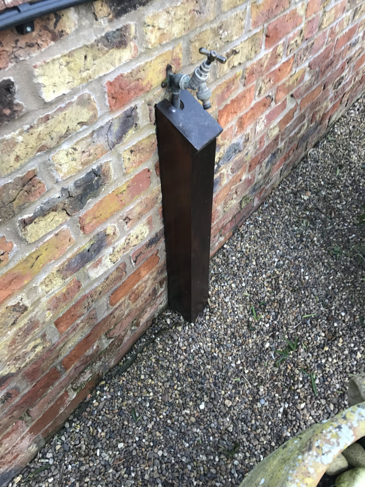

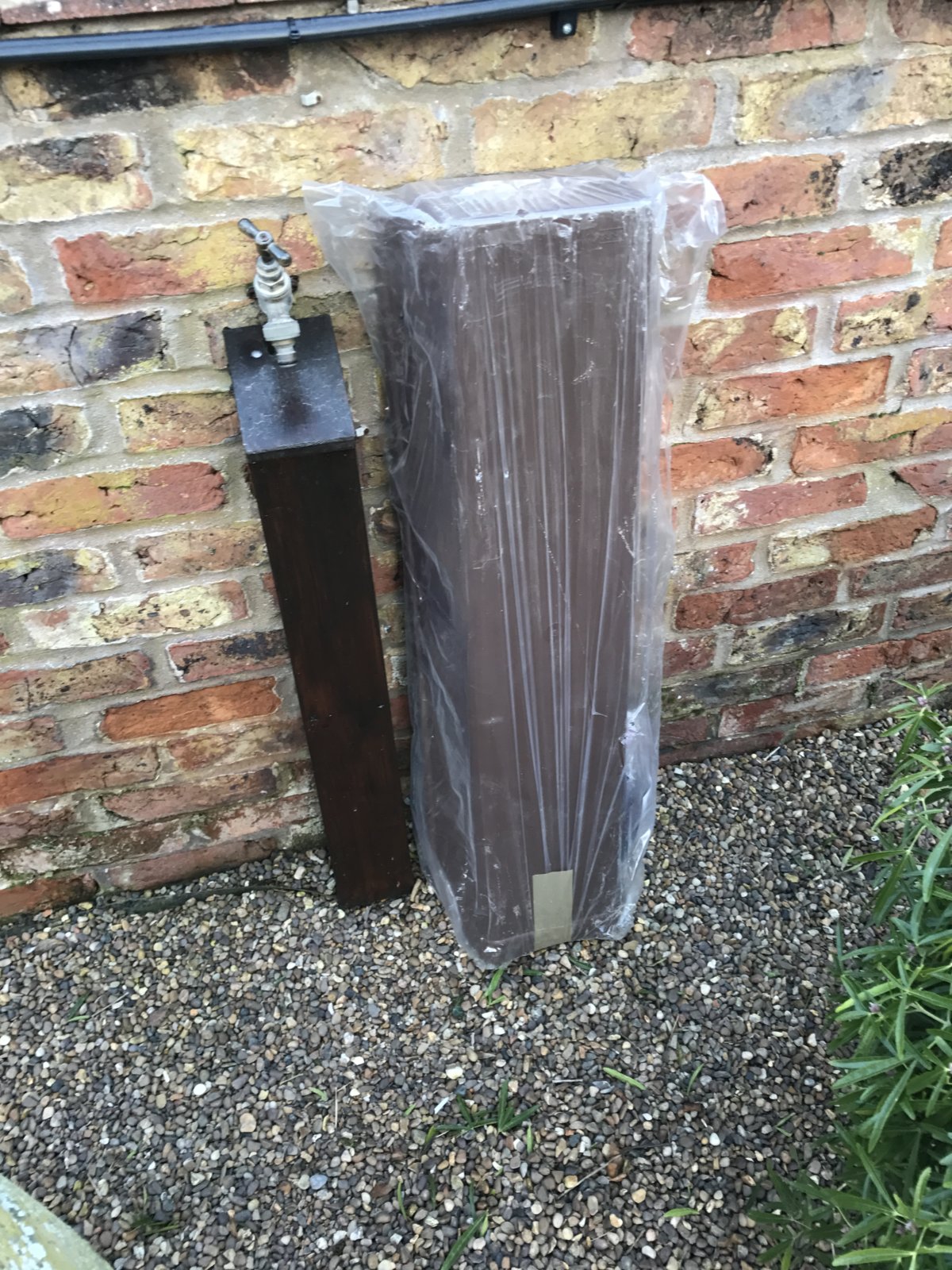

I'm on a job today and they have an outside tap off their supply.
I've put a new T on for it (its at an odd angle because my mole took a nose dive). :
The pipework is in a very basic box but it doesn't freeze, today it's -5 here :(
The only difference will be the fittings used. If your pipe isn't blue MDPE then you will need a couple of extra fittings to connect your new T.
Presumably it was existing setups but whoever installed originally left no means to drain or isolate the tap itself, and presumably the dcv is in the tap body, I'm surprised it doesn't freeze and destroy the dcv.
Yes, that's how it has been for years. I'm not sure if there might be something inside the box but compared to an insuduct it's pretty small
