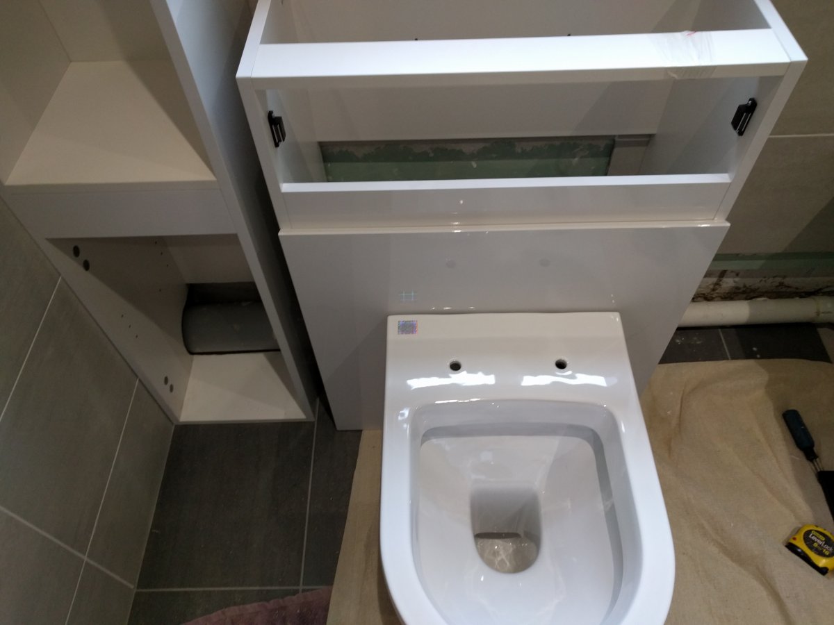

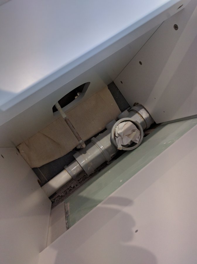

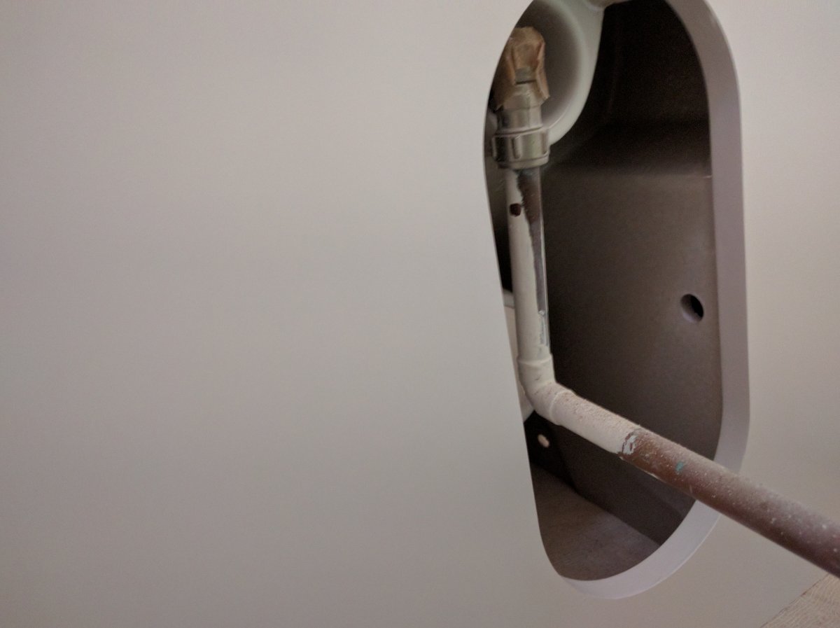

Hello!
I'm in the process of installing my bathroom and i'm wondering how is best to connect into the soil pipe. A tee pointing upwards will mean the flexi pan pipe i'm going to use likely would not have fall on it.
Is there a different type of tee piece i could buy that doesn't stick out so much, or other ideas on what i should do? could i just lay the tee piece flat if i can get a small flexi?
If i were to extend the tee so it was directly behind the toilet that would be better, but involved adding two more joints, one in the 110mm and another in the 55mm that joins it, i'm not sure where would be enough room on the 110mm to add another joint there.
Any suggestions on what is best to ?
thanks.

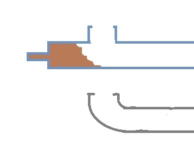

Dropping soil into a horizontal run via a T junction is a recipe for disaster. Use a bend to allow the flushing water to carry the soil away.

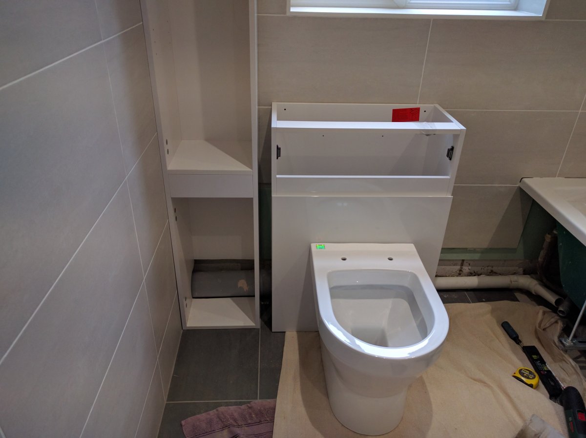

Who fitted that soil like that? You need to get that t in line with the bog. Why is there a gap between the units? Thats not helping.

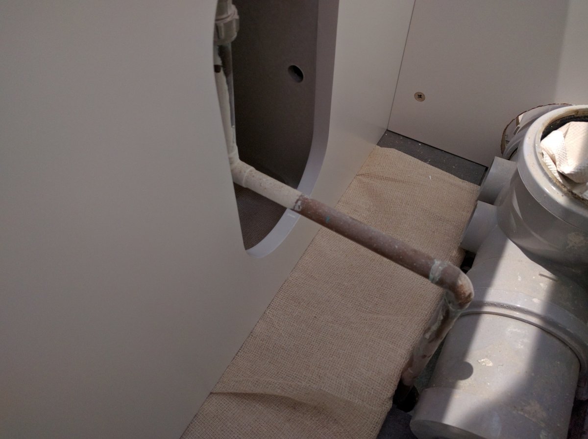

You need to cut the 110mm back nearer where it comes out the wall, (leave enough pipe to be able to get a coupler on!), then fit a new piece of soil pipe of appropriate length to bring the junction in line with the outlet from the pan.

Cut the horizontal 110mm soil pipe, insert a new branch at any angle you want, reconnect the waste pipe into the horizontal pipe.
With single pipe soil/waste systems the waste pipe should go into the vertical stack, but in the real world.

If there is another toilet using the horizonal soiil pipe then the flush from that will almost certainly flush away any soil that goes the wrong way when it drops out of the T. The flow from the bath / wash basin may be enough to achieve that.

Sg86 after a further look at your photos I see it's a Marley 110mm branch with ring seal joints. It maybe possible to swivel the existing branch to a desired angle then fit a flexi WC connector.
