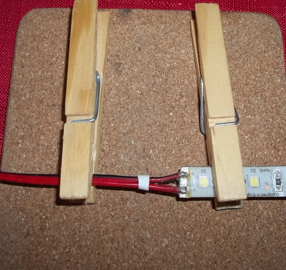

The manufacturer only makes these connectors: Aurora EN-ST100B and Aurora EN-ST100C. Although the website doesn't state, the former comes with a 10cm trailing lead and the latter with a 20cm lead between the two connectors. Neither is remotely long enough for my needs.
And thanks to Frodo for the soldering instructions. They look much sounder than the way I tried last time. You're tempting me and my hands (with their nearly-pensioner levels of steadiness) to have another go with the soldering iron.
I have the same problem. (Well past "Pensioner" age.)
However, if you rest the "work" on a "bench" and keep in position with a "weighty object" (Pliers etc.),
one can then use two hands to both "use" the soldering iron and "support" its use.
