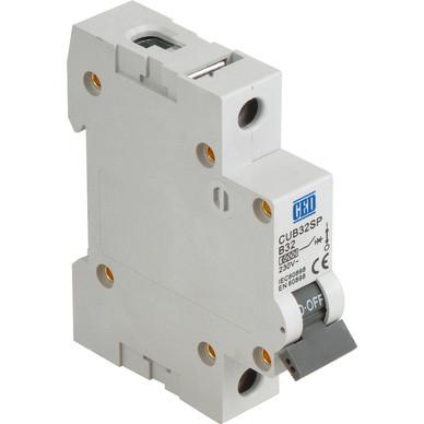

Yes thats right, its how it was. However, the RCD didnt trip, only the MCB for the sockets (the kitchen had it's own consumer unit fitted for this kitchen installation with 2 MCBs, 1 for the cooker and one for the kitchen sockets, the lights are on a separate fusebox)
From the sounds of your replies, it was originally wired in a pretty dodgy way by using 2 different sources so I dont fancy going down that route.
Any other ideas?
My idea is that you should get an electrician.
If you can't connect 2 wires without creating a fault that trips a B32 in a few seconds (100's of amps) then:
a) you really should not be doing electrical work
b) you might have damaged something.
I question if really a MCB? Is it in fact a RCBO which is a MCB and RCD combined? If it is a RCBO then likely it has a trip button and some where 0.030A or 30 mA is written on it as well as something like B32.
