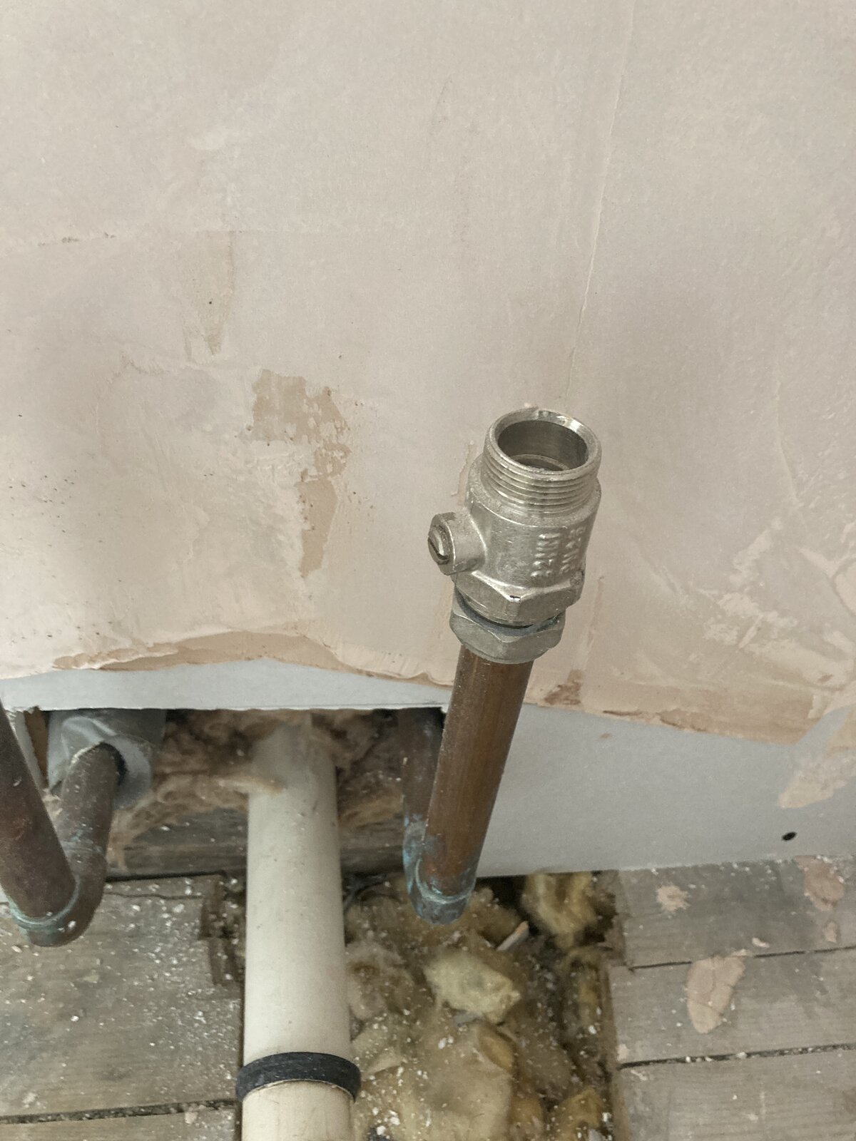

Hi all,
I am in the process of redoing my bathroom and a bit of a plumbing novice, it is fair to say, so learning as I go along.
We have a gravity fed system so I have removed the old bath, cut the pipes and added 22mm ful bore isolation valves to the existing copper pipes (compression fit). This all went fine- no issues. Photo attached.
Now I need to connect up the new bath and taps obviously. I asked the plumbers merchant if they had full bore flexi of some description and they have supplied what they told me would work fine. However, it is JG speedfit and the bore behind the push fit is ridiculously small which I am sure is going to cause me issues with flow rate? That said, I am struggling to find genuine full bore flexi, or something that is specified as such. I was anticipating having to remove the isolation valves and push fitting onto the copper pipe when connecting up.
Does anyone have any suggestions or pointers? Is there an easier way to do this with some form of thread connection at both ends? The thread on the isolation valve is slightly wider than the standard bath tap connection. or plumbers piping of some description- but then how do I get the threaded connection at the other end.
Any suggestions gratefully received.

First check the bore of the taps you intend to fit - I'll bet they are smaller than 22mm ;)
Right yes I did have a look at that- thanks. It does indeed get a bit narrower, or from what I can see anyway. It's just the speedfit ones they supplied seem to narrow quite a lot. I guess it may be ok then?

Can you not do it all in copper? Copper down from the tap, then do the final compression joint under the bath, when the bath is finally in situ.

The bath tap connections are a slightly different width apart to the copper pipes and there isn't really much movement in them unfortunately. I did see that you can get some flexible plumbers piping which I wondered was an option. Probably a silly question but if I could use something like this, how would I then get the threaded connection I need to connect up to the bath taps?
Flexible copper plumbing sticks in 22 mm will probably work for you if you can't work with rigid copper. I think some are available with 3/4 tap connector at one end ,22mm at the other to connect to your isolator.

Thanks it was whether they do a flexible copper pipe with the bath tap (3/4?) connector on one end, which I can't seem to find....
Guess you’ll have to settle for flexi’s, the ones I’ve linked and a tap connector or do it in plastic?
Get a bending spring for a fiver and a length of pipe and do the whole run in copper. It's really easy to bend copper with a spring by small amounts to get it to line up.
Add tap connectors to the taps before fitting the bath (look at hep20 push fit for the tap connectores) and then push in the copper pipe to connect it all up.

All noted thanks- didn't realise you could bend copper pipe so that is useful to know. I found a couple of Hep20 flex connectors last night that were advertised as having an 18mm bore size so I've ordered those and hopefully they will work out ok.
