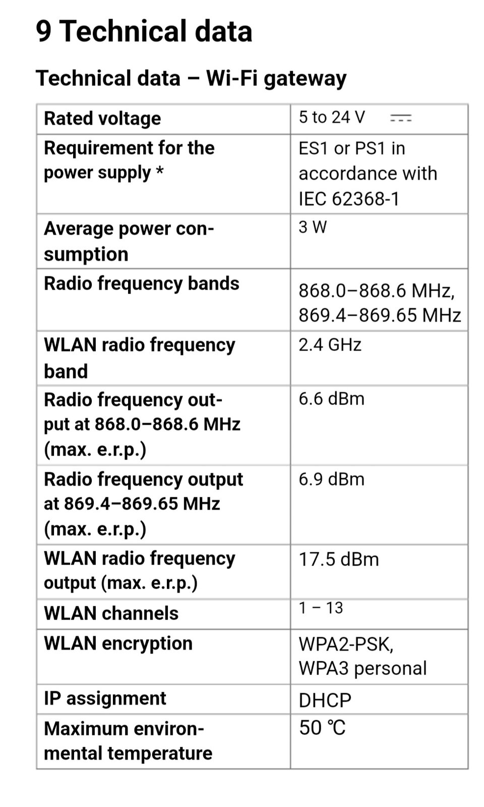

Am I right in assuming that I just need to ensure power to the unit
Yes, it needs a separate power supply.
(still to find out voltage)
From the manual, it can accept a power supply from 5 to 24V DC, centre positive...
In some countries, a PSU is included in the box (worth double checking!).
The included PSU is a 5V, 1A supply...

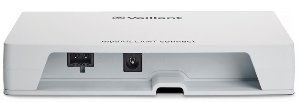

by connecting a suitable power supply to the screw in terminals,
It should have its own power jack socket; the screw terminals are for the eBUS connection.
but I believe you can have multiple connections through the ebus terminal
Yes, it should be possible to daisy-chain onto the Vaillant eBUS.
