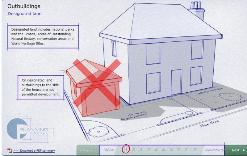

The background to this is that within a few months my area will get conservation area status. I have drawings for a fair sized out building ie approx 6.5m by 3m and 4m to a double pitched roof.
I can build this under PD but I would.have preferred to wait and see whether I actually really needed this building as it will cost me £20k and change the outlook of my garden.
So my question is does Conservation area status area have much influence on outbuildings that can't be seen from the street? In other words if I didn't build before cons area status is implemented would this project be difficult to get permission for later?

Not so jeds, you're alright if behind the rear wall of the house but no to the side.
Ok, so as long as behind the rear wall of the original house PD rights remain intact for outbuildings?

My bad for not making it clear but I recall from previous posts that indus' proposal is in the back garden. So what I should have said was; the conservation area will make no difference - to him, and assuming it is the same proposal he has been talking about for some time. Obviously if PD rights have been removed then you can't do it but that's the case whether it's a conservation area or not. And freddy is right that if it is to the side then it wouldn't be allowed.

If your house is 'side on' to the street then it maybe possible to build a huge front extension due to a loophole in the PD rules, apparently it's even possible in a conservation area.
