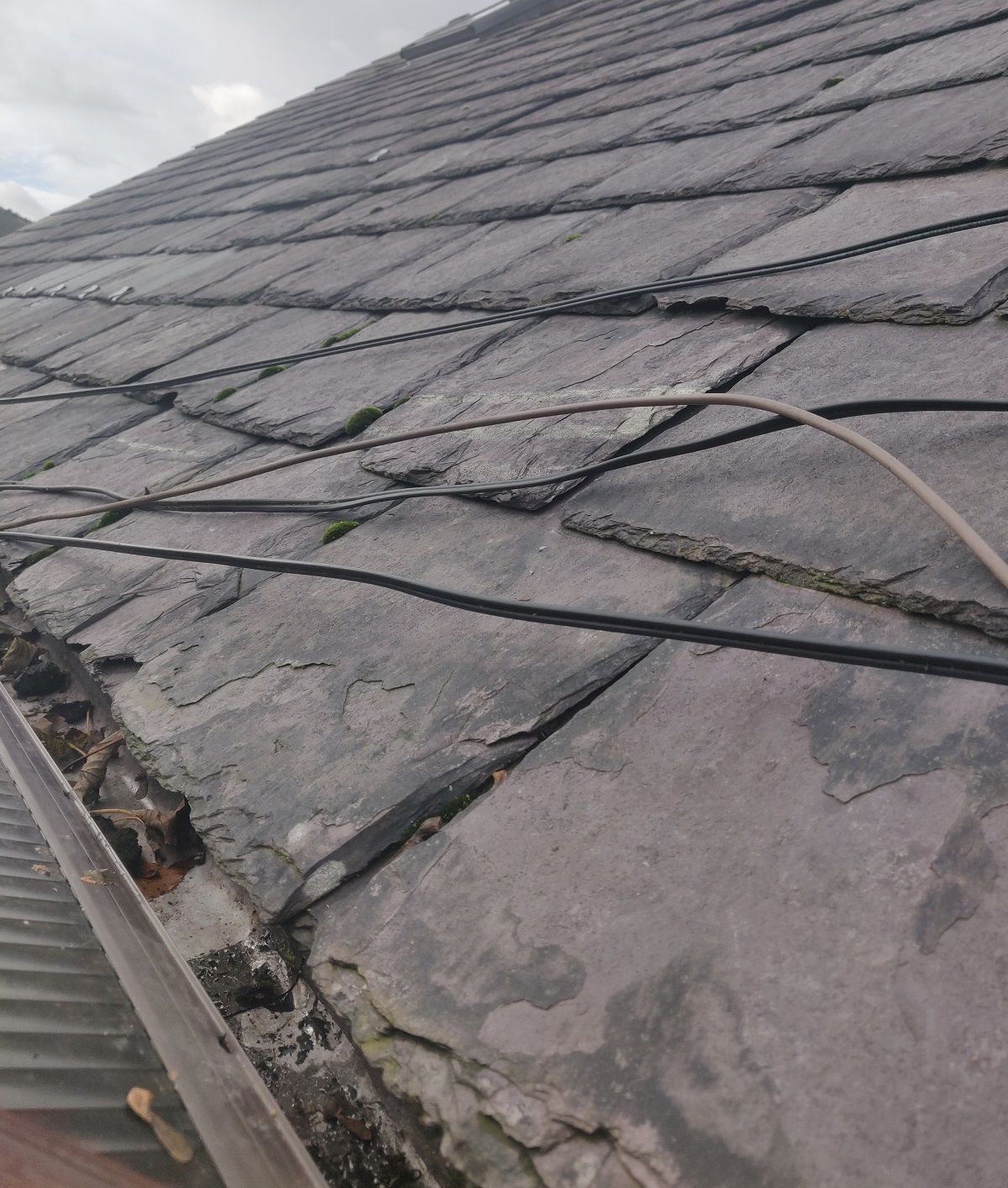

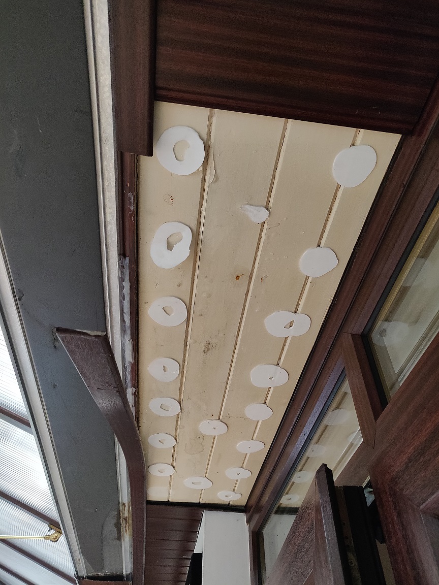

I occasionally get a leak inside my conservatory - its appears from the plastic panelling over the doors into the main house so presumably coming from the box gutter. It was doing it before the leaves started falling but we had a real downpour this week which led to a very wet floor inside so I've been up for a look and am wondering my next step. Its a bungalow so the gutter takes both roofs water, the gutter itself looks to be aluminium but not sure on age. Anyway here is a pic, the leak is located inside around about the end of the second roof panel but I know the actual leak might not be there.

I think the only way to sort out these issues and try and find any defects in the gutter is to get up on the roof and use my hands to clean and sort the wires - I've tried flicking the wires from the end but they need some closer manipulation to get them out. I'm just trying to figure out if I can get on this roof safely. I'm not concerned about the height, more breaking any tiles. Closer look at the tiles...
Is this slate? I always thought slate was a bit thinner? I can easily access it with my ladder, and if I shuffled along on my backside or all fours would it be ok? I wouldn't want to stand on the conservatory roof side unless I has some planks or something to go across the structural bits.

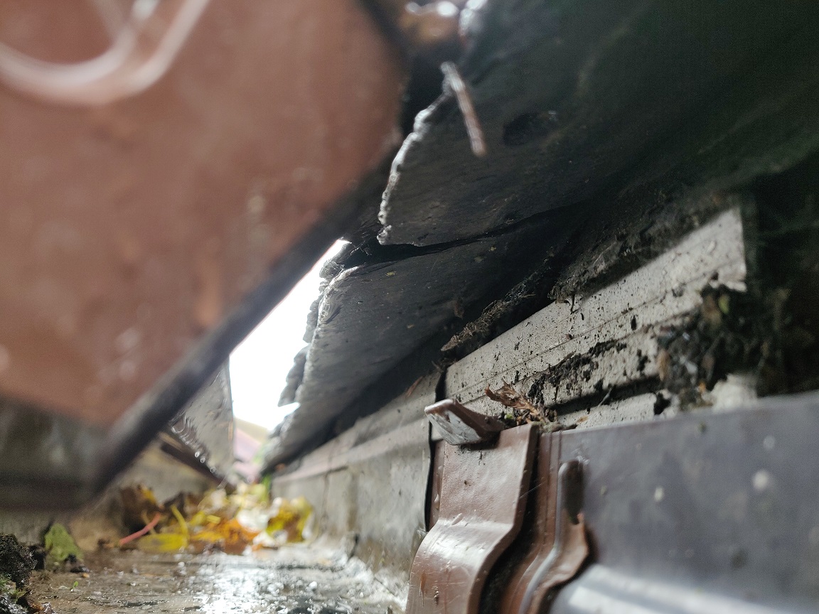

So its still dripping again today :( A few more leaves fallen but nothing to clog it up. Here is a photo looking along the gutter from the end. I think the leak is coming from the tiled roof side rather than the conservatory roof side of the gutter. The roof felt is not going into the gutter all the way along - seems to be be bits where there is none and then a section where there is quite a large overhang (maybe a previous fix?) which you cant quite see in this picture. There is about 8" of soffit between the box gutter and the house wall - there looks to be lots of silicone in there where a previous owner might have "fixed" the problem, I might try and get some of it off to see inside the eaves (I've looked from the loft side and no signs of water as far as I can see, cant see as far as the roof edge though)

There appears to be a damaged slate near the third poly panel.
Might not be obvious to all..but I'm sure it's there
thanks - can you be a bit more precise as to which one you think is damaged? Is it on the bottom row or higher up? I can try and get a closer picture if I know where I'm looking.
Nothing obvious to me higher up the roof, maybe need another check in a downpour to confirm though. Light rain doesn't cause a problem, its heavy rain that starts the drips (What I don't really know yet is how much the wooden soffit and plastic trim stems the flow of water - how much is actually sitting above the sofitt??)
Why don't you put the hose pipe in at one end of the box gutter and see if it leaks.
