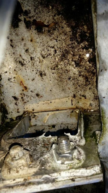

Roofer 1.) Said that the aluminium Box gutter has a broken weld between the sections just above the leak. Suggest painting cromapol around the area above and getting a conservatory trader in to reweld the joint.
Roofer2: Said that the box gutter was one piece, but suspected that the wall brackets seal (potentially underneath) may have given way, suggests painting around that area and removing all panels beneath the box gutter (inside conservatory) to see if anything more is uncovered.
So I have clambered on to the roof myself and can see the bracket he is talking about :
This bracket is a few mm higher in the center than the rest of the box gutter, so water pools here first before it gets high enough to move on. ( I saw one more of these brackets 8ft the other way)
It does indeed look like one piece of aluminium but I now believe this is sectional and is welded together underneath this bracket.

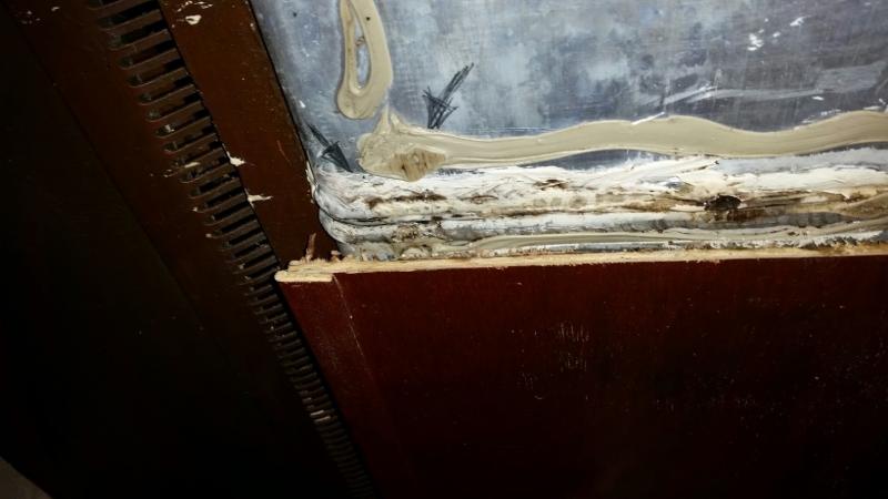

I have cut and removed the wood surrounding the box gutter (inside conservatory) and I appear to have found the leak.
It appears to be coming from in-between the join, I have marked in pencil with area an area of where I can feel water (its the section after the white gunk, but i couldnt draw on this area) It feels wet along the whole of that same line, which looks to be a gap between the 2 sections of gutter. I can see what looks like weld marks so I am presuming they weld the 2 sections together?
I believe the area where the leak is, is directly under the bracket, so I was going to put cromapol all over this area to at least hopefully fix the leak.
My questions are if any one has any experience here:
1.) can any one help/confirm the diagnoses of the issue here
2.) What kind of specialist I need to rectify this
3.) Cost
