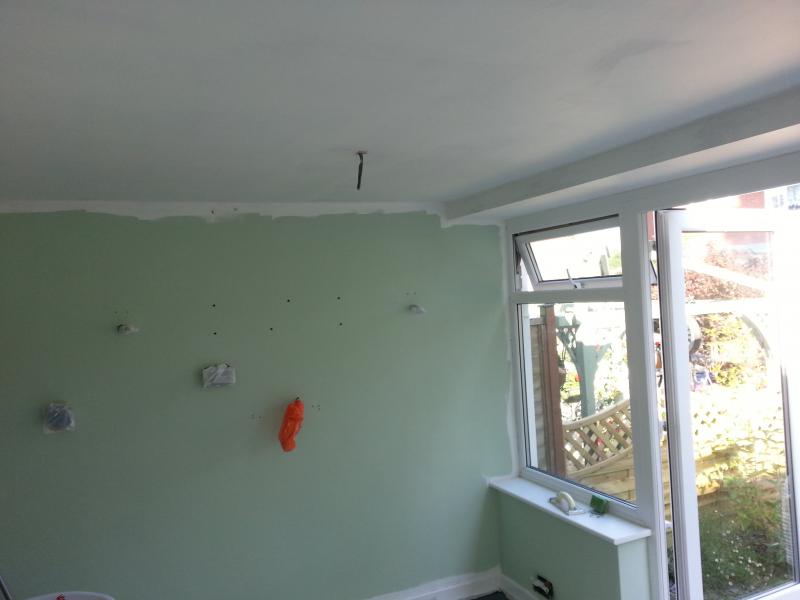

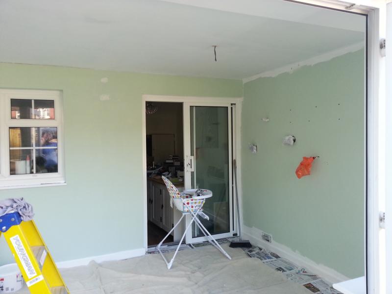

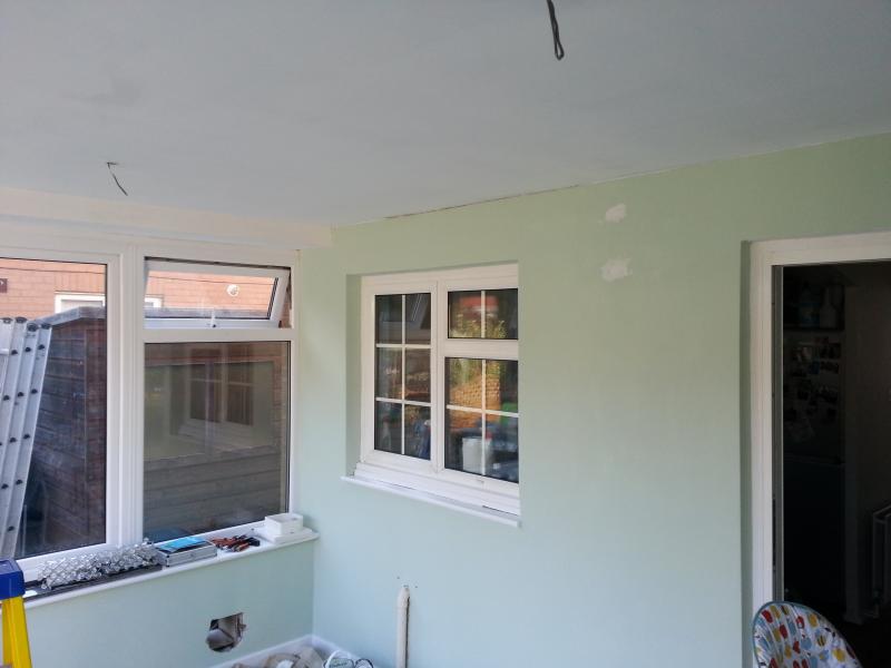

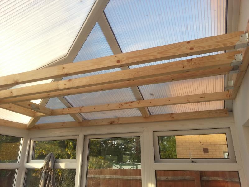

The conservatory was put on the house by the previous owners and we have lived in the House for 7 years.
In those 7 years it has really just been a dumping ground / utility room / dining room etc.. but due to do it being too cold in the winter we have never used it as a room.
I decided I wanted to make the space into a play room for my 7 month old son that could also double up as an entertaing space.

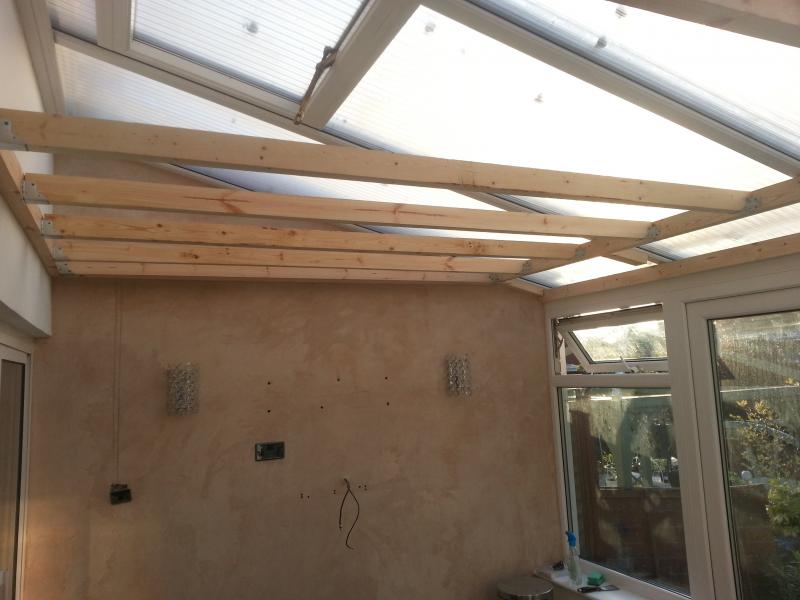

The conservatory is made up of a polycarbonate roof with 2 dwarf walls, a full height side wall and the back of the house wall.
The approx size is 3x3.5m.

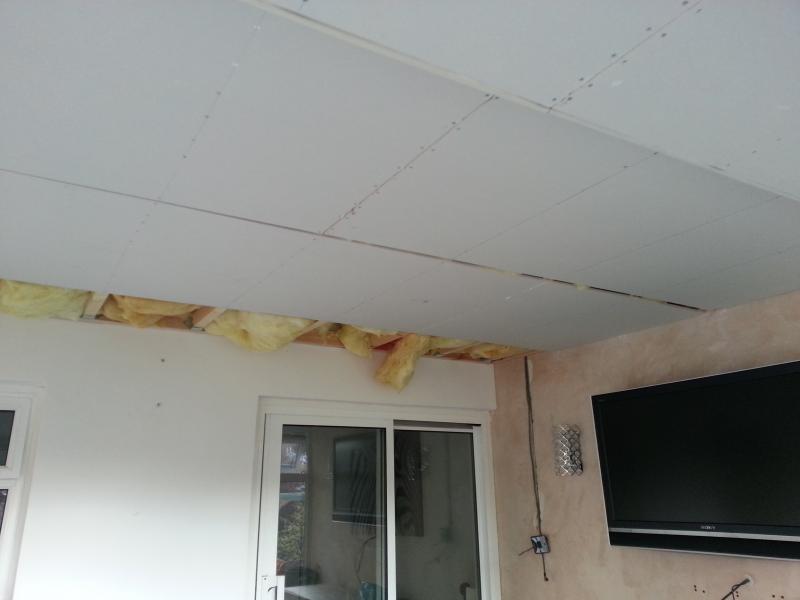

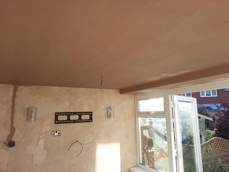

I was unsure of what materials to construct the ceiling from and I wanted to keeps as much weight off of the roof bars as possible.
I watched quite a lot of videos on Youtube and looked at several websites of companies who will put ceiling in a conservatory and thought I can do this myself at a fraction of the cost.

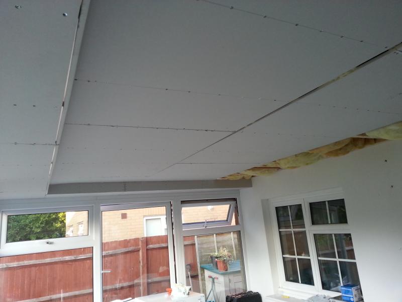

I was originally going to use a steel MF suspended ceiling system but that would have been suspending the channels off of the roof bars and I didnt fancy doing that so in the end opted for 3x2 timber with 1 layer of 12.5mm plasterboards and 200mm of Glass Fibre insulation above.
I did think of using spotlights but opted against as i would have had to clear to much of the insulation around them so decided on a standard ceiling rose instead.
Here are some pics of the progress. The ceiling is up and plastered, decorating the room is in progress and I will be building Storage seating next week (hopefully!!)
Forgive me, but I don't see a vapour barrier in there, to stop moisture from warm air in the conservatory condensing in the insulation and rotting the timber ... and is the space above the ceiling ventilated?
Cheers
Richard
There is no vapour barrier.
Ventilation cowls will be going into the poly roof. not sure how many yet but i would say one in every poly panel

Do it myself - £130 so far in materials and £150 for plasterer.
I'm not at home in the daytime but my wife tells me it is cool in there during the day as wheras before it was like an oven when the sun was beating down on the roof.
After the Bench seating is built I will need to look into heating for out there. Cheapest option will be an electric radiator but other options are Electric underfloor heating or bring a radiator in via the central heating

For air flow there was mini trickle vents underneath the polycarb I just drilled many many more holes all around to maximise the air flow.

Where would you put the vapour barrier ? Would you put it on the underside of the conservatory ? Like the foil quilt , then plasterboard like he has done ?
