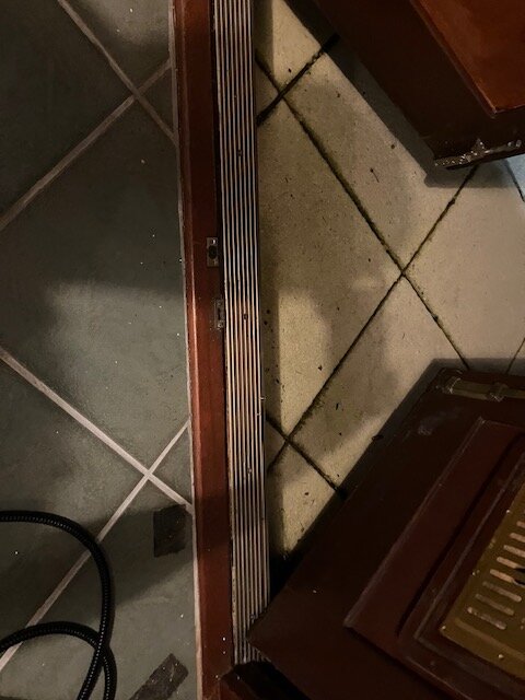

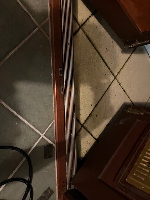

Hi all,

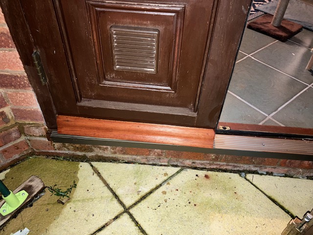

Desperately trying to resolve an issue. Conservatory door's are somehow collecting water under the door's causing water damage to the wood and it has caused it to rot. I fitted the runaway section last week but after raining today, it has made zero differnce.
As the outside picture show's. There is a wet area from the guttering which has a slow drip but i cannot see how it would hit the door frame?
Any idea's would be greatly appreciated

External level far too high , probably breaching the dpc and rain will splash up the door .
Do you mean the external frame above the brick? We only moved in last July. Fairly older property do you think it’s been an ongoing issue ?
What would be the best way to resolve this ?
Ouch, not a cheap one then! But i have no other option other than continue to cause more damage. Thank you for the help Fox ill look into doing this
