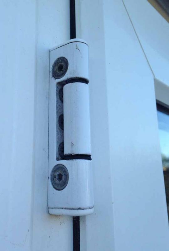

Tomorrow in good light I will show a photo of the hinges that are fitted if you could advise.

OK not exactly a flag hinge but a mila rebated butt hinge, but in any case put Allen key in those 2 holes and turn and watch the hinge move sideways
They only turn 180 degrees so you can't get in too much of a mess but yes try and equal them out
