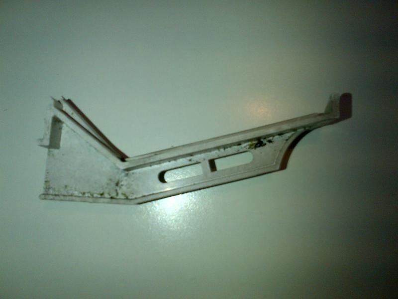

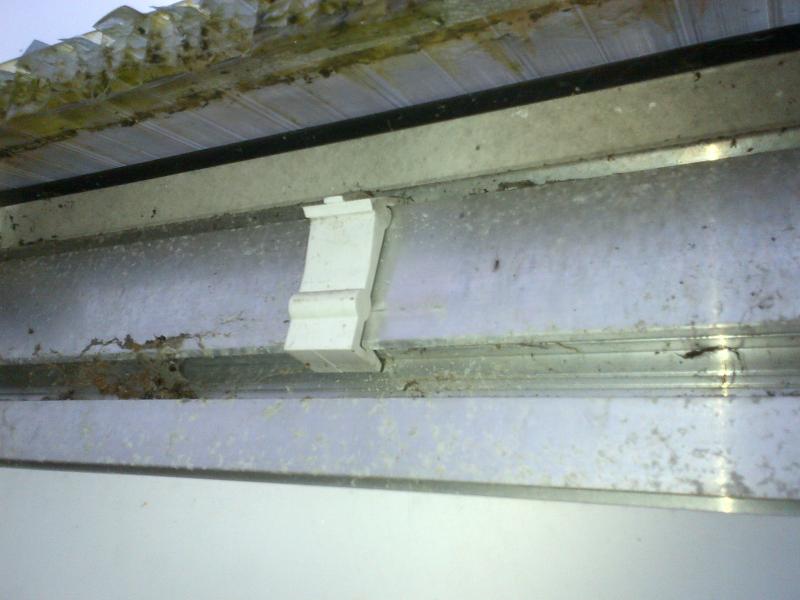

Hi everyone, I'm not really a DIY-er... I did manage to fit some Solar Shield inserts in my conservatory, but during this process, I also succeeded in snapping every single conservatory guttering bracket.
I have no clue where to buy the replacement ones. A few Conservatory show rooms I visited didn't seem keen on helping out.
It also looks like the brackets 'slide onto' the conservatory before the being assembled, so I'm unsure if I can even fit any brackets.
I've added some pics below - any suggestions would be useful as I need to get it fixed before winter.

these are "k2" gutter brackets and are readily available off ebay they hook on at the top then snap on the bottom fit every 70cm the gutter hangs on the front then clips in at the back
