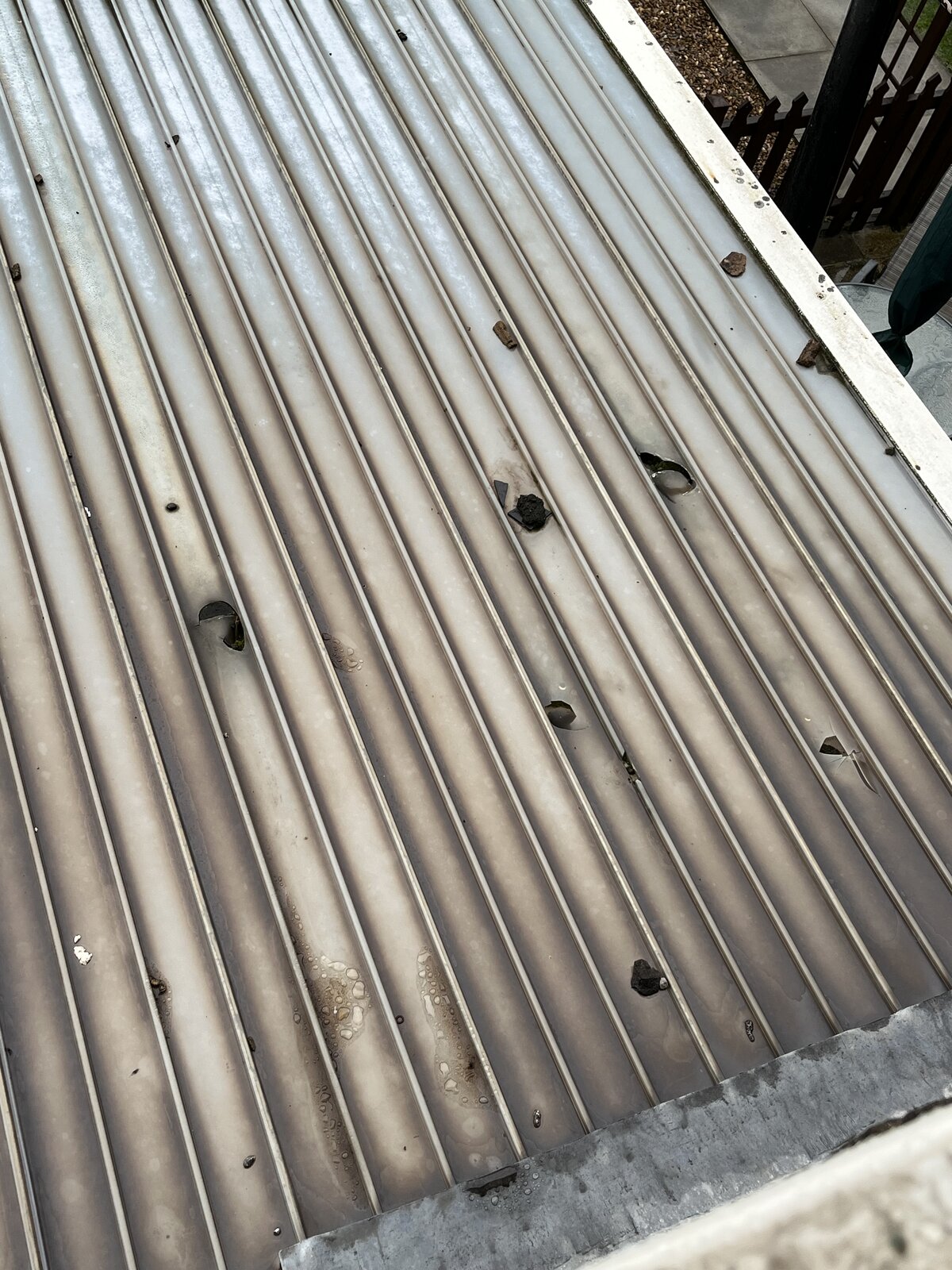

I have a few leak in my lean to conservatory. Ive taped the area where it connects to the main building which has stopped leaking. What is the best way to repair without having to re do the roof. Is it possible to cover?
If you are not bothered what it looks like you can buy a tin of acropol, it comes in black white and grey.
I would get a large plastic milk bottle and cut some plastic patches to go over the holes , and then paint over with acropol.
