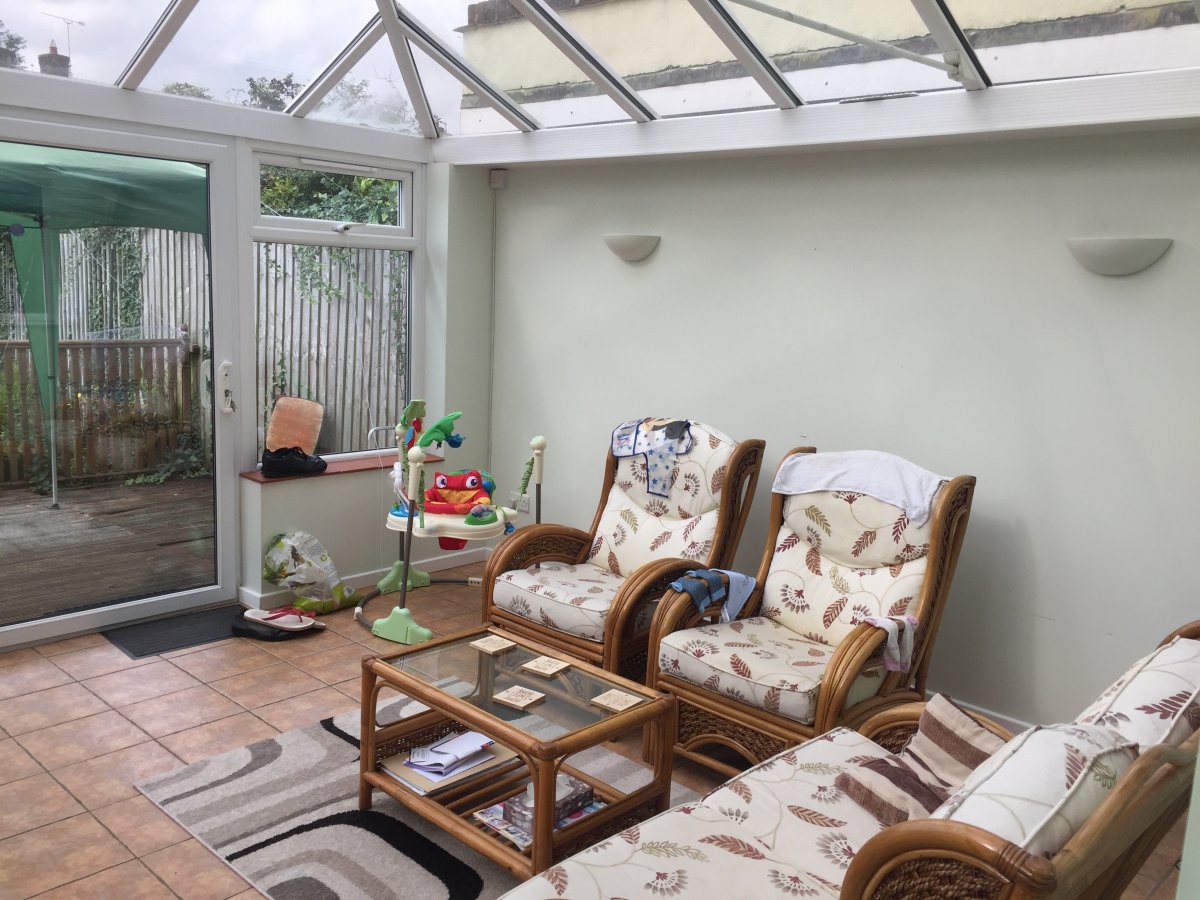

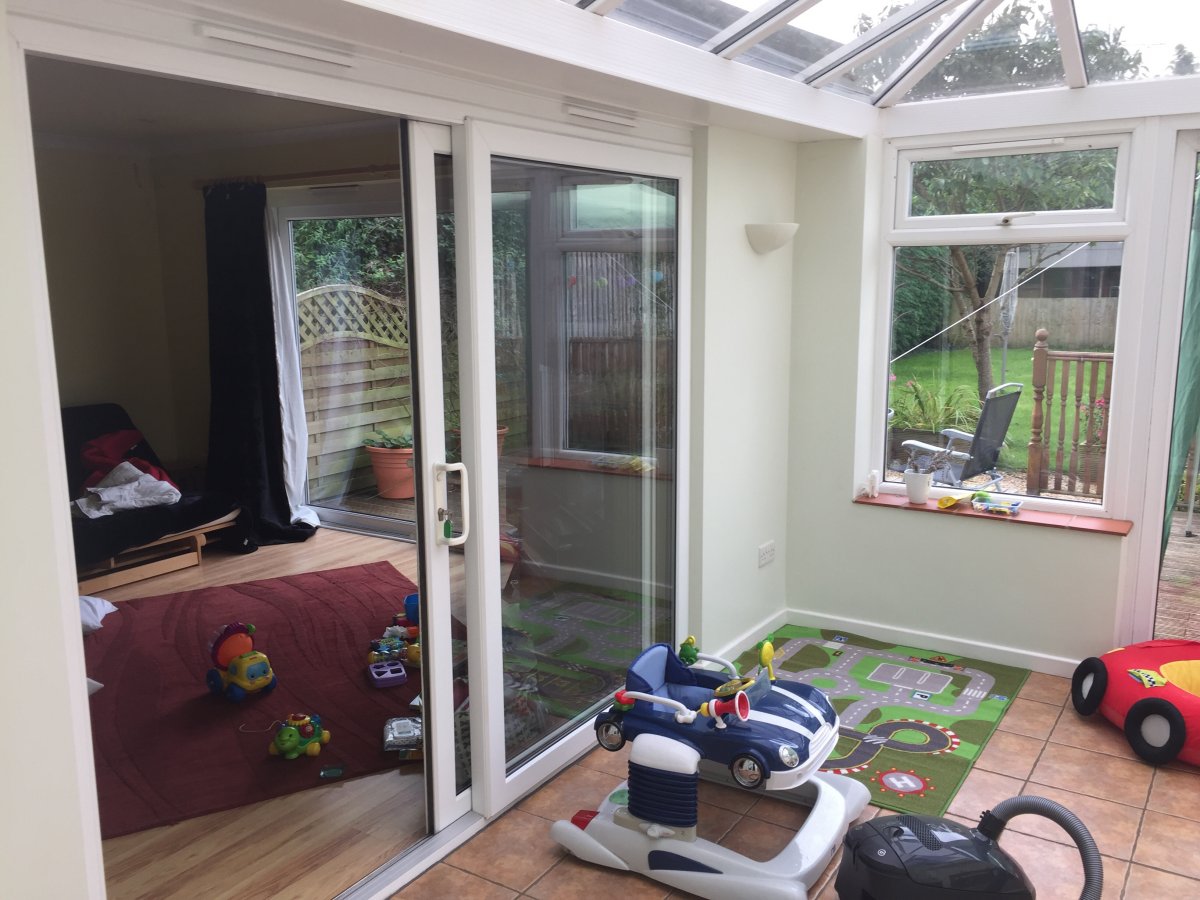

Hi all,
I have a 3 bed semi which has a single storey extension (lounge) on the back behind the integral garage and a large (16x16ft) conservatory adjacent. The lounge can only be accessed by going from the kitchen via the conservatory. So it's all kind of open plan in an L-shape but can be closed off by sliding glass doors. It's an unusual set up! The conservatory has a solid wall on the right side and large windows and a sliding door on the front.
Hopefully you can see the pictures uploaded (try to ignore the mess!).
I'm wondering if this would be classed as a conservatory or an extension? And if I could replace the glass roof with a proper roof. Basically make into a proper room. It's only because it gets so hot in the summer and I'm guessing cold in the winter. However it does have underfloor heating.
I can't seem to find any information in the paperwork from solicitors about it. I know I should have enquiried before buying but was going through a crazy busy time and completely forgot.
Any opinions or guidance would be appreciated.
Cheers in advance.
Aaron.
That conservatory is a conservatory. Changing conservatory roofs to solid insulated roofs are all the rage at the moment. Which type and method depends on how the roof can be supported, but its possible.
As soon as you take those doors off between the main house and the conservatory or have the heating working in conjunction with the main house system, then it becomes and extension, and b/regs should apply. Whilst this may only really affect you when you come to sell up, its work checking with your insurers to make sure you are correctly insured and the risk is reflected in the premium.

If the heating has its own control which can switch it off from the main system, then it will conform. Normally a termostatic valve or room thermostat will meet this requirement.
It does have a thermostat but it doesn't seem to separate it from the rest of the CH. I always have to stat on off or 0 and control it via the lounge, however the underfloor heating still come on in the conservatory.
It's all very confusing!
its possible it pre-dated the requirement for door and separate heating, but looking at the pictures, I'd suggest it was built to comply.
