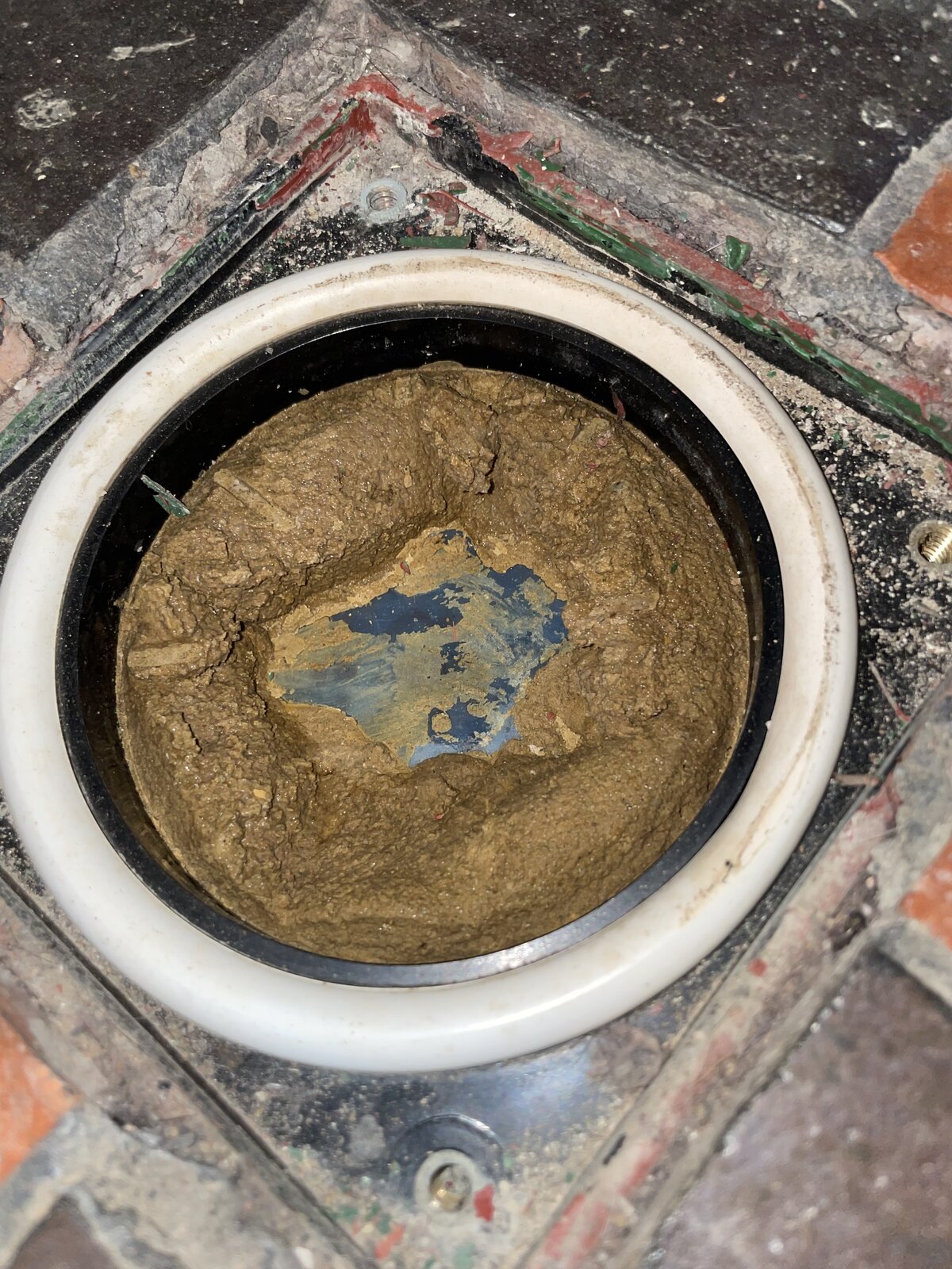

Hi guys, looking for a bit advice please!
So I’m selling my house, it’s a grade 2 listed cottage with a conservatory build on the back, there’s all the correct listed buildings consent for the conservatory which was built in 1996.
My issue is it was built on top of a drain. I understand the rules were different back then so the drain was probably the home owners responsibility as opposed to the water board.
There is what looks like an inspection chamber in the floor of the conservatory, I opened it up but it looks sealed, probably to keep any smells out ect.
Do you think this could cause any issues with my sale?
Thanks in advance!

Does anyone else drain into it? If not its yours to do what you please with?
Well according to the plans they do yes, I don’t know if they diverted at all though. I don’t want to open up the inspection chamber to have a look as it’s got an odd cement / plastic seal on it and I won’t be able to seal it like that again…
This is under the inspection cover, the bit in the middle feels like a very thin plastic membrane, some sort of cement swirl on top, bizarre.
