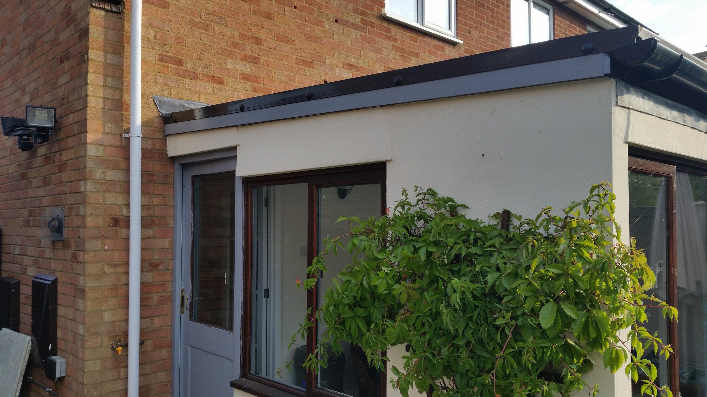

Then it came to the conservatory which I had painted - the room basically went down to outside temperature in the winter. It had a poly carb roof and part blockwork, part glazed.
This is how it stood:

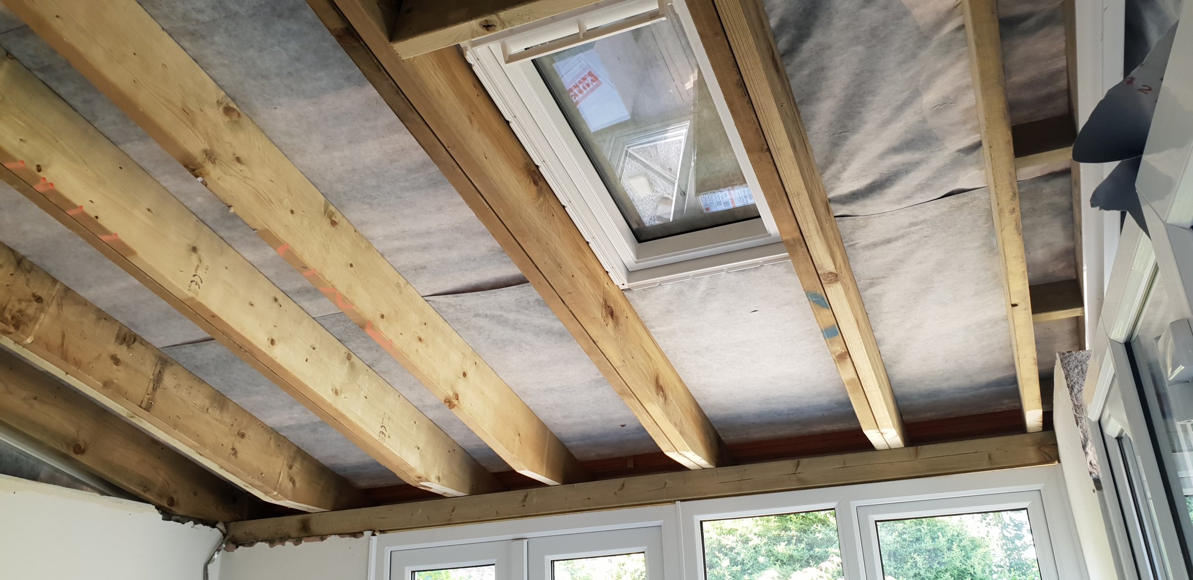

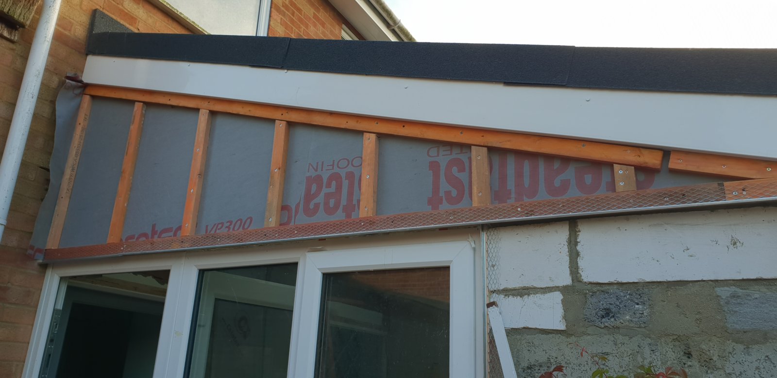

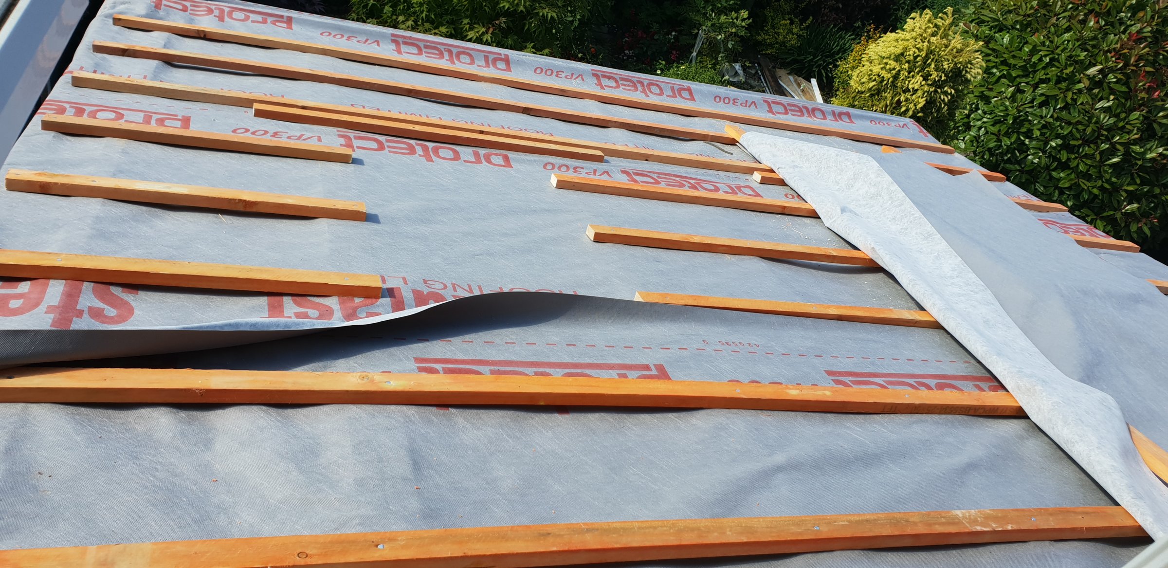

After taking inspiration from @sh4d0w thread https://www.diynot.com/diy/threads/operation-conservatory-modernisation.457524/ I made an application to building control for replacement of the roof to lightweight tiles and two velux windows. The inspector was happy that the existing structure would take the additional weight and specified 6x2 joists with two 4x2 doubled up for lintels. My dad was able to obtain 9x2 at a reduced price off site so they were used to save money. The roof would be insulated with 100mm celotex between the rafters and overboarded with 40mm celotex. The pitch of the roof would be 16 degrees, which is within the specs for the velux and tiles. This would obviously leave a void from where the old roof sat on the walls - this would be filled by a wooden frame, membrane and plyboard, with 100mm insulation between studs.

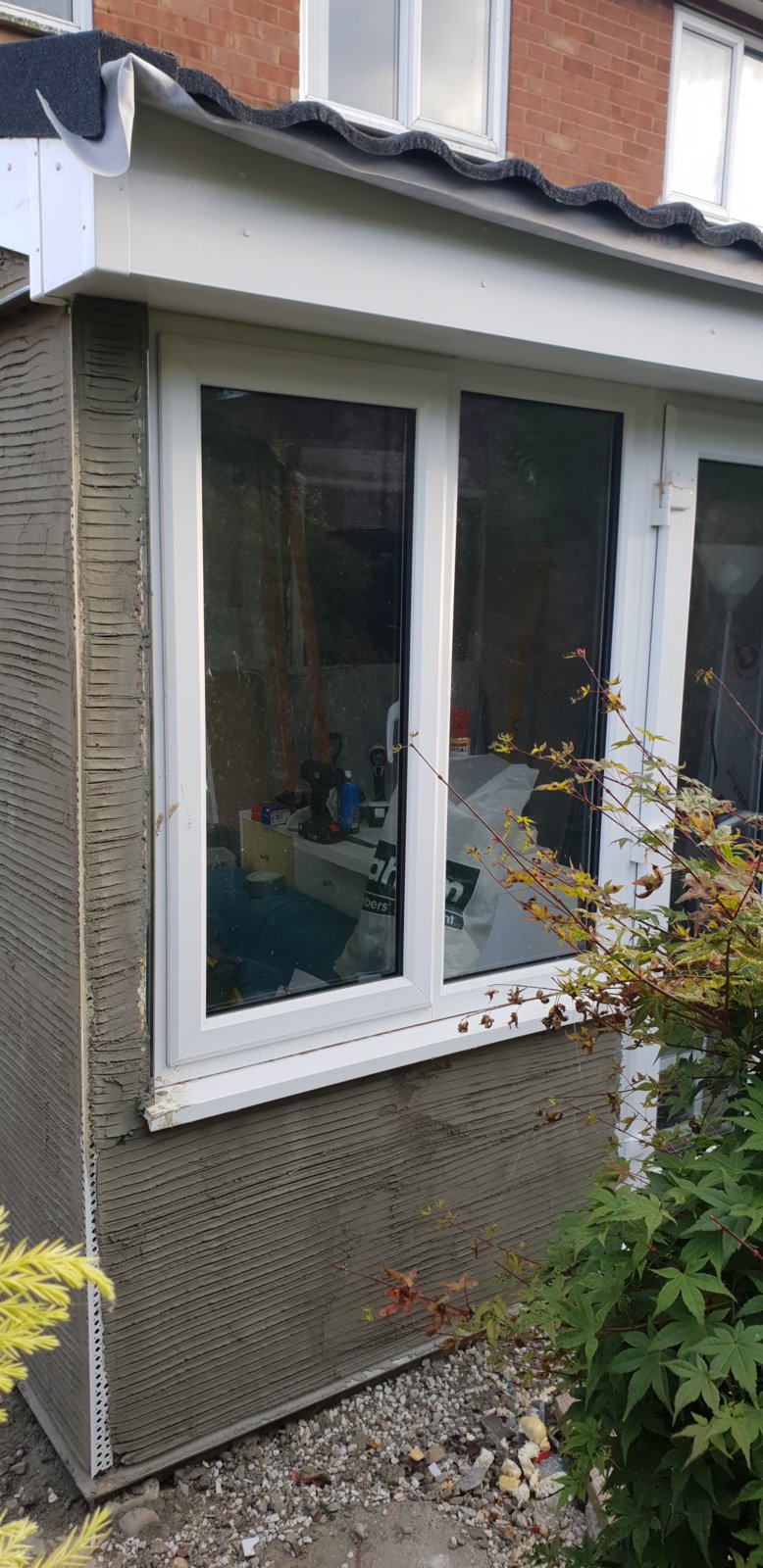

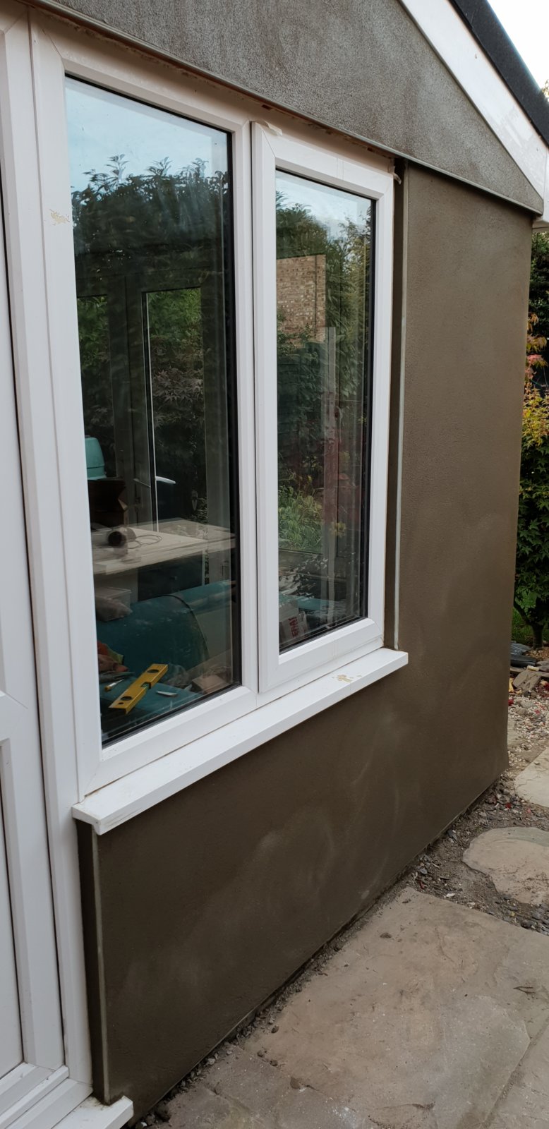

Additionally I planned to strip the internal render and replace with 25mm celotex and plasterboard.

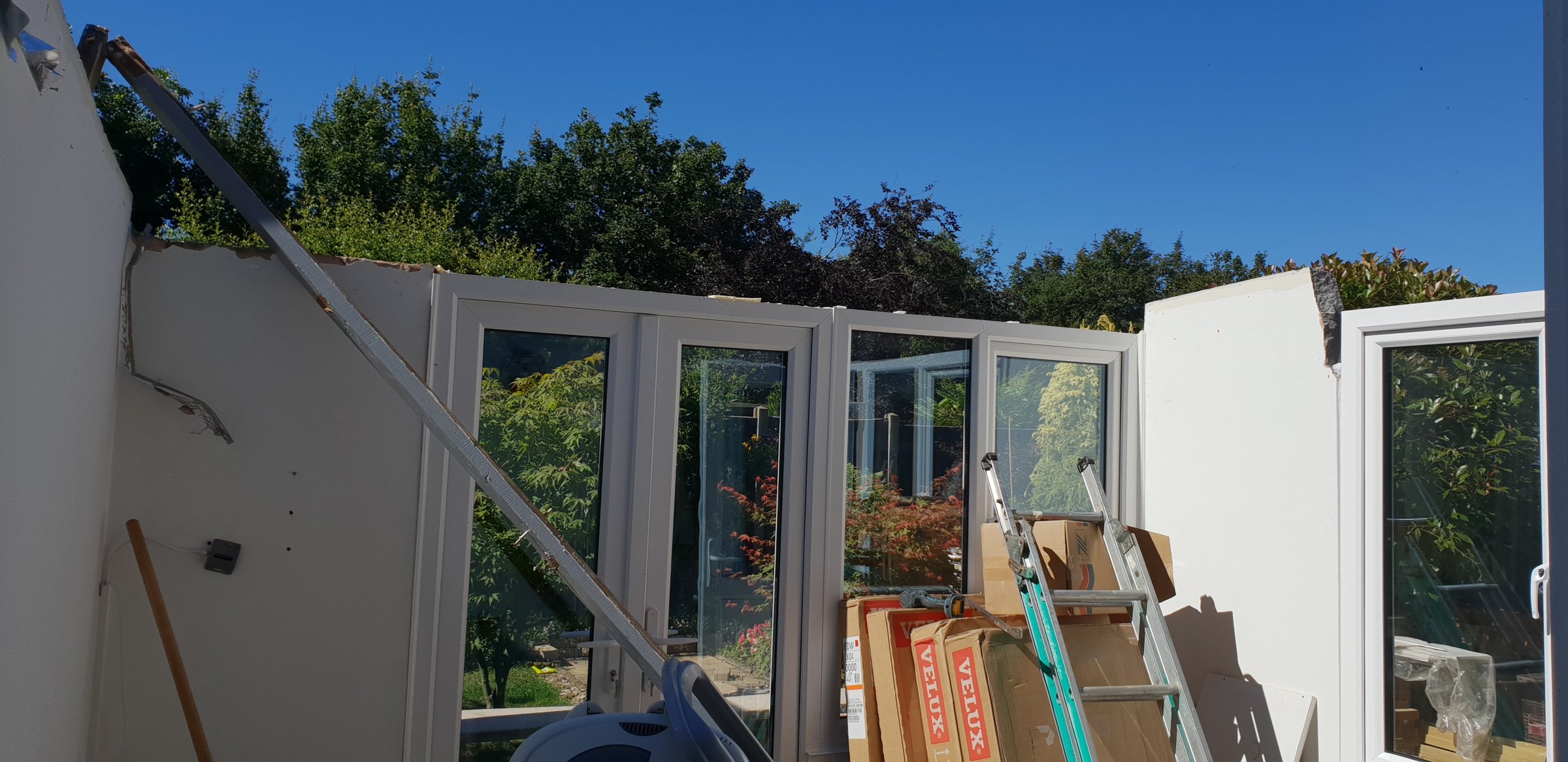

Roof off:

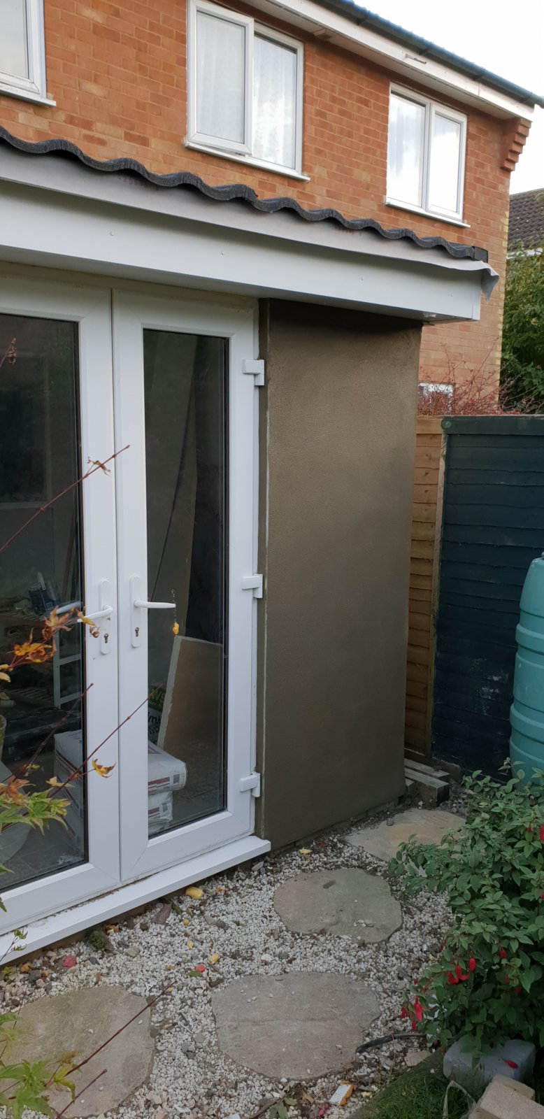

Membrane, velux and tiles on:
Wooden frame on top of existing wall:

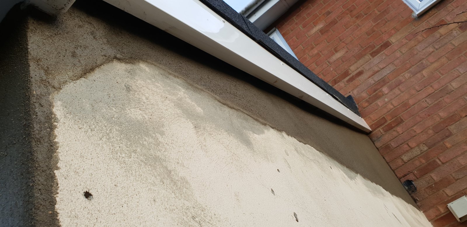

I also fitted a 70x70x8mm steel angle accross the roof supporting wall to stiffen up the 4x2 lintel. This wasn't required as a rectification, however the BC officer suggested it may be beneficial.

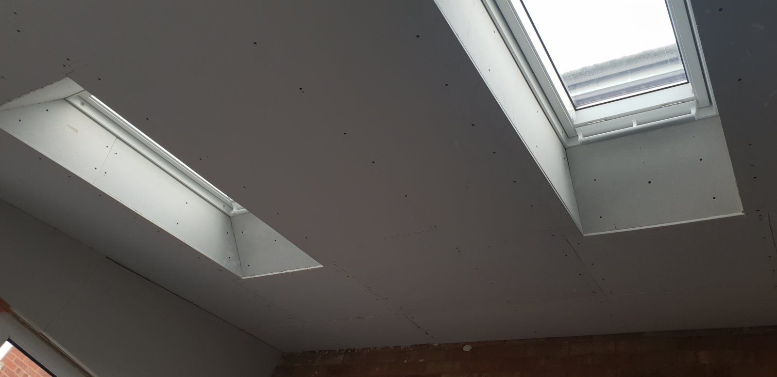

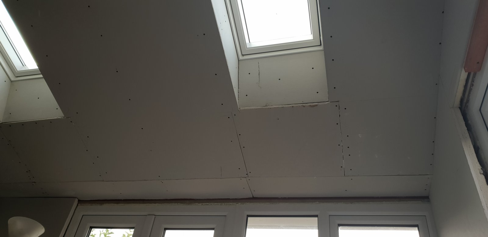

Roof insulation going in:

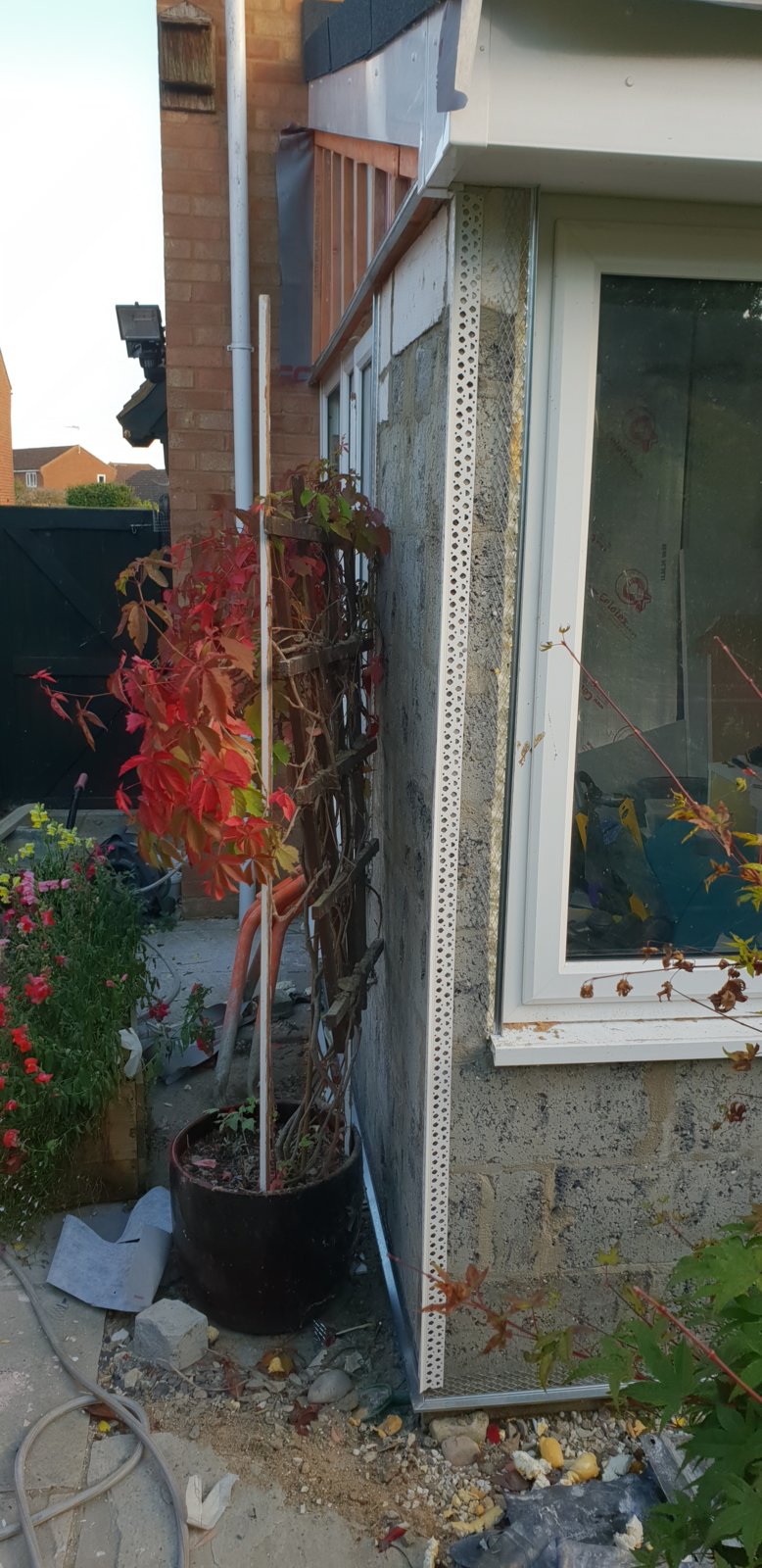

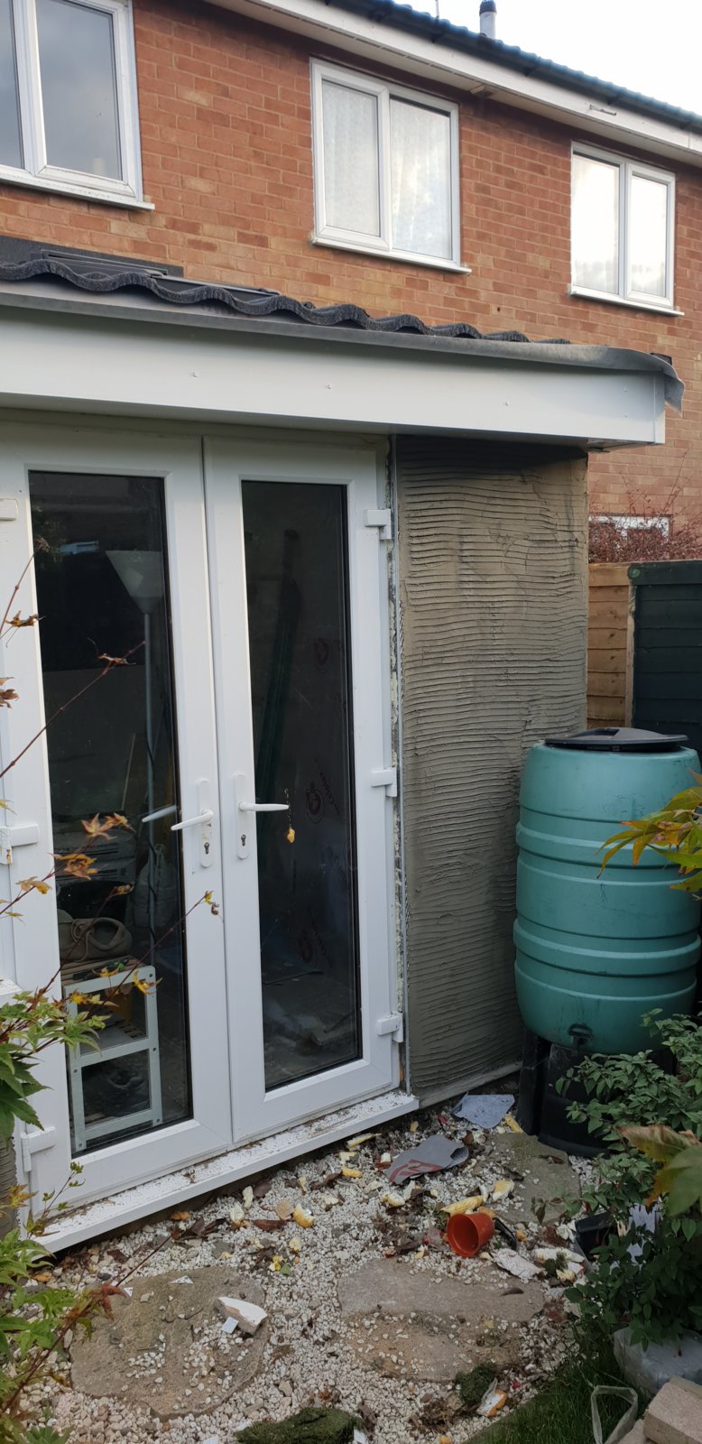

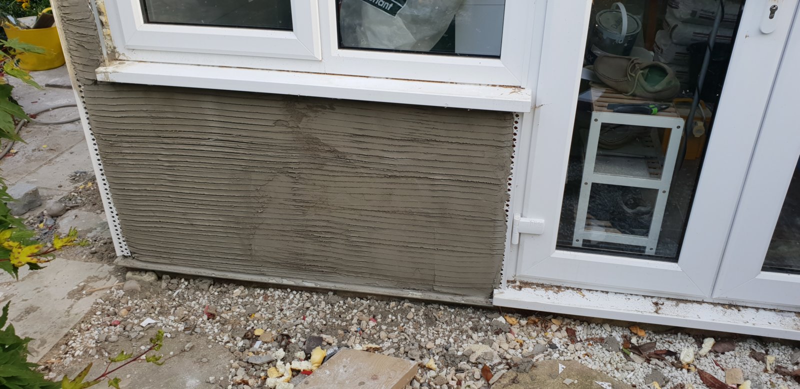

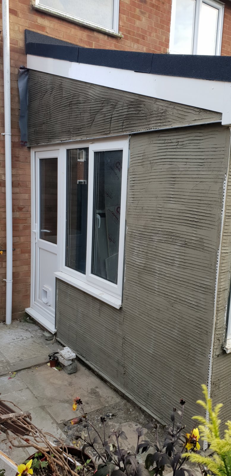

Internal render stripped off blockwork:
Wall insulation:
Current Position

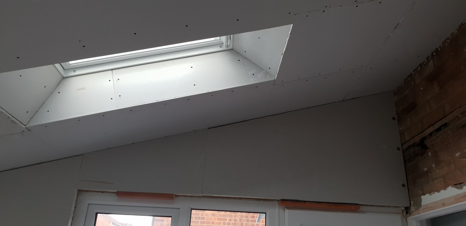

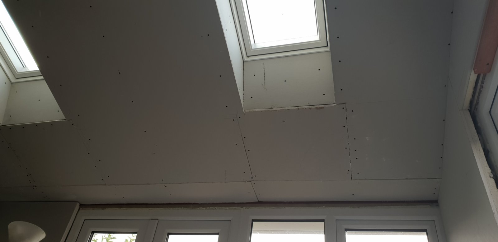

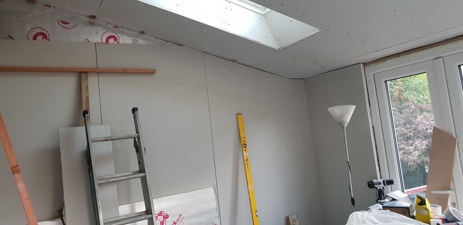

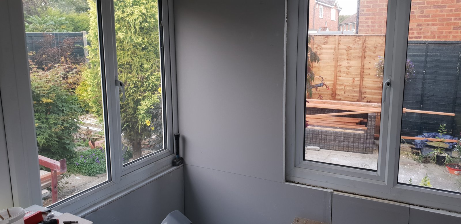

Ceiling has been boarded and walls insulated, currently plasterboarding the walls.
The work so far has made such a difference in both temperature at night and also the sound level from outside.

Cheers. I underestimated how much work was required, it's taking absolutely forever! But then I guess apart from the blockwork, it has been totally rebuilt!
Yeah that was another reason I've done it, the rain made a right racket on the polycarb.
Ceiling boarded and walls in progress.

Isn't 9 x 2 a lot heavier? Will the extra weight be an issue?

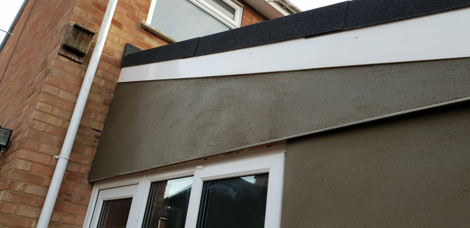

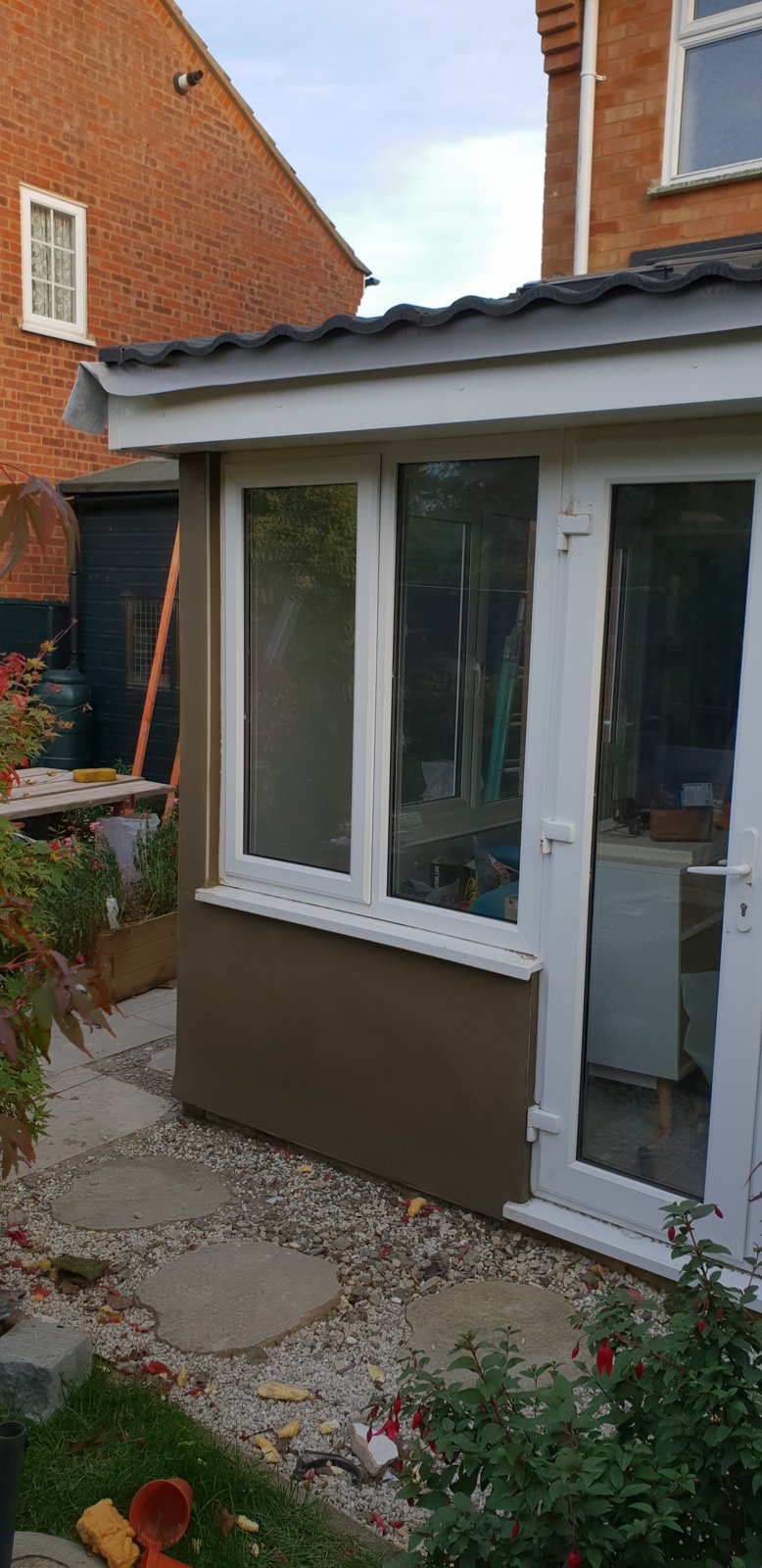

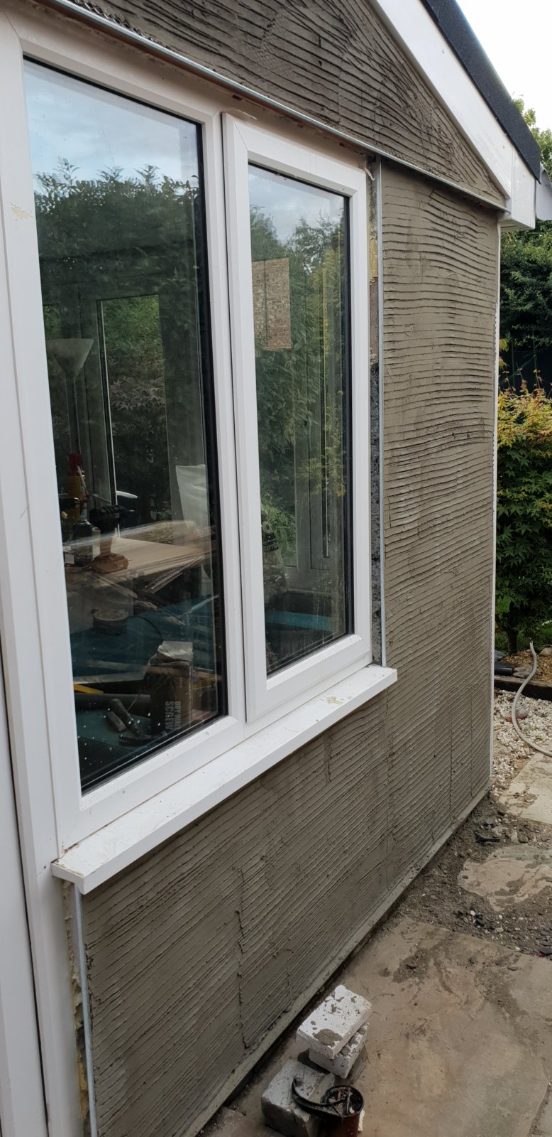

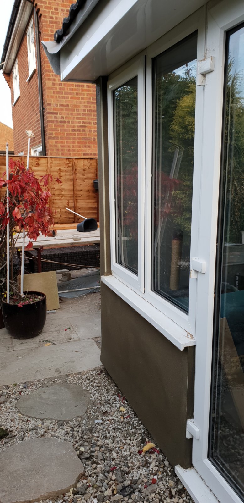

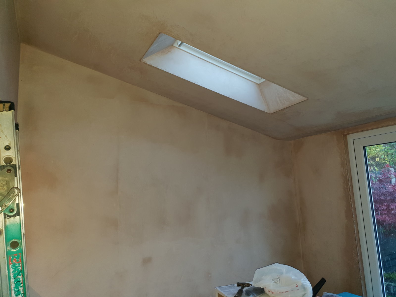

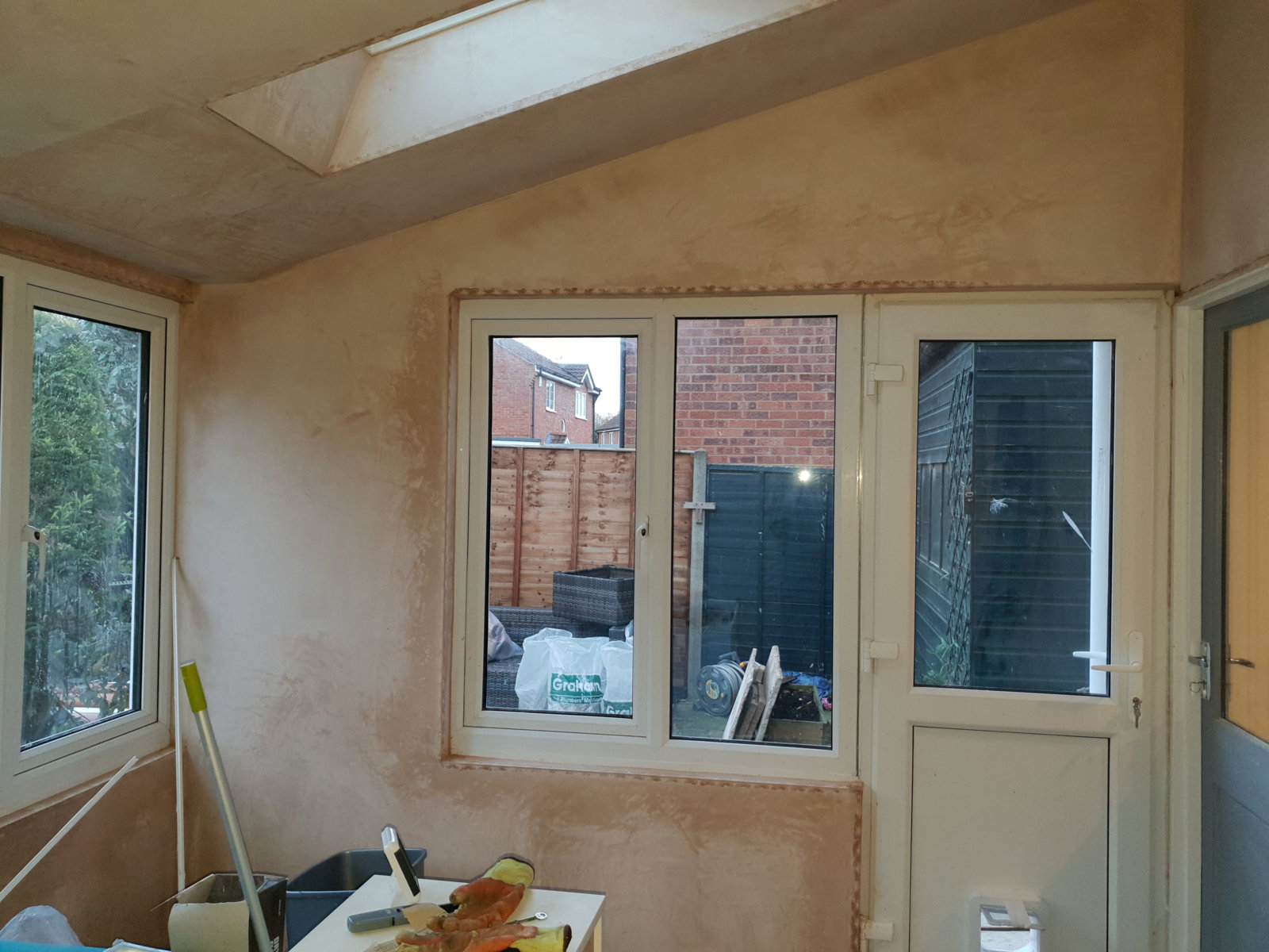

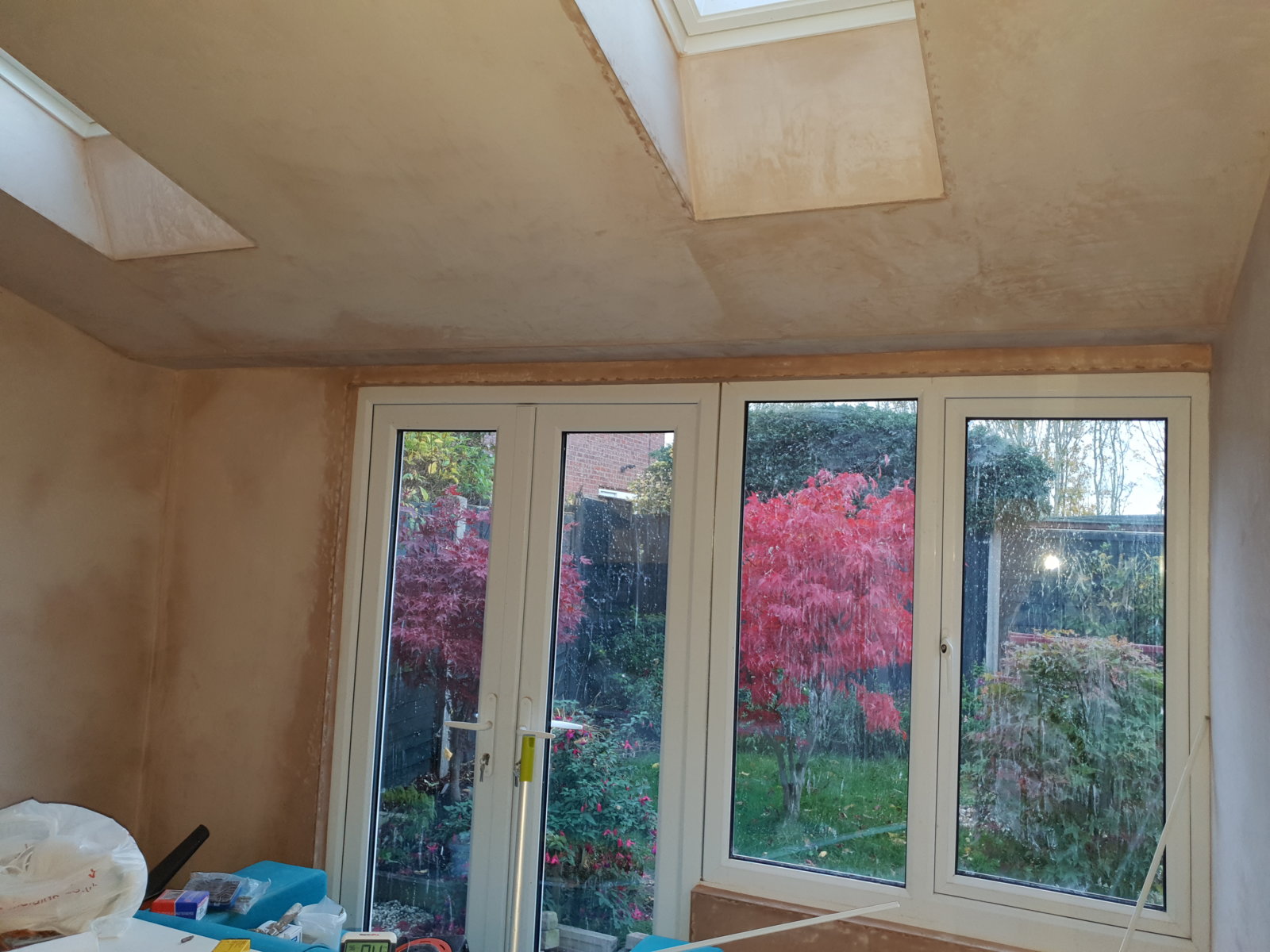

Plastering all done, taking a while to fully dry. Really impressed with plasterer's work.

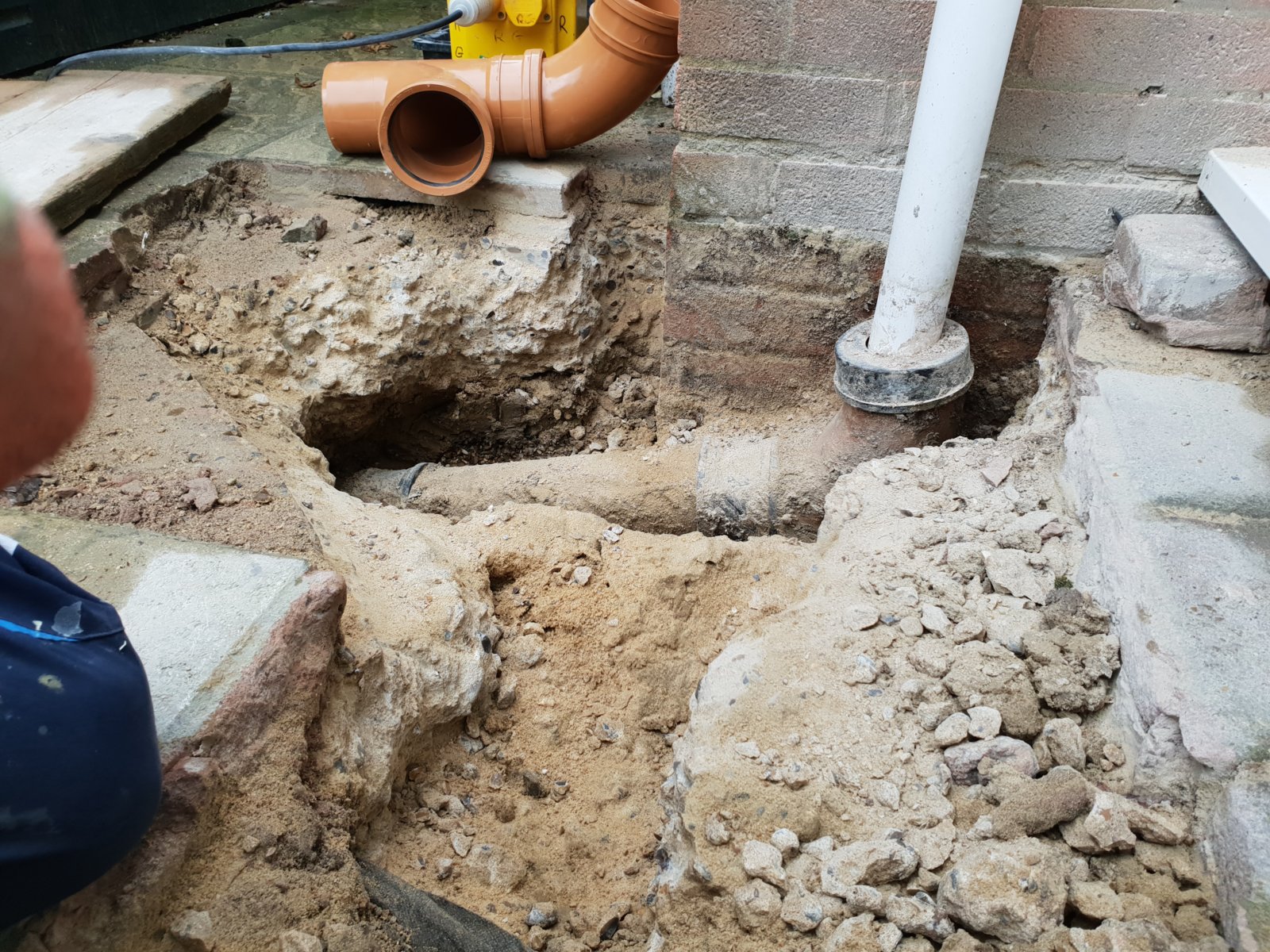

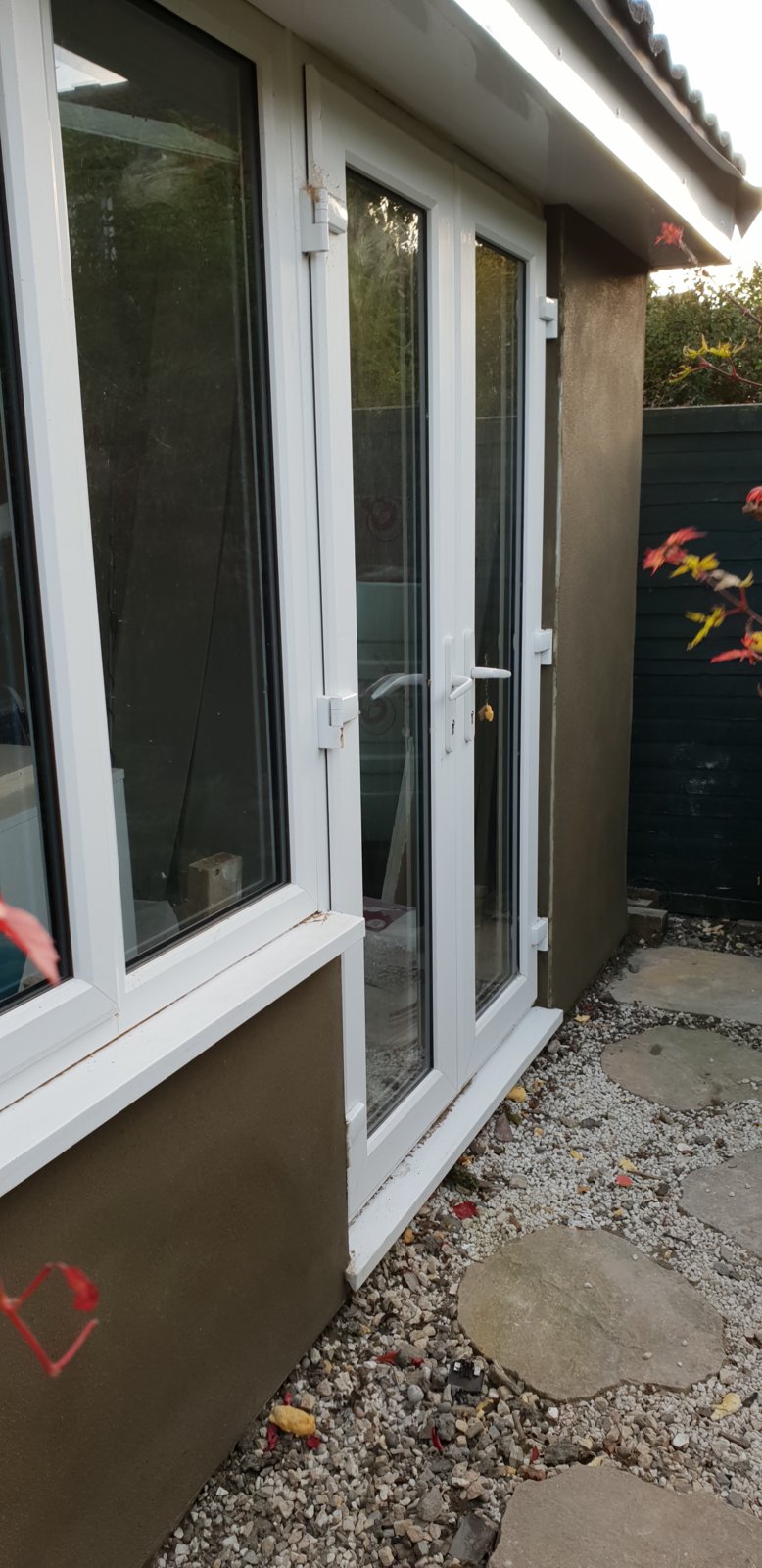

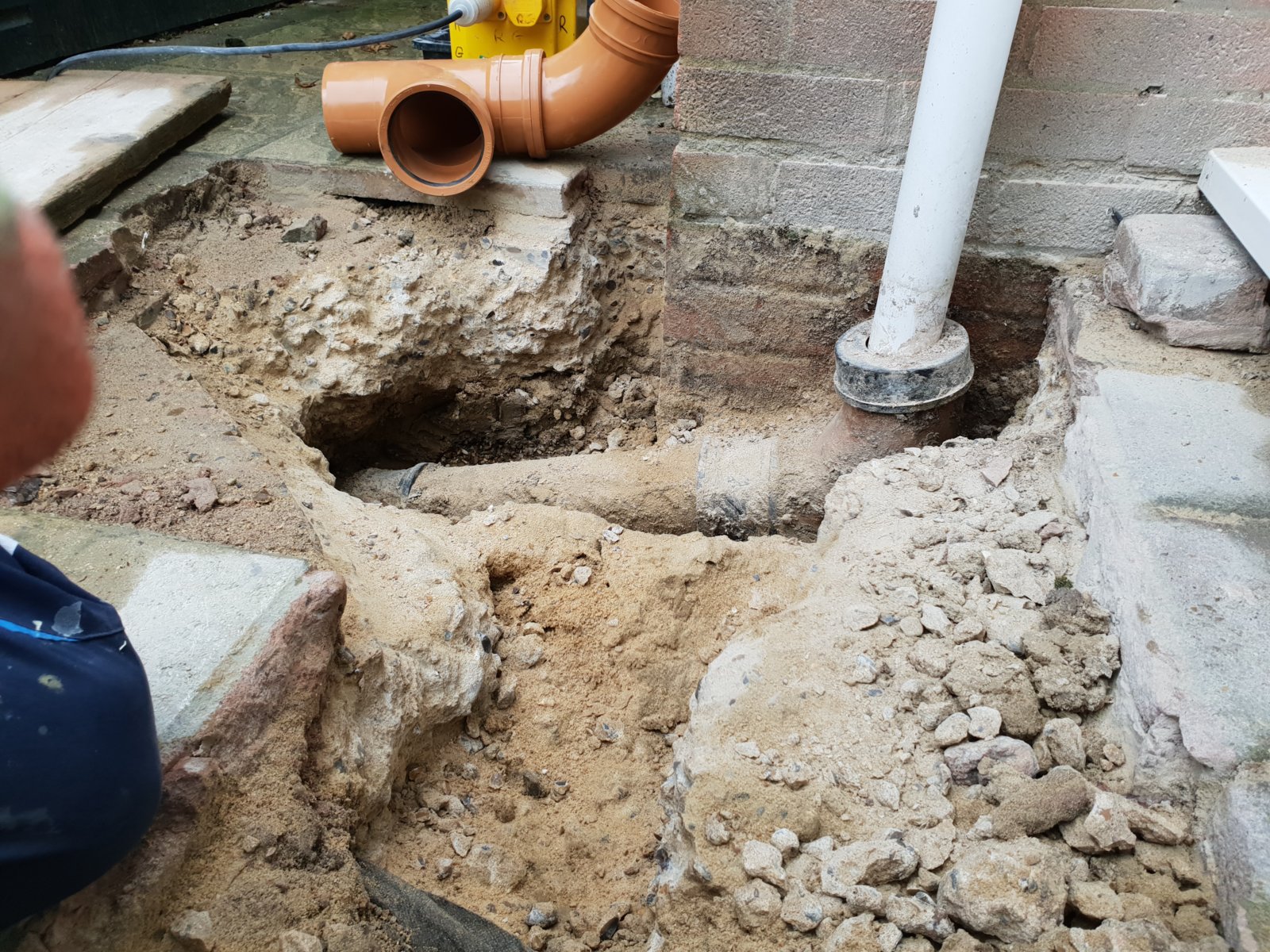

Last big job is to connect rainwater drainage to the existing pipework. Eventually uncovered the pipework coming off the house, it was under slabs, and then 8 inches of solid concrete just need to replace the uncovered section with a T piece, and then dig a trench for new pipework. An additional hitch was that the existing pipework is clay, new is plastic, so had to buy an adapter.
you are getting on there...i suppose connecting to all underground stuff will present some surprises
why is the downpipe at an angle different to the old socket...i guess it has been unattached
the new fitting...is 22.5*? will it need some fiddling to get it to fit the vertical downpipe..
