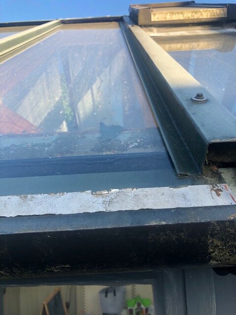

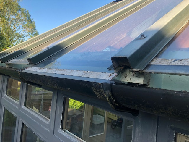

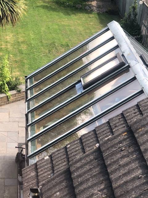

Hi There,
I have an issue with an old conservatory roof panel, the top part of the unit has slipped down leaving a gap at the top allowing dirt/debris to get inside. I am aware that if the whole panel slips you can push it back up/secure but in this case its just the top sheet of glass, the bottom part of the unit is still in place (its held secure as it buts up against a wood frame).
Is it possible to lift of the top sheet of glass, clean underneath and replace? Or is this somehow bonded together as a complete unit? Do I need to replace the whole thing?
Many Thanks!

It is a stepped double glazed unit
And it's well and truly broken down....not surprising given the slippage.
It needs replacing
Can't make out if its single or a double glazed unit, if single it just needs pushing up and anti slip brackets fitting at the ends of the rafters but without knowing the make of roof you'd have to cobble something up. If its a double glazed unit then the outer pane has come away from the spacer bar and has slipped quite possibly because there IS an anti slip bracket fitted but only the inner pane is resting on it allowing the top one to slide, if it was a stepped unit to start with it would probably explain why the inner pane was the only one being supported with an anti slip, if its a unit then it need a new one
Definetly a stepped unit, the silver ' tape ' is a big give away as it protects the sealant from the sun, so as has been stated it will be a new sealed unit I'm afraid, as even if you could release the tops of the roof bars and push it back up ( it would always be misty and full of crude ), then it will slip again , because as has already been mentioned , the top pane is not actually supported on an anti slip bracket.
