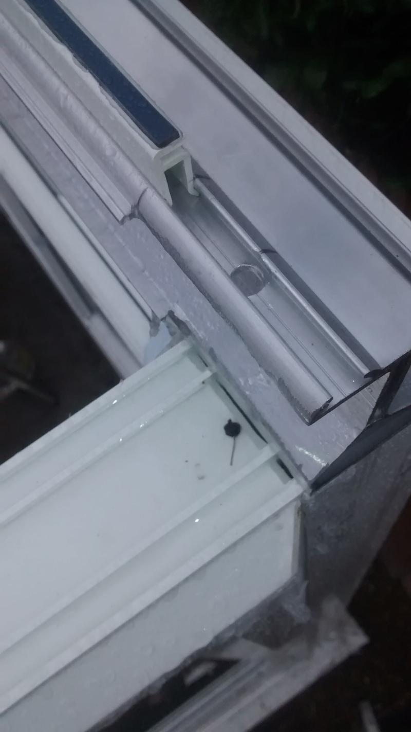

The wall plate is notched big time at one end (the firring box end). They have notched off where the rafter should sit, I have continued my installation as I assume this is normal and maybe its to sit on the firring box. I have just flicked through the manual (sysnseal global 600) and it appears the wall plate should not be notched and the inside of the firring is cut out around it and the out leaf cloaks it.

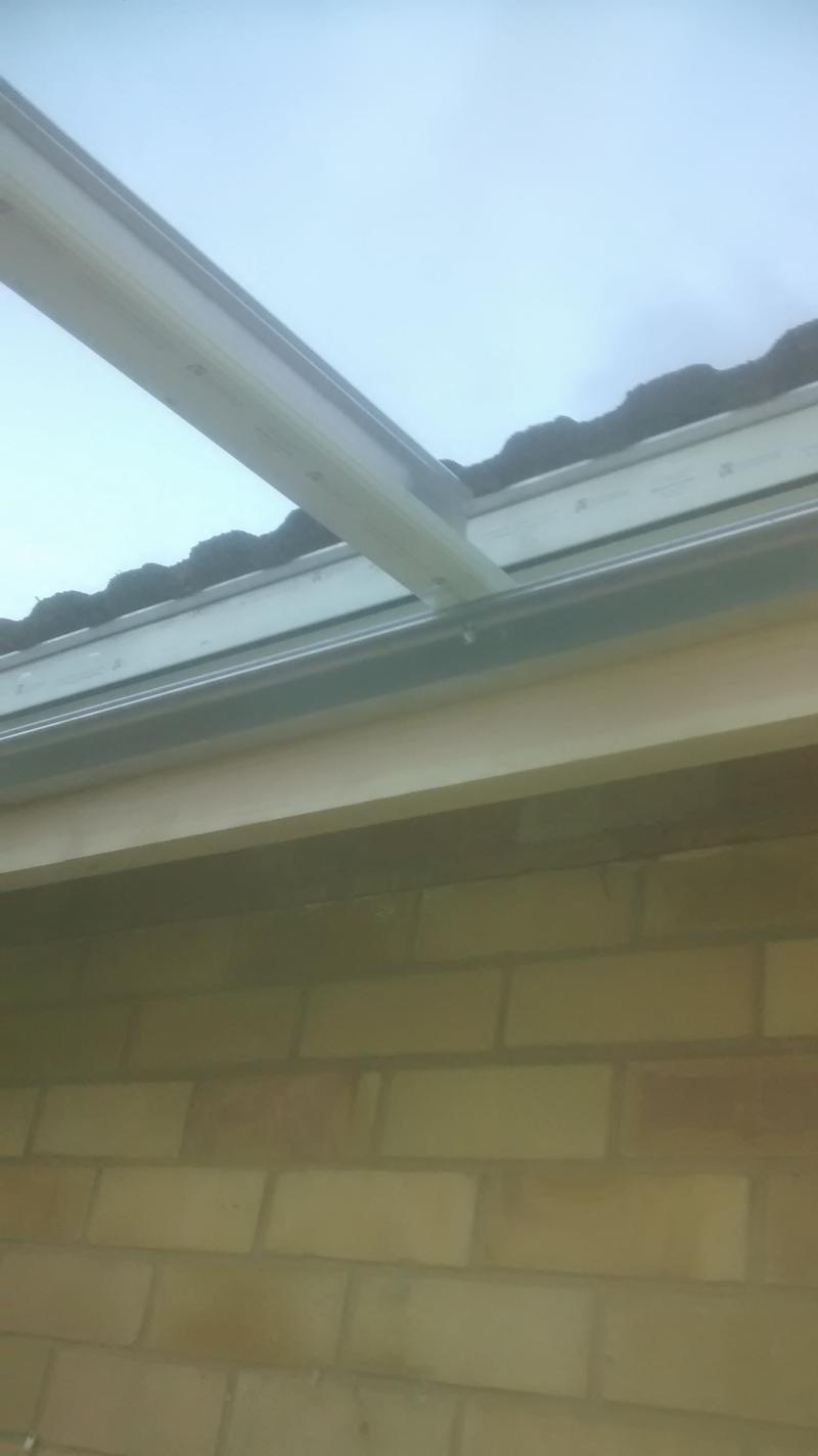

I have never done one of these before, and everything that has been pre-cut/drilled has been spot on so I can only assume this notched wallplate maybe correct and I am stumped, however the more I think about the more I think surely the plate should take the weight of the rafter,glass and snow and not the firring. I have uploaded pics they show wall plate for another rafter drilled fine and also the wall plate notched out leaving the rafter nowhere to sit. The other 2 photos show the eaves beam drilled with rafter in place and the the end for the firring which is slightly notched but leaving the rafter seat and pre drilled to take the rafter.

The furring should be fixed down into the frame, the wall plate should then sit on top, there should be a coupler that goes between the frame and furring, picture not clear but it may already be on.
I take it the furring is only on one side?
The end bar should then be fixed to the wallplate, furring and ring beam
(I think), this should then finish in the same position as the other bars.... Hopefully!
Thanks for the reply. The problem is the end bar has nothing to sit on at the wall plate because the have notched the wall plate. I assume the end bar is not supposed to be supported by the furring and should sit from eaves to wall plate like the rest

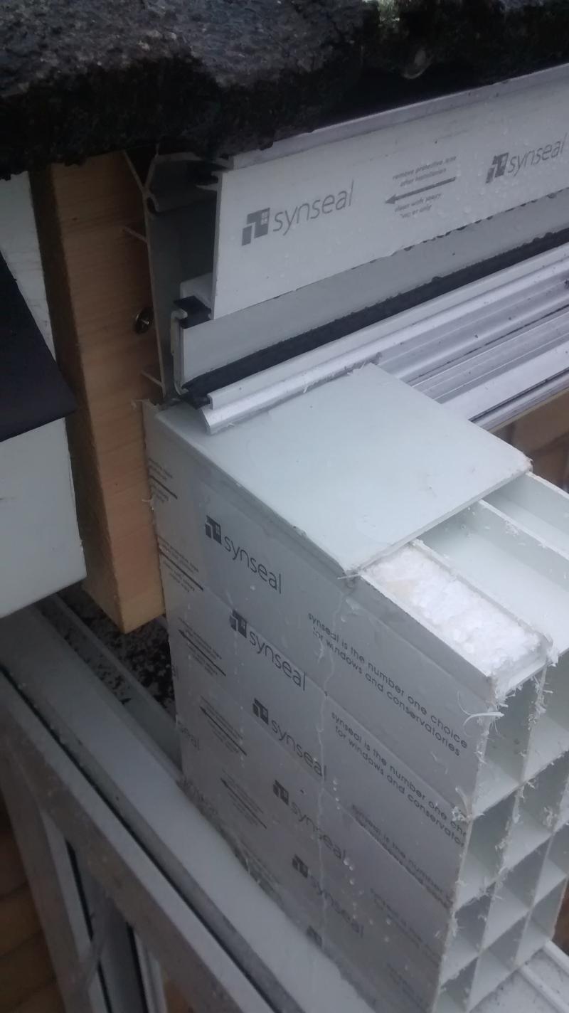

I have taken an off cut of furring and offered it up with the coupler piece on top and as you can see fits lovly, but in the global 600 manual it tells you not to notch the wall plate around the furruing, but to notch the internal leafs of the furring around the wall plate. I have added a picture of the eaves beam aswell to show that this has been predrilled and notched correctly.

eaves beam for end rafter
