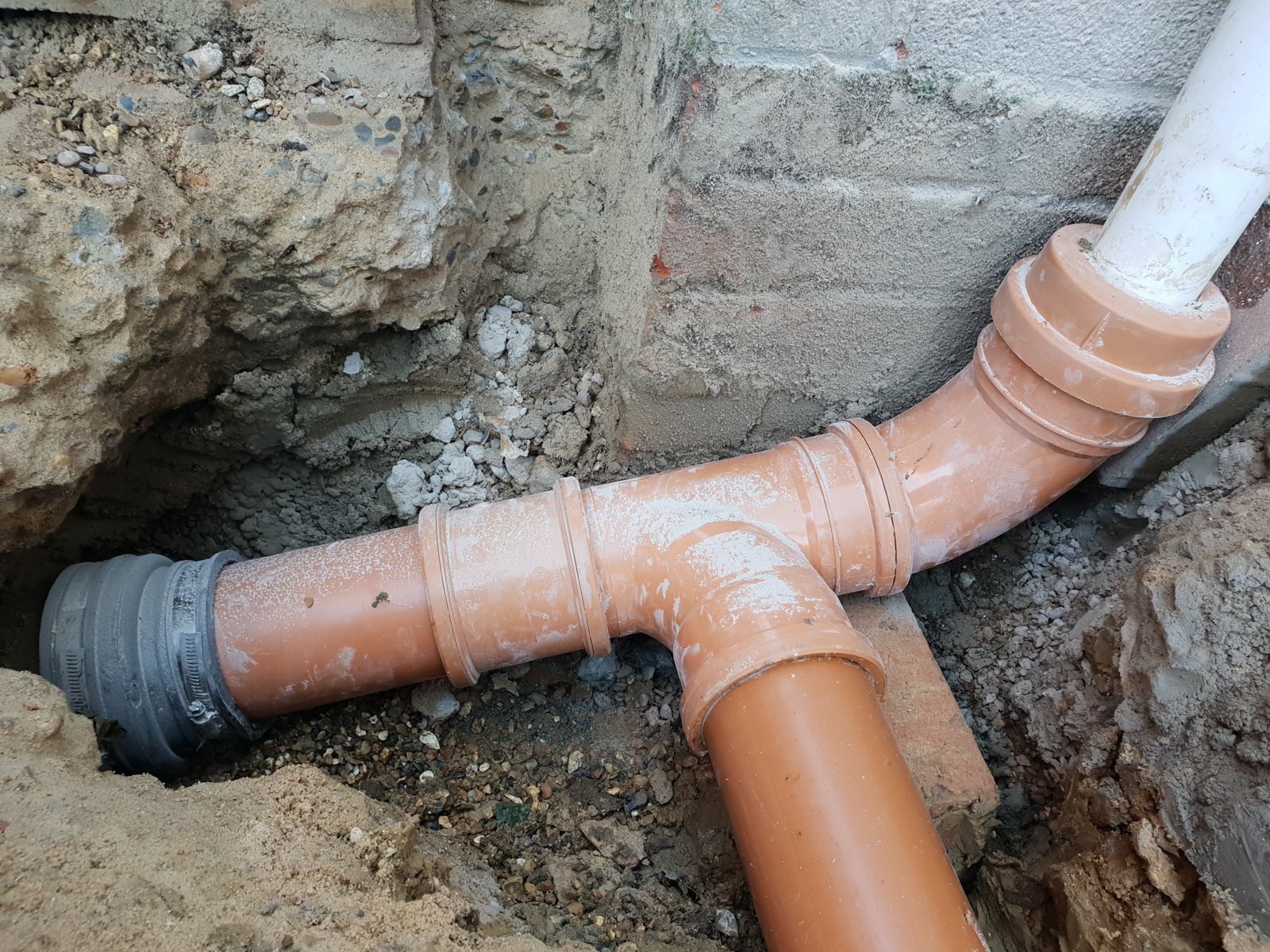

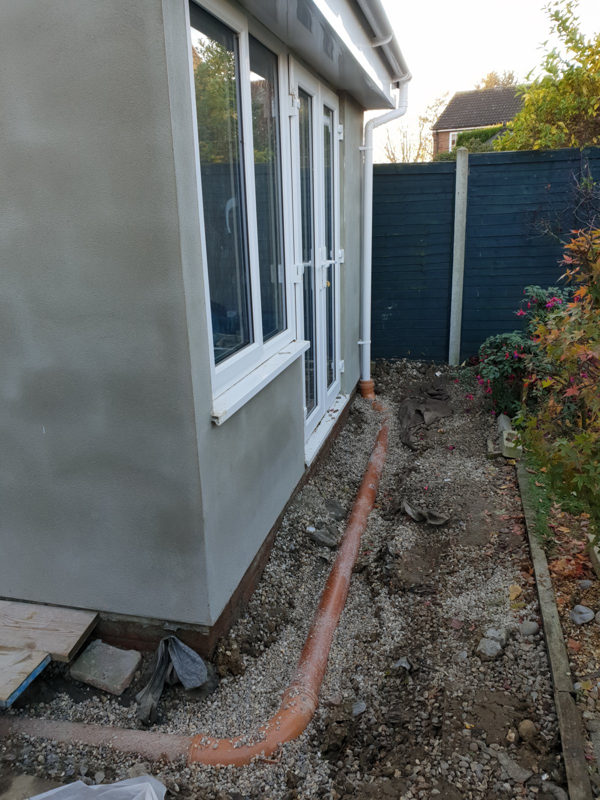

My set up was the same as yours. When I replaced the roof, building control said that the downpipe would either need to be connected to the existing house drainage, or a soakaway. I had to lift some Indian sandstone paving and dig around to the house. Can you remove the planks closest to the house and do what I did?
