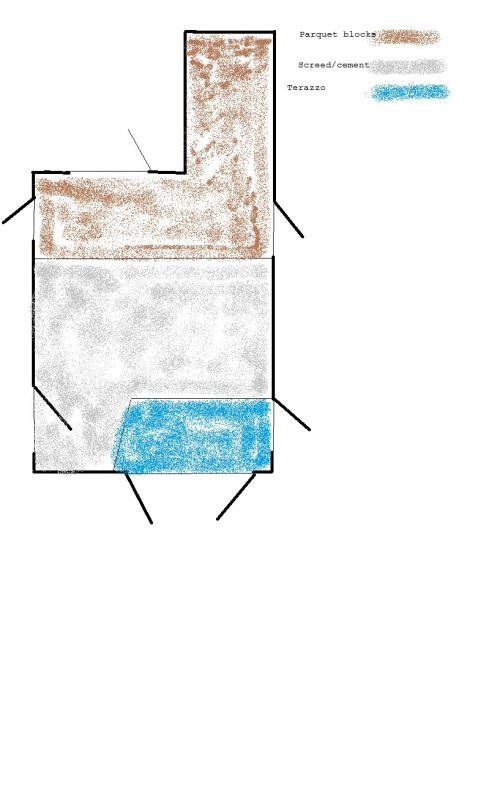

Currently in the process of decorating our hallway, which is about 8 metres long and between 1 and 2.5 metres wide (opens out). As the bungalow has been chopped about over the years, the floor in the hall currently consists of the following surfaces (under the carpet / underlay).
Parquet blocks
Screed/cement surface
Terrazo (old kitchen or entrance way)
Have added a floor plan of the hall to demonstrate the distribution of the 3 surfaces.
There is minor damp at the base of some of the walls.
I was considering laying a DPM sheet over the floor (including parquet blocks) then putting the engineered boards over top.
Or should i rip up the parquet blocks (and terrazo?) and lay a new surface? Reluctant to do this for financial and mostly distruption reasons. Also the floor is reasonably level as it is at the moment.
The board I am considering is 21mm engineered, and is very stable.
Mike
NEVER EVER install a DPM over parquet blocks! This will restrict the natural evaporation of moist in the concrete/blocks and will cause problems in the long run
How about painting a liquid dpm over the concrete and then using a foam (without DPM) underlayment over everything
Thanks. Thought there might be some issue like that.
Selective liquid DPM is a good idea.
There is minor damp at the skirting level near the parquet blocks.. not enough to rot them, but i could put some liquid dpm down there too i guess. I suspect its either rising damp (looong strong not going into it here) or possibly the front door/porch area water ingress.
Selective DPM it is.
Thanks again, nice one.
