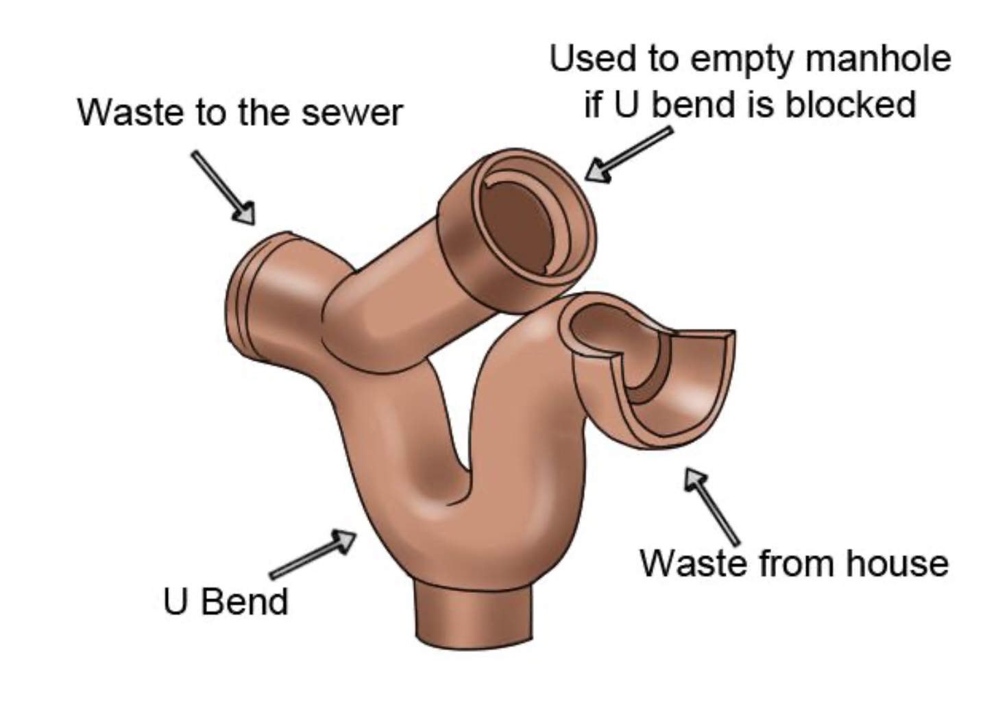

I suspect the main interceptor is blocked, likely the one under the fence ( fence or wall over drain covers should be bridged to allow lifting.)The gurgling is because the end of the kitchen waste pipe is under water due to blockage. When they jet it they are simple washing it out over the overflow in the interceptor while the main drain exit remains blocked, (had this in my last home , end of terrace in a run of four.)
